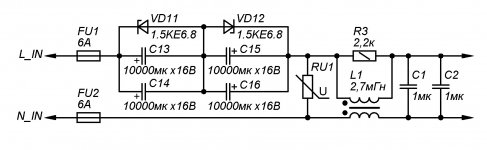

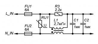

Another very good way to get rid of the power interference is to divide the power supply circuit VAS and output stages. Then VAS, susceptible to interference and low current consumption, will supply clean voltage, and the output stages are almost insensitive to interference. I have suggested this easy way, is a long tradition here with us.
Interference problems from network a little beyond the scope of discussion, but we beat them:
