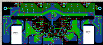

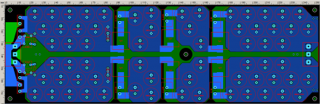

Capacitor Array on Power and Ground planes – How to Avoid Resonance?
