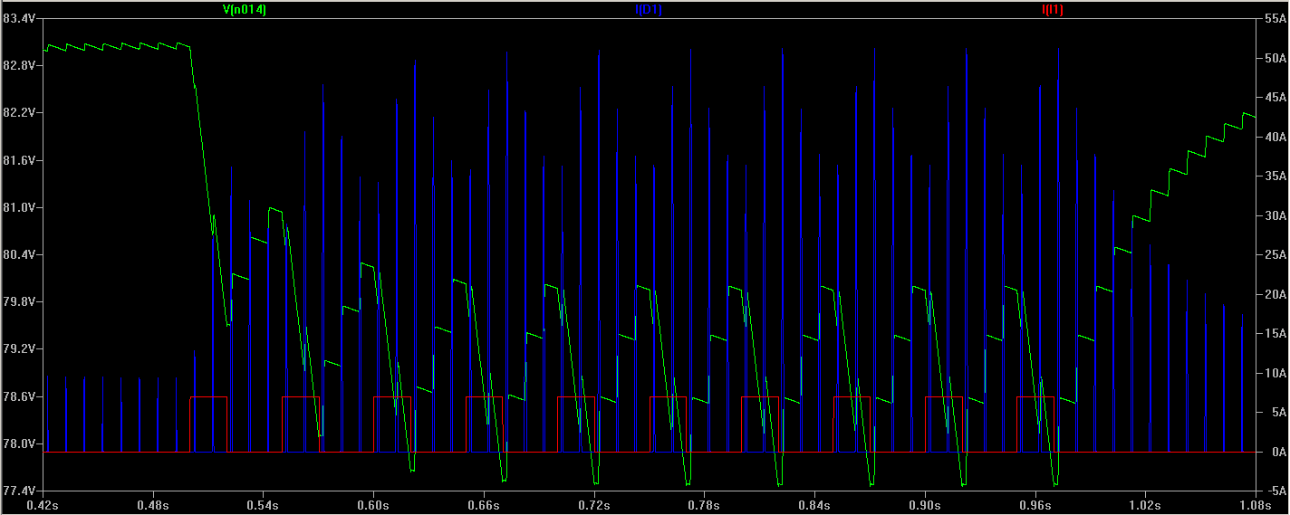

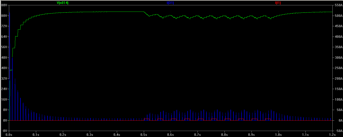

What do you think of this?
I have simulated the power amp PSU with LTSpice.
Green: Rail Voltage
Blue: Current going through rectifier diode
Red: 5A Pulse
The simulation starts from amplifier turning on to 1.2 seconds after turn on. The second image is a "zoom in" of the first. The 5A pulse simulates possibly the worst case scenario when playing music. The intent is to see the power supply ripples under such an extreme condition. It comes in after the rail is settled at 0.5 second and stops after 1 second so that I can observe recovery.
Let me know if the PSU is adequate or not for an average class AB amp. The voltage drop was over 3V. Would you add more capacitance?

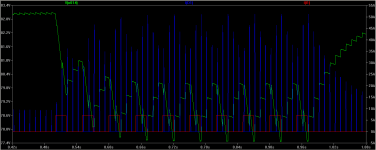

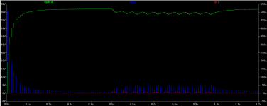

Green: Rail Voltage
Red: 5A Pulse
Correction. In the above I created a 7A pulse, not 5A, to simulate the load.
Other conditions:
Amplifier idle current was assumed 300mA. It was half wave rectification, which means in real life with full wave rectification the diode current would be halved, and I cheated with 100Hz (to simulate full wave rectification) instead of 50Hz. The small r (Andrew's) before the C was assumed 0.1R (probably too low, which means recovery would be worse).
Other conditions:
Assuming you want the behavior of the inductor, then you'd have to test an actual inductor, unless the simulation has the means to fully take into account the behavior of the core material itself.
You want a static load, and to inject HF AC, look at the load side to see the result.
I guess you've moved past that issue to the PS as a whole now?
Regarding the PS of the actual amp as whole?
I guess you'd want to simulate a music signal. There aren't many high rise time squarewaves or pulses generated by the typical sources for music playback. Maybe something like a gated HF sinewave would suffice? But again, I'd look at the actual amp, since in the end you're going to have to do that anyhow.
Looking at your simulation - suggest using full wave in the simulation since you are concerned about the waveform shape not just the absolute values.
Maybe do an FFT on the diode's current waveform (but best to do that with a full wave per the actual supply) and see what that looks like? Might be interesting.
Also, some people like "soft recovery" diodes.
And, then too there are "snubbers" which may be of some benefit.

I don't quite understand why adding more capacitance improved the sound in my last 2 experiments. From simulations, it looks like the capacitance already smooths out all sharp edges. The voltage goes up and down slowly comparing to audio frequencies. I would expect that provided there is no clipping the voltage variations don't affect the sound but in reality they do. Why?
Just for yuks, why not try the simulation with a BIG inductor between the last two sections of filter caps? Wonder what the voltage waveform will end up looking like?
Not to mention the current charging waveform(s).
Big, as in >50mH and as much as 1Hy (it's a simulation, so the parts are cheap!) 😀
No actual idea that is solid, some conjecture.
1) ur PSRR is not really as high as it is on paper
2) more or less capacitance changes the charging current quite a bit
3) there may be more noise from the rectifiers getting through than you think (more capacitance = more charging current = more noise)
4) the transformer may be straining (it's having a hard time with delivering peak current to re-charge the caps
5) look at current, not voltage when deciding what goes up or down
6) some other factor
7) it's placebo effect
8) get a measurement tool and see if you can find it with a straight FFT or a two tone IM measurement - find a difference in the higher harmonics
9) look at the shape of a 1kHz square wave using the actual amp and see if you can find ANY difference in the leading edge or ringing (that's something that can be an indicator)
Remember an amplifier is only a device that controls the power that comes via the power supply, which is then sent to the speaker.
Music signals can't be worse than those pulses I created. So with real music the rail voltage should look much better than my simulation. Apparently adding more capacitance does not change the rail voltage forms at all but only reduce the ripple amplitude. So why it affects the sound so much?
Yes you are right that I have now solved the original problem I had. Thanks a million for you guys helping me to achieve that. My amp now sounds very good. I am asking these questions just to learn more.
