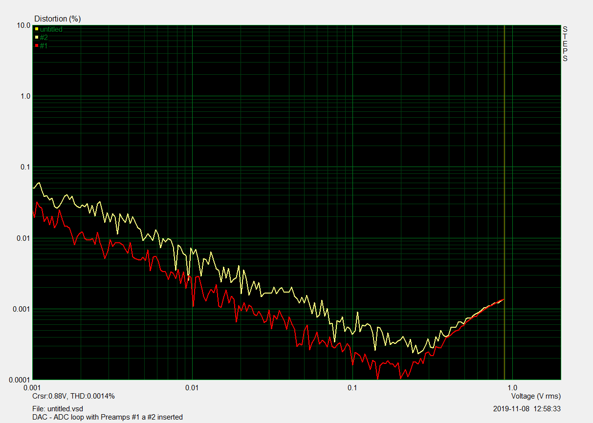

These new files
http://pmacura.cz/claire.zip
not only that they have very different technical quality compared to the vintage 1953 Sinatra WS recordings, but I also changed the DAC for the one that has also balanced output. THD vs. amplitude record of the complete DAC - ADC loop with preamps #1 and #2 inserted is attached, same level settings as used for Claire sample recordings. Now we can see both lower noise and distortion with #1 preamp. Frequency response and rise time remains unchanged.
P.S.: I am proud 🙂D) how well matched are the levels in claire1-3 samples, taking into account that all setting is made only by an analog pot without digital level equalization.
