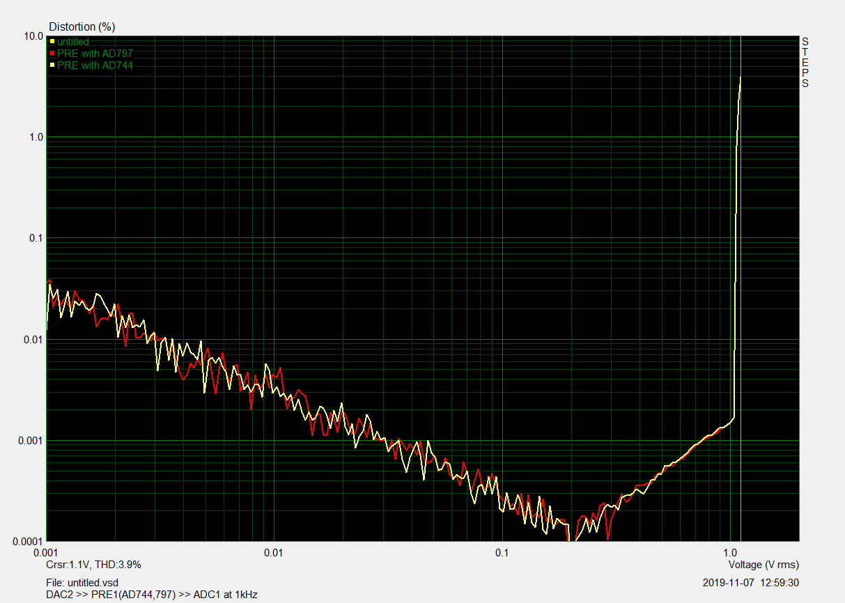

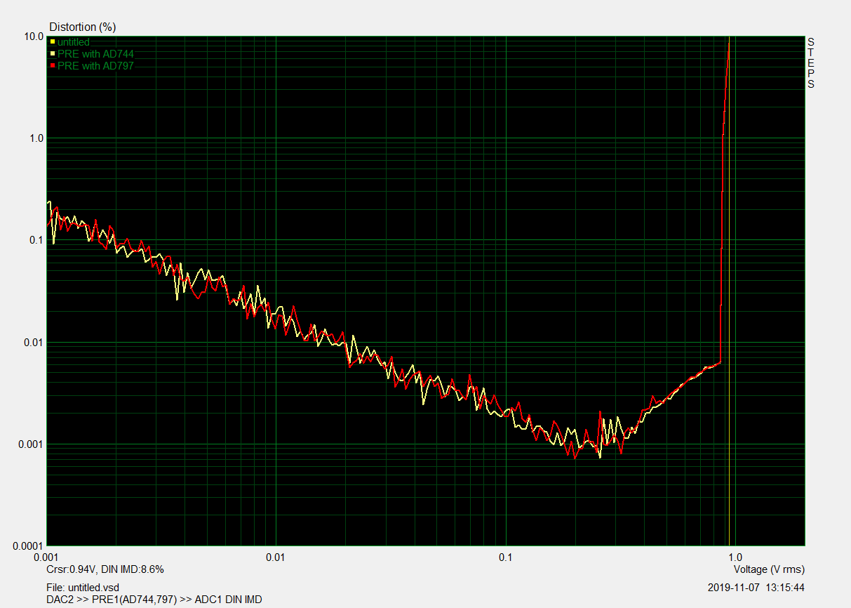

I made a brief set measurement on the tested preamp#1, exchanging AD797 x AD744 opamps. Both are quite different topologies. THD and DIN IMD vs. level was tested. DAC with balanced output was used to better fit to the preamp input. Switching between AD797 and 744 makes no difference in this set of measurements, as the are determined by DAC/ADC parameters. No THD/IMD "hump" is present.

Did you use the same input DC bias as is present on the opamps in cases where a hump is observed?
It's +1.65v on the I/V stage and +1.65v on the differential-summing/balanced-MFB-filter stage.

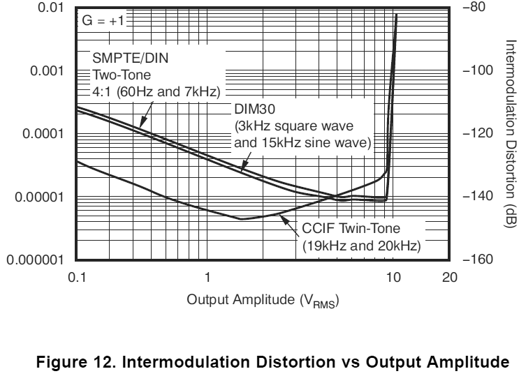

IMD of LME49990 showed similar jagged line on the datasheet itself, albeit at a much lower level.

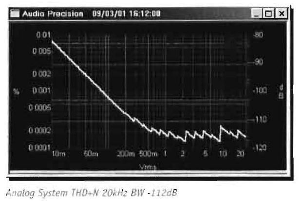

That jagged line is auto range-switching of the test set. Nothing to do with the DUT.
Jan

Don't be so dismissive to unverified measurement. IMD of LME49990 showed similar jagged line on the datasheet itself, albeit at a much lower level.
You are clearly not aware of range switching in test equipment...
Yes, you see it very often. Actually it is a sort of indicator, saying that you are measuring close to the test set residual.
Here's an old AP testing itself ;-)

I think that Scott Wurcer has completely disproved the suspicion of AD797 responsibility to ESS "IMD hump" in this post:

I guess not every manufacturer use IMD tester that TI (Burr Brown) use. Kind of misleading to those not that familiar with that kind of signature though, even Pavel did not show suspicion of range switching artefacts.
This is Cabot measurement and distortion comparison. Nothing in common with the suggested "IMD hump", which is a bow like rise of non-linearity somewhere at mid levels, returning to low values again. Some parts just get progressively less linear at high/higher amplitudes for many reasons. Not necessarily for the reason of switching distortion. Do you think that the AP does not use opamps? Really, the suspicion of AD797 hump was funny and yes, I got irritated a bit. There are still not many parts, if any, to beat AD797 parameters in audio band. Hats off, Scott.
