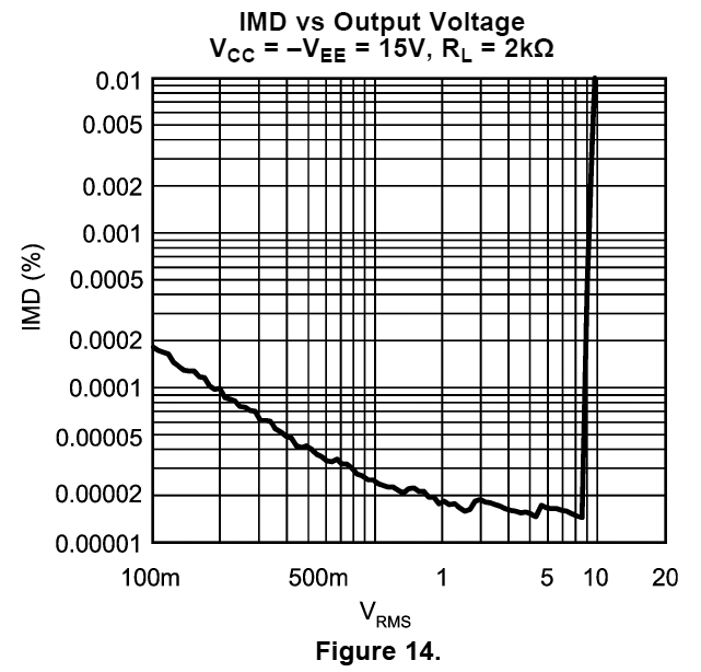

However slight, the IMD hump and the low output bias of the AD797 issues add a couple of footnotes to the conclusion. Perhaps a worthwhile investigation for another time. 🙂

AD797 is loaded with 10 kohm here. Would you kindly post a link to a trusted test that shows the "IMD hump"? Not mere comments of forum members, please, and no DAC application. Can it be seen in Samuel Groner's AD797 detailed measurement?
Does that also take feedback resistor loading into account? If so then it has to supply 0.1mA for 1V peak, 20% of bias. How would it sound with > 40k loading? Could be interesting but not that much for immediate attention.AD797 is loaded with 10 kohm here.
These ok? Not sure about trusted.Would you kindly post a link to a trusted test that shows the "IMD hump"?
https://www.audiosciencereview.com/forum/index.php?attachments/topping-dx7s-dac-intermodulation-distortion-measurements-png.10829/
https://www.audiosciencereview.com/forum/index.php?attachments/1546492665323-png.19807/

OPA1611/1612 was mentioned as a fix to the hump issue, similar noise performance and higher output bias at half the price.
I do not know any published IMD measurement of AD797 by Samuel Groner. Sorry.Can it be seen in Samuel Groner's AD797 detailed measurement?

If you want for me to take your comments on AD797 serious, please read Samuel Groner's detailed AD797 measurement first
http://www.nanovolt.ch/resources/ic_opamps/pdf/opamp_distortion.pdf
and compare it to other opamps. Look at loading conditions.
The opamp is a part of stand-alone preamp in my test, not of a DAC.
Which IMD you want for me to check? 60Hz+7kHz, 250Hz+8kHz, 19+20kHz?
I find DAC IMD hump irrelevant and most of your comment based on audiophile beliefs, not on trusted and verified sources and measurements.
You are kidding right? AFAIK that file shows no IMD measurement on AD797.If you want for me to take your comments on AD797 serious, please read Samuel Groner's detailed AD797 measurement first
I have no wish for you to do any more measurement on my count. Op amps are mildly interesting for me anyway, not much of a difference in sonic to spend a lot of effort.
Don't be so dismissive to unverified measurement. IMD of LME49990 showed similar jagged line on the datasheet itself, albeit at a much lower level.
