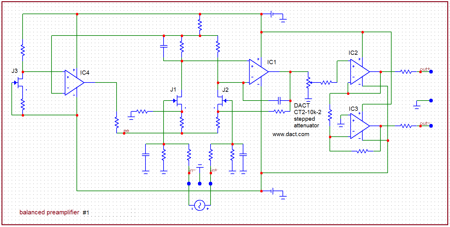

For the new music samples, claire1-2-3, the same preamps were used as for worldstring1 and 2. Specifically, the preamp#1 used for worldstring1 was also used for claire1, and the preamp#2 used for worldstring2 was used for claire3. As I already mentioned, another DAC was used for claire samples. It has both balanced and SE outputs so it can fit to preamp#1 balanced input properly.
The new “mod” of preamp#1 was used to record claire2 sample.
On preamps
claire1 was recorded through preamp#1 with: J1, J2 = 2SK170BL, IC1 = AD797, IC2 = ADA4898
claire2 was recorded through preamp#1 with: J1, J2 = 2SK170BL, IC1 = AD744, IC2 = ADA4898

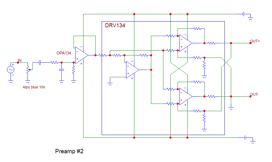

claire3 was recorded through pream#2
Basic schematics of preamp#1 and #2 are attached. Their specs and measurements were posted in

Because in claire samples preamp#1 was driven from DAC balanced output, also the distortion fell below that of preamp#2 as shown in the further link,
Can you hear a difference between 2 solid state preamps?
so now preamp#1 was better in all technical parameters than preamp#2, especially in noise level lower more than 10dB and almost 10x higher -3dB roll off and 10x faster rise time. Technically, best parameters has claire1, claire2 is slightly worse and claire3 is clearly worst.

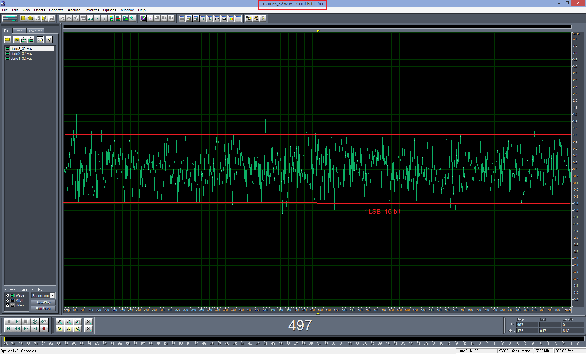

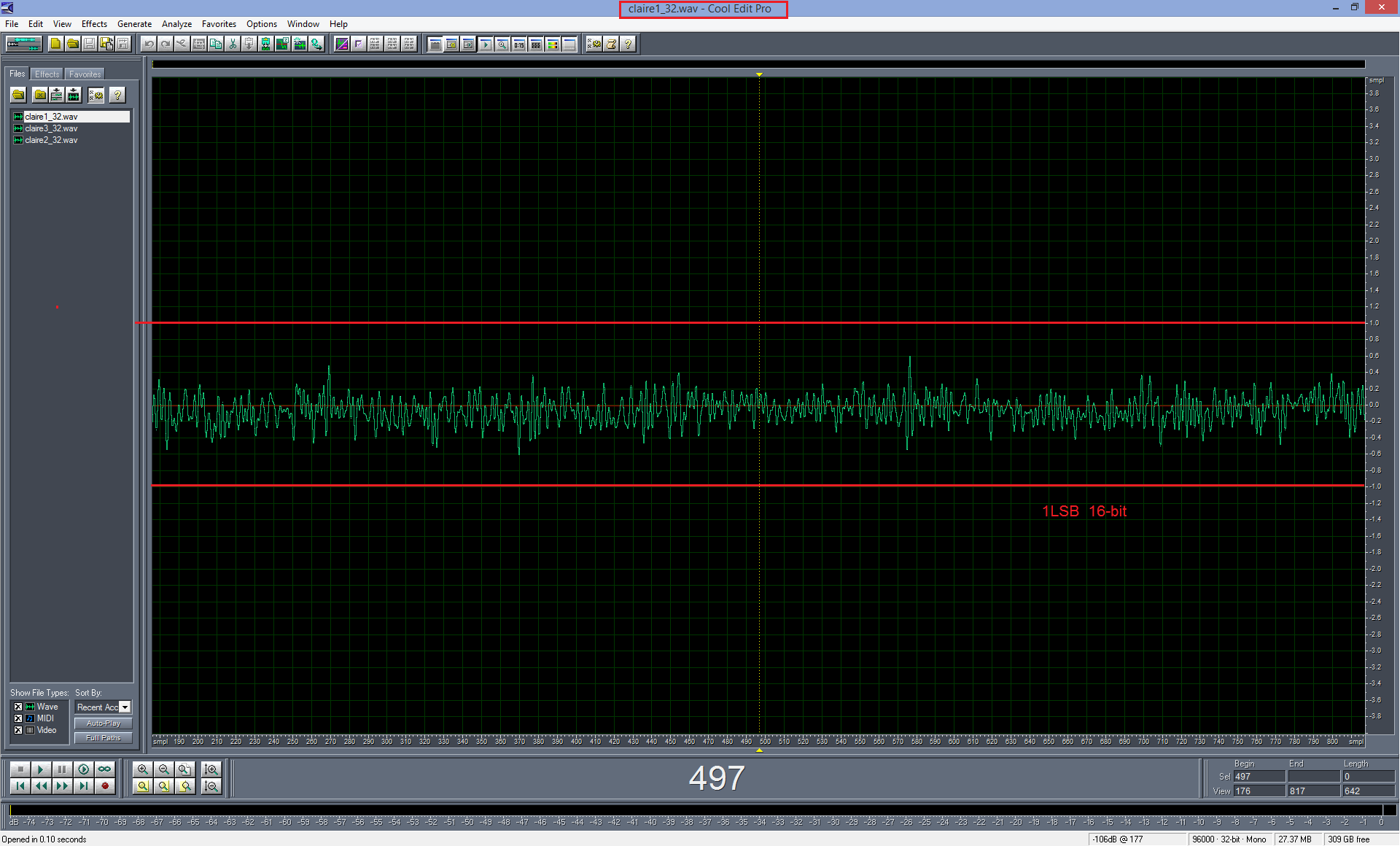

Difference in noise is the biggest difference in the audio band, between preamps #1 and #2. This can be seen in CE plots showing first samples of claire#1-#3 recordings, before the music starts, containing only loop+preamp noise. Claire#1 and #2 are well below 16-bit LSB CD format limit, claire#3 is just at the limit or slightly higher. This is also seen in the first (low level) samples with music.
