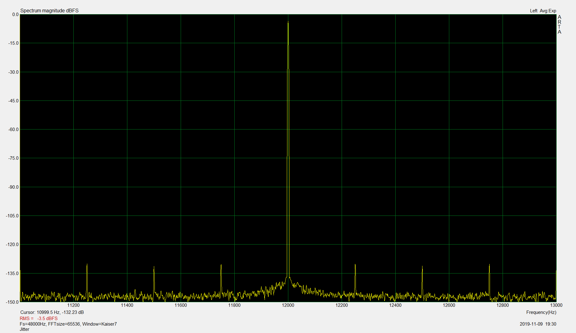

How might the A/D converter I use affect what you hear?
How would you hear the effects of ultra low jitter if your jitter is much higher?
How would the dynamics sound if your system sounds flat?
What if one recording is 0.1dB louder than the other, how will that affect what you hear?
The idea that you could accurately hear the difference between two very low distortion systems when played back on a much higher distortion system seems unlikely. At a minimum there would be a lot of masking by your system to hear through. Maybe you could hear some tiny difference, but you still wouldn't know what ultra-low distortion sounds like, how could you?
Jitter:
