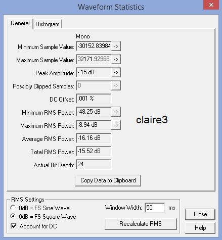

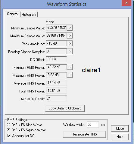

I just would like to mention that there is much much lower difference in level between claire1,2,3 music samples and I am attaching the statistics.

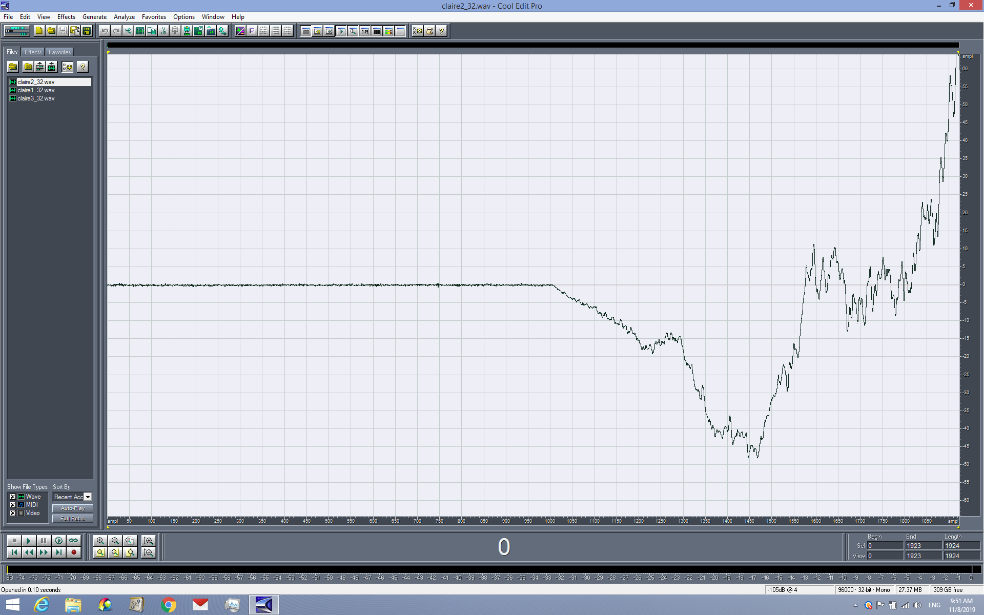

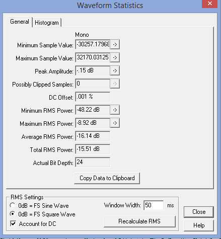

Technically, the biggest difference between C#1-#3 samples, in audio band, is the lowest level background noise. Due to linear transfer function differences, there are also sample value-at-one-time differences apparent after direct file subtraction. What do we hear, in fact? Do we really hear it, are they some reproducing chain imperfections, or is it a plain psychoacoustics? Open mind would ask itself all these questions.

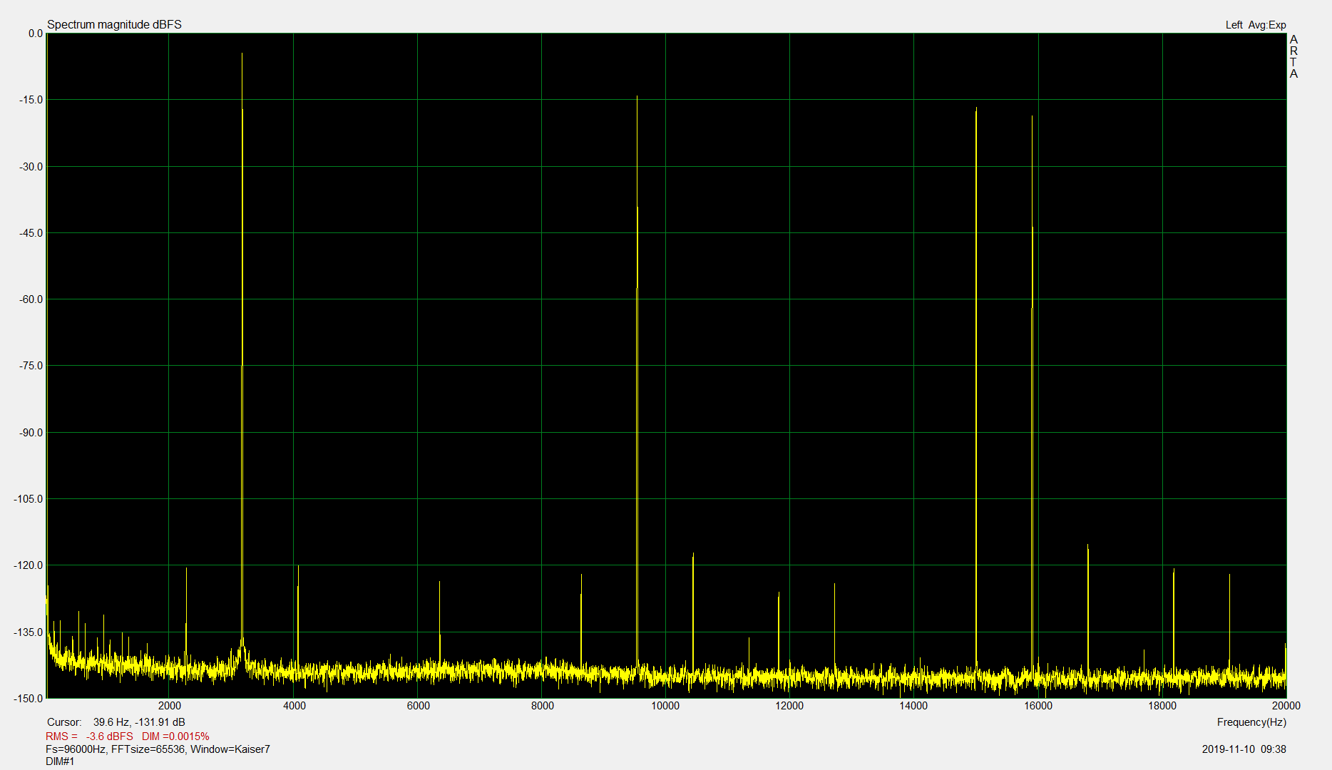

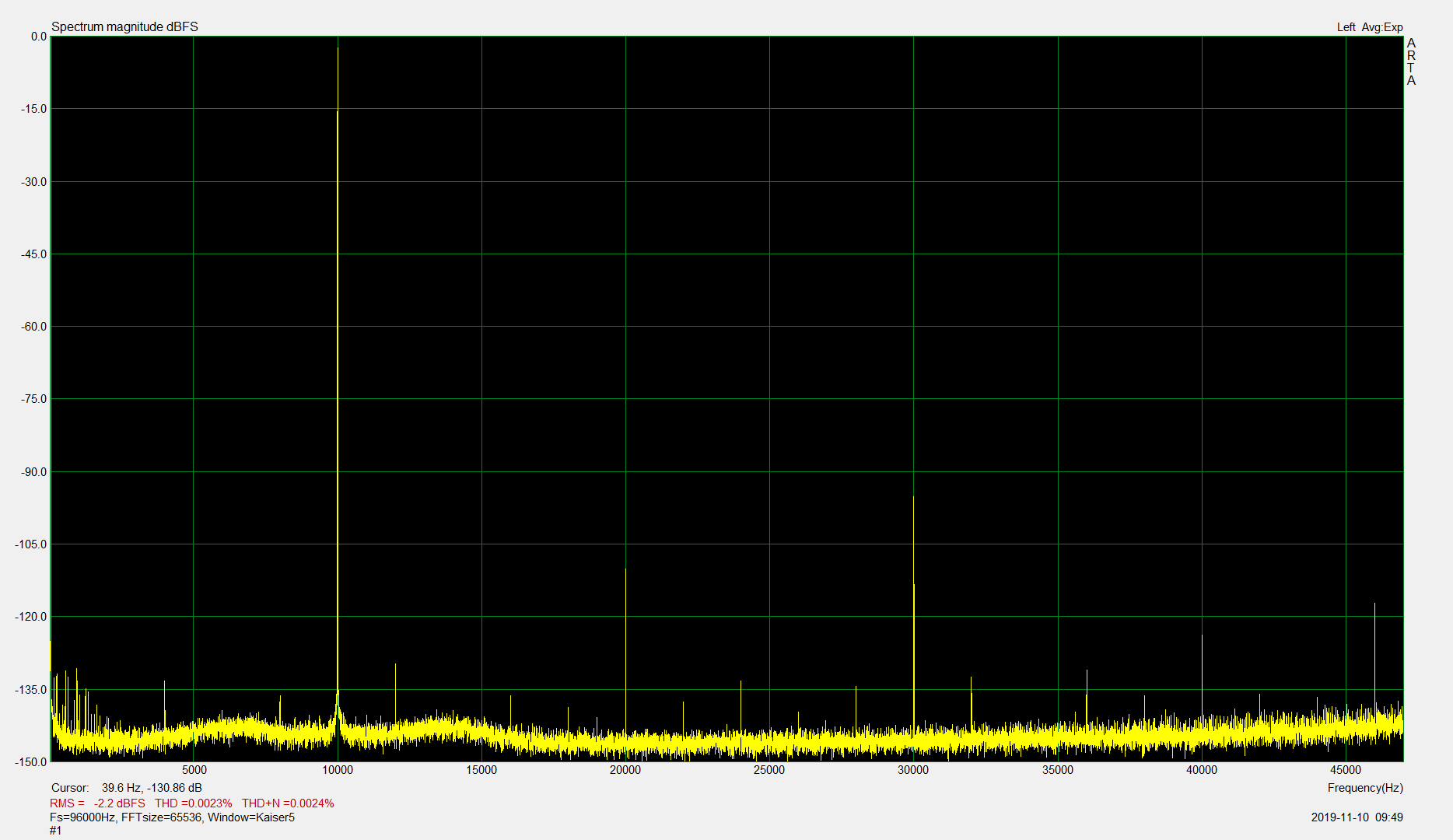

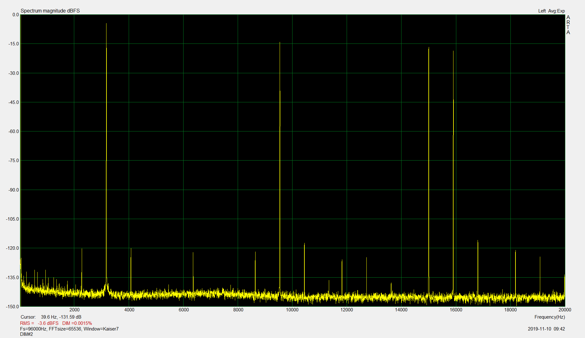

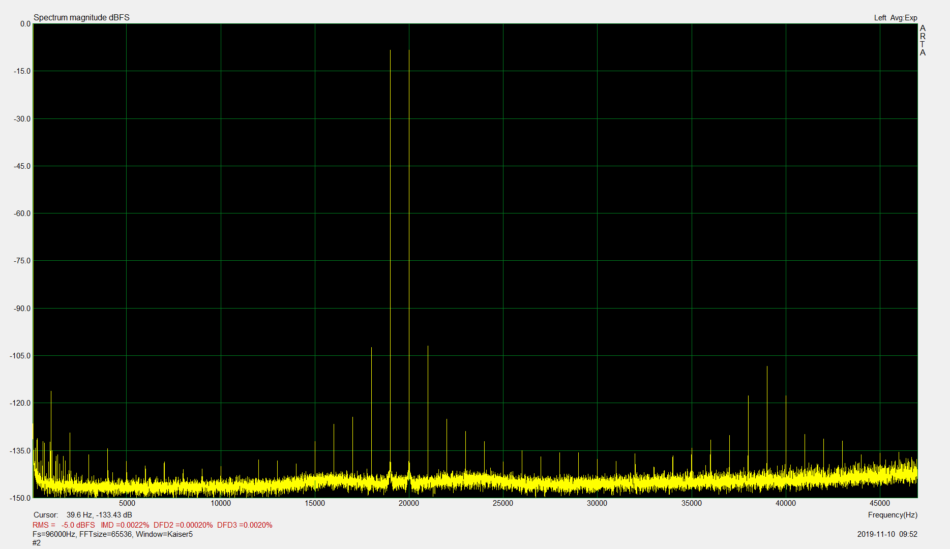

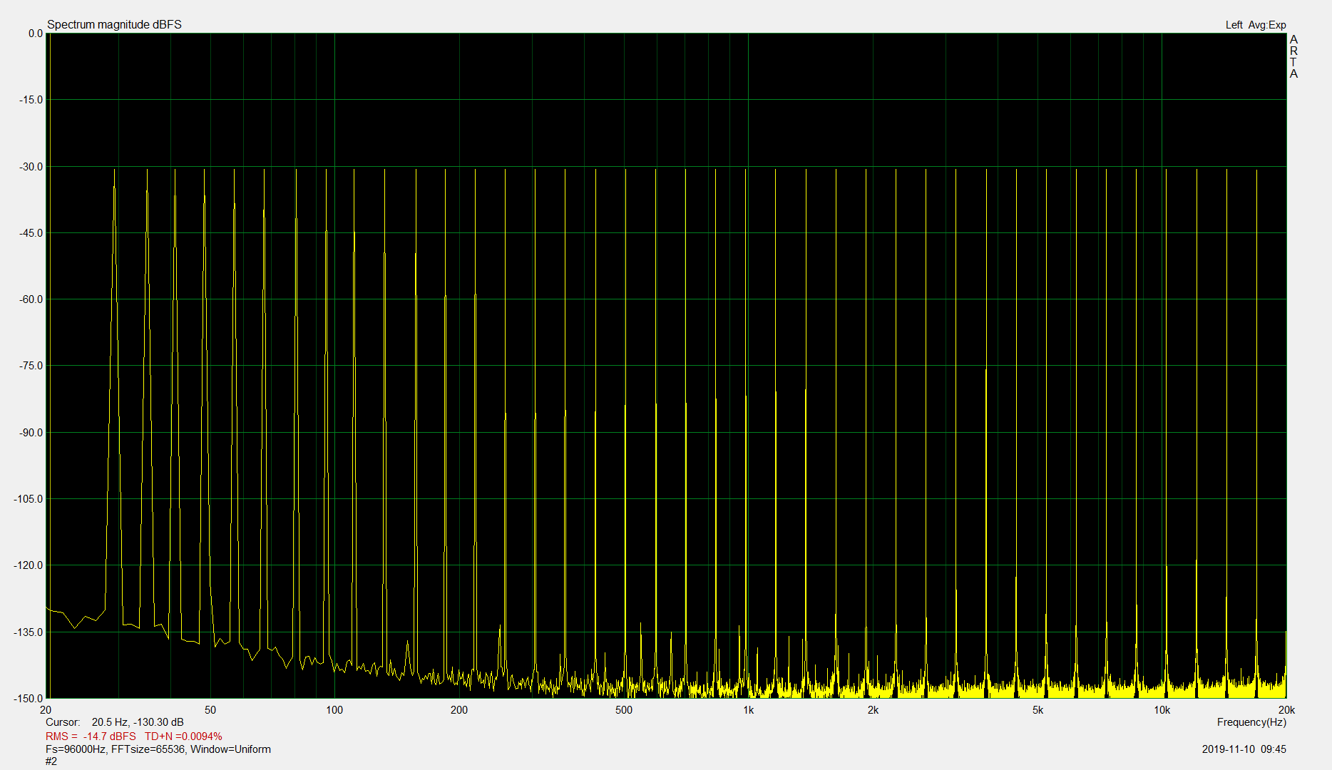

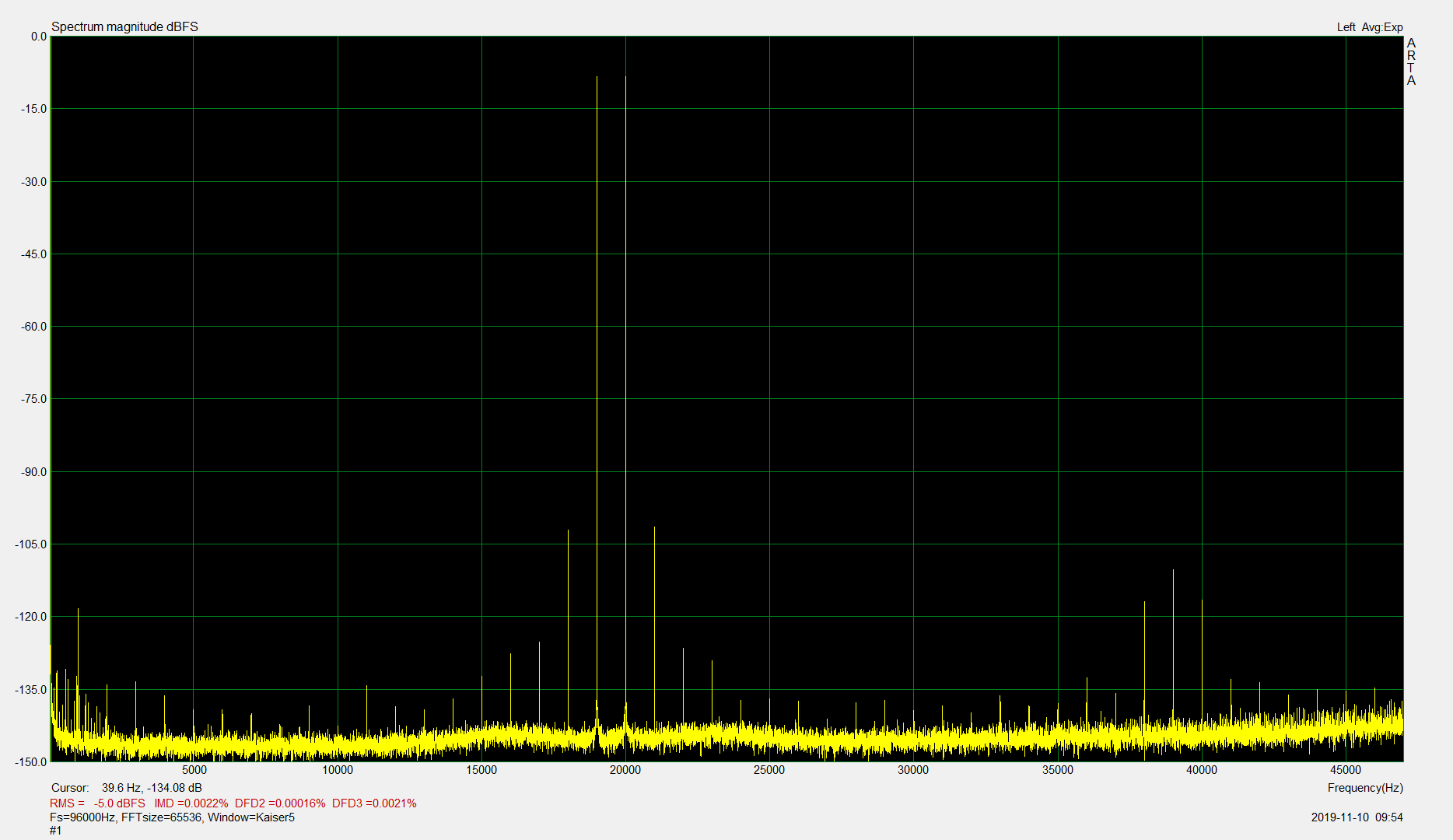

Please find some comparisons between complete claire #1 and #2 path (#3 not used as there is much bigger difference) - DIM, multi, 10k and CCIF in big hires images. Level close to FS or few dB below. Low level plots make no difference.

Thank you Pavel, your measurements are always illuminating and helpful.
