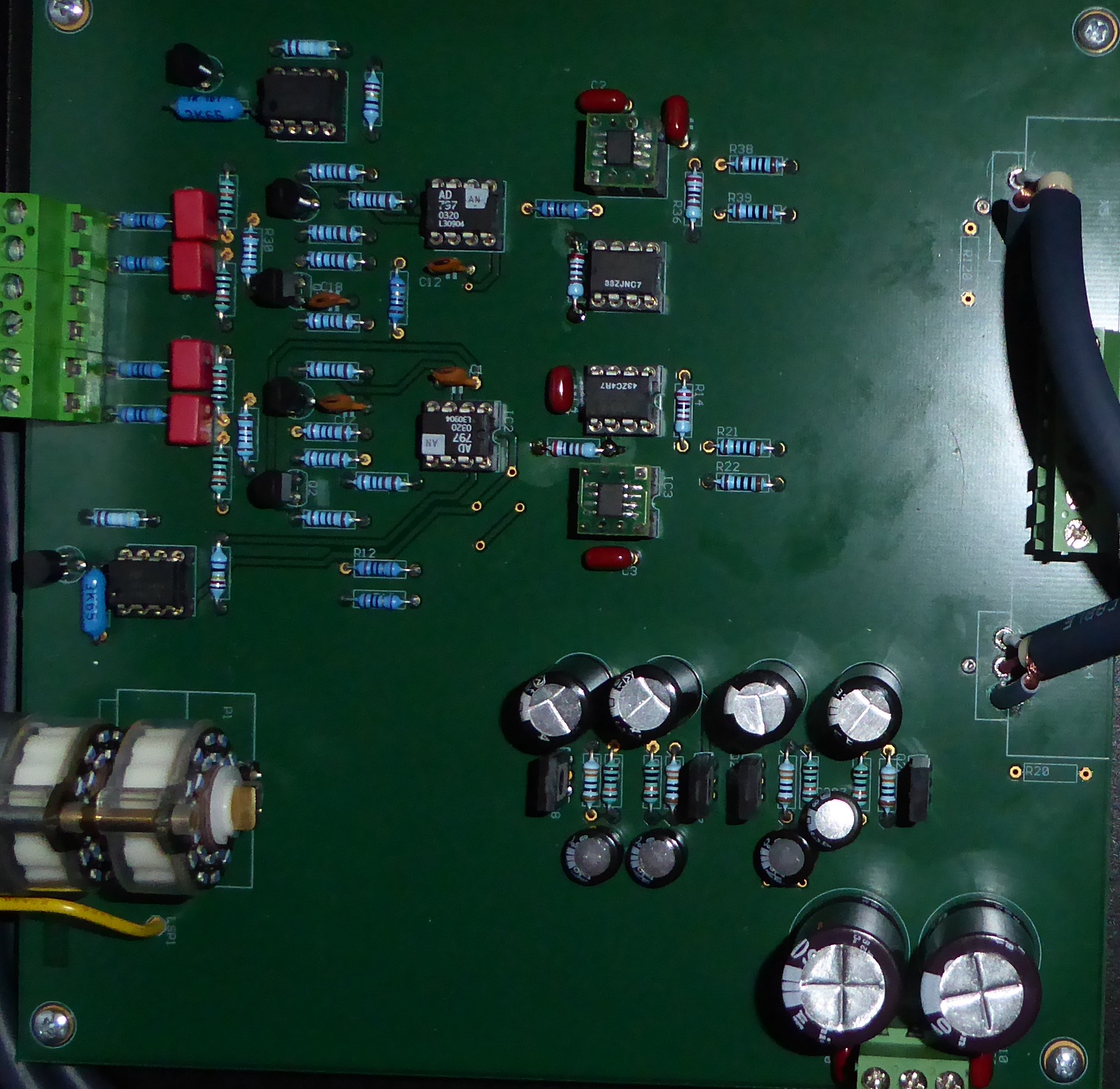

After some researches:
claire1 was recorded through preamp#1 with: J1, J2 = 2SK170BL, IC1 = AD797, IC2 = ADA4898
claire2 was recorded through preamp#1 with: J1, J2 = 2SK170BL, IC1 = AD744, IC2 = ADA4898
claire3 was recorded through pream#2

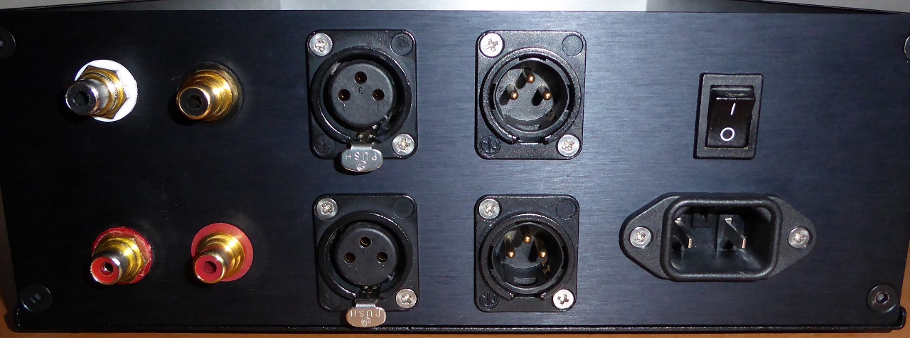

Bob, it was never meant as a project for sale and it is rather an instrument than an audio component 🙂. However, it is possible to have some view about the layout and difficulty - I think it is not difficult at all. It uses both through hole and SMD opamp chips, that means that the PCB is not optimized. It was built in 2014 and several opamps were tested at different circuit positions. I am not taking more excuses and I am attaching some photos of the thing. I have no budget calculation but I do have a BOM of PCB components. The most expensive part would be the stepped attenuator
DACT audio attenuators
BTW, has anybody noticed that PRE#1 has a stepped attenuator and PRE#2 has blue Alps? I do not think this is a minor difference and it was mentioned in the simplified schematics posted.
