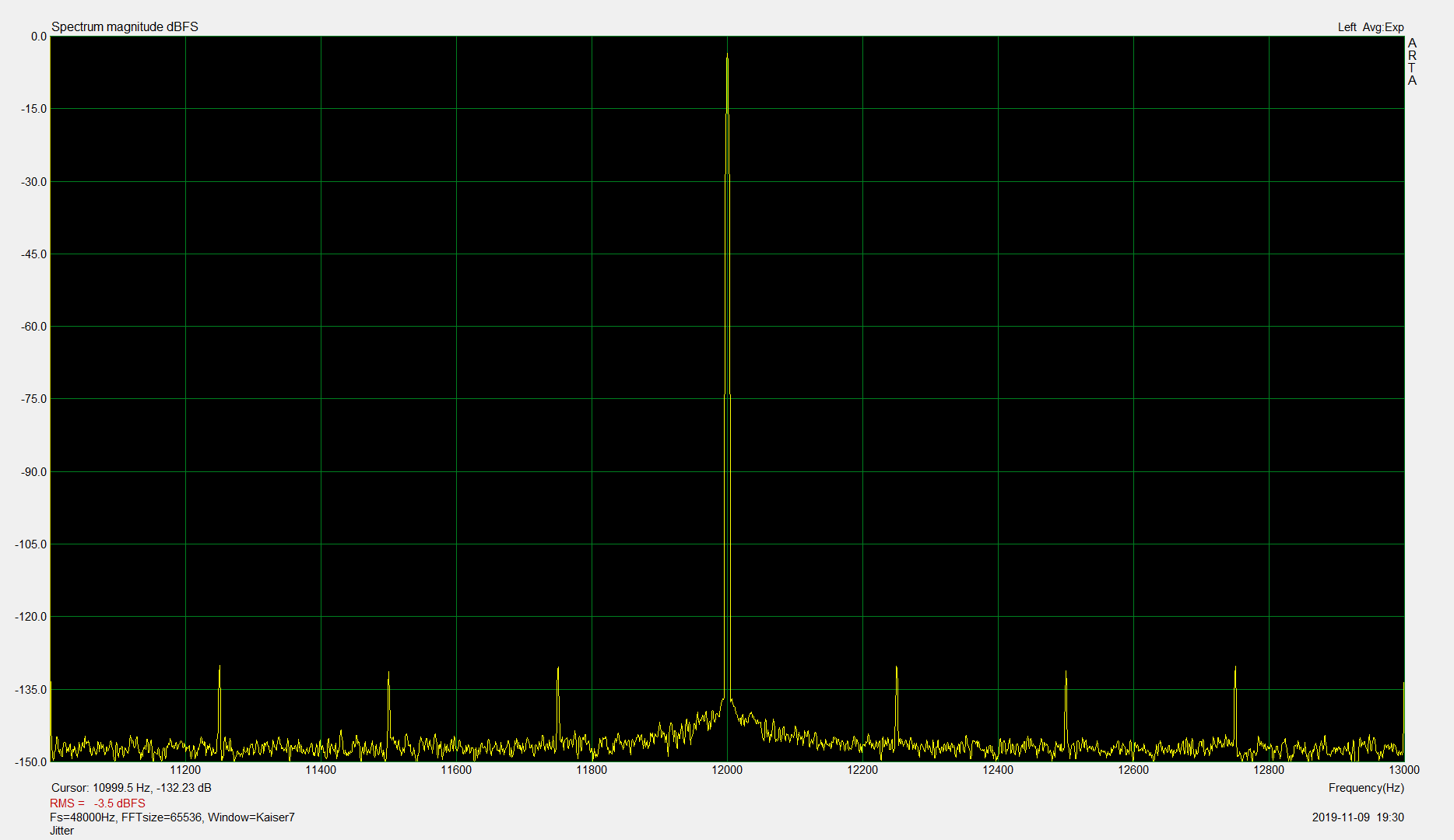

I'm talking about jitter I can hear that you might have trouble measuring. Phase noise in the range of 1Hz to 10Hz offset can be audible. Doesn't have to be deterministic enough to show up on a time averaged FFT.

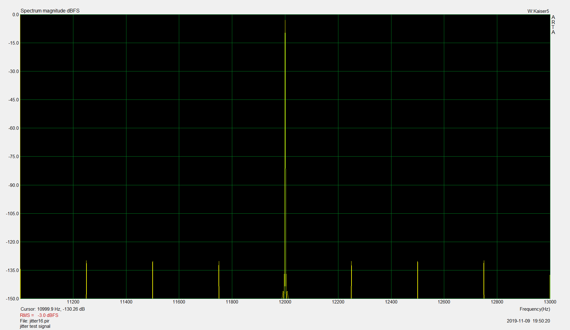

Uh - huh. I was showing a jitter when I use DAC and ADC 2 different boxes with their own circuitry. Once again, now with jitter test signal shown. Oh and yes, preamp#1 is in the loop.
Exp averaging pushes down and hides that close-in noise quite a bit, looks like.

Loop DAC--ADC timed from same clock does not introduce jitter.
Well, it prevents slip/overrun but is not a safeguard against jitter.
It helps a lot to some soundcards with poor jitter rejection because of simultaneous sampling. It is not much important in this test, where I have shown standard Dunn test signal measurement of the DAC/ADC used.
