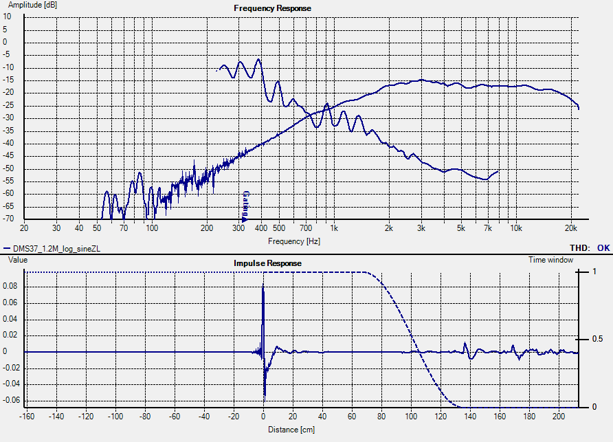

Oh and I wasn't thinking the tweeter should be able to pull off 900Hz, was just a bit shocked as to how high the distortion was at that frequency, which made me realise the importance of what you have been saying! 🙂
Attached is a measurement of the tweeter I did on the weekend, its a morel DMS37 by the way.
Tony.

Interesting stuff. I presume the talk of slopes and points for the tweeter is to reduce (basically) low frequency content getting in.(?)

Umm ... on further consideration, looking at those curves you measured, the midrange looks hopeless. Reminds me of the last time I measured Fostex drivers, or a car-radio 6x9 elliptical. The multiple resonances are beyond the scope of equalization. Maybe the ripples are really caused by diffraction, so try putting lots of felt around the mid. Is it mounted in a hole or something? They really need to be flush with the front panel to minimize diffraction.
The curves for the tweeter look OK to me. Very typical. Very minor elevated region around 3 kHz, and I would deal with that - it will cause an impression of forwardness that isn't flattering to most recordings. If you had an acceptable midrange, I'd set the crossover at 4 kHz (electrically) and let the little peak take it down to 3~3.5 kHz (acoustically). Old crossover trick - make the small peaks part of the crossover slope. The driver is trying to tell you to cross it over at 3~3.5 kHz (acoustically).
On a trial basis, I'd borrow an active crossover and a spare amplifier and do some listening. Frankly, given the atrocious measurements of the midrange, I have no idea where I would put the crossover. If you are wedded to these drivers, I'd turn the frequency knob and listen for the best overall sound. What you'll hear as you (very slowly) turn the knob will be an interesting variety of midrange colorations - you get to choose which set you like best.
Good point; the distortion measurements are certainly cause for concern, in that event, since they are very high. It certainly looks like this tweeter wants a crossover between 3.2 and 4 kHz, and a fairly steep slope if possible. The suggestion to try an active crossover still applies, since that will quickly give a go/no-go quality indication about the tweeter. If that's too awkward, I would try an electrical 3rd-order highpass at 4 kHz (with an additional notch filter at tweeter Fs if necessary) and see how it sounds.
I agree with 5th element that midrange measurements (without crossover) would be illuminating. I have a feeling that this tweeter and midrange just don't work together (a very common event in the speaker biz).
Hi Guys, yes that is only the tweeter, the second curve is the THD of the tweeter!
I'll post the mid response this evening, it's on my home computer. The mid's are MW144's. They are very flat to 1Khz (nearfield) but have a prominent hump between 1 and 2 khz. a post with an old measurement of the MW144's is here --> http://www.diyaudio.com/forums/mult...m-projects-long-first-post-4.html#post2163637
Note that I think I have the measurements more sorted now but in trying to find some decent measurements in posts I've made, I discovered something a bit disturbing... my vifa m26WR-09-08's exhibit very similar response anomalies to the MW-144's This seems a bit odd considering its a 10" vs a 5" and VERY different baffle geometry.... Despite having tried many different things with my measurements (and getting pretty consistent results) perhaps there is something inherently wrong with them...
Tony.

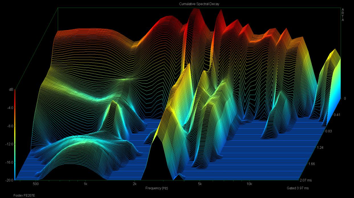

Well-chosen drivers in the 5~7" range can make it to 3~5 kHz, but not much above that. Whizzer cones buy more extension at the cost of a very rough mechanical crossover and nearly total breakup in the working range of the whizzer cone. (The Altec Biflex was a better solution for a mechanical crossover.)
I'm not sure that I would tar all whizzer cones with the same brush. Conical whizzer cones typically do have severe breakup modes but I would argue a really well designed curvilinear whizzer cone can be orders of magnitude better when it comes to resonances and cone breakup, to the point where it's not really an issue.

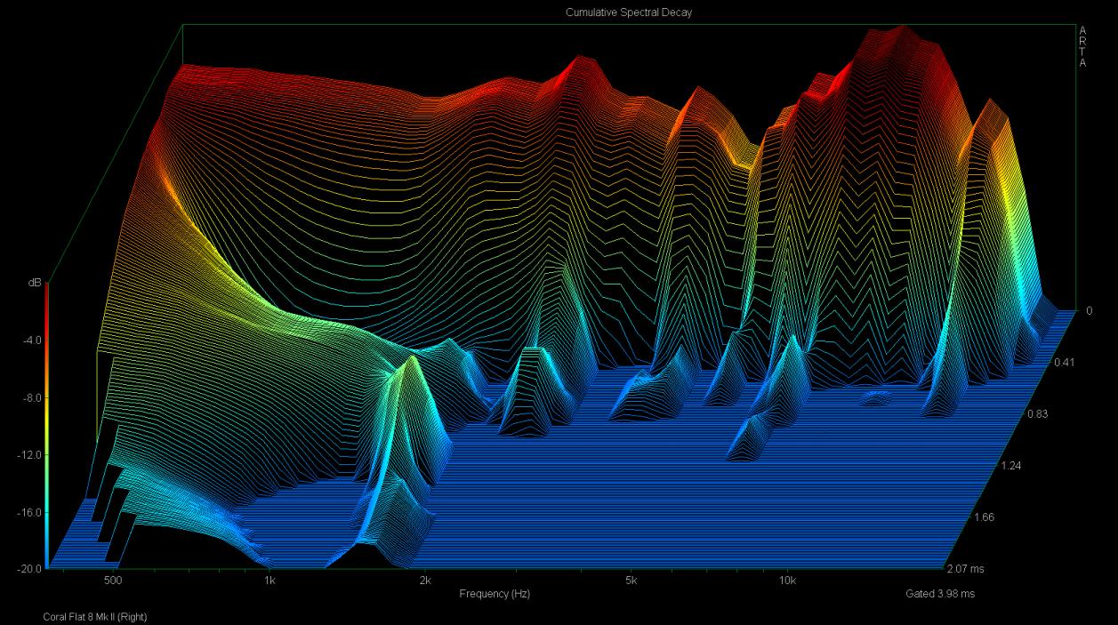

I recently measured the CSD of a couple of my 8" full range whizzer cone drivers to illustrate the point in another discussion thread over in the full range section.
The first one is the Fostex FE207E - a well known but recently discontinued driver with a 60mm conical whizzer cone. The whizzer cone resonance at 2.6Khz couldn't be more obvious - at 2ms (1.6ms after impulse stop) it's only down 8dB. In fact it takes nearly 4ms to decay 20dB when viewed on an expanded time scale. Can't be corrected in any meaningful way in the network. Sounds terrible too. 😛
The second is a Coral Flat 8 with an 80mm curvilinear whizzer cone. The fundamental whizzer cone resonance at 2.2Khz is so minor that it's decayed 20dB in 0.6ms. As it's a nice symmetrical minimum phase mechanical resonance, with the right RLC resonance compensator in the network it can actually be more or less eliminated completely, both the frequency response bump and the CSD decay tail. Most of the remaining breakup below 10Khz is actually from the outer 1/3 of the main cone (which is conical with three ribs near the outside) with very little from the whizzer. Surprisingly good showing from an 8" dual cone driver I think and it certainly sounds good, especially with the two bumps at 2Khz and 4Khz (whizzer and main cone respectively) compensated for in the network.
True, it's exceptionally hard to design a really good whizzer cone driver that is clean and relatively flat, but given the discussion about how hard it is to make a really good tweeter that performs well low in frequency, and how hard it is to design a midrange driver that goes high enough, cleanly enough, and without severe beaming and breakup, I think there is still a bit of life left in the approach, especially if modern design and measurement techniques were put to work on the problem, instead of the largely trial and error approach of a few decades ago...
What I'd like to see is a driver where the main cone was curvilinear as well as the whizzer... On the Flat 8, nearly all the flaws in the response from 2Khz-10Khz stem from onset of breakup in the main cone not the whizzer, so there is still a lot of room for improvement if the main cone were better damped and more rolled off at high frequencies. (At the moment the main cone, as measured on a de-whizzered driver extends to about 7-8Khz all by itself before rolling off at ~12dB/oct, which is too high)
