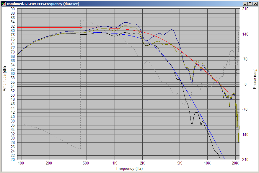

Hi Simon, I've never had any luck trying to get CSD plots. I do have impulse measurements of the original crossover and the current so I could possibly import them into something to do CSD plots.
The woofer has some breakup around 6.5K and some more at higher frequencies but it is a long way down db wise.
I think that Lynn's premise was that if the slope is too shallow (at too low a frequency) that too much bass energy gets to the tweeter which then causes excessive distortion, I guess that this could be causing modulation of the dome which causes some odd IM type distortion. This was what I suspect was happening.
Attached graph shows dark blue, raw response of midwoofers. green response with 12db/octave rolloff (basically just notch filters) and black, the response with the 24db / octave rolloff. Similar notch filters but with added 2nd order electrical filter.
Tony.
Tony.
