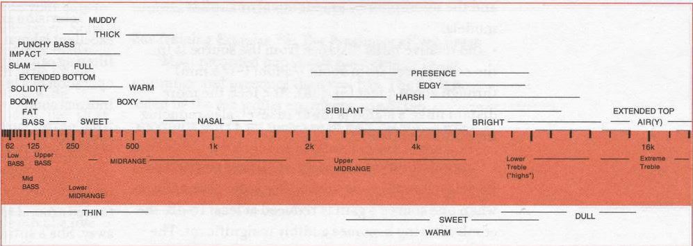

I fought for a long time with sibilants, I had no experience with measurements and I could not establish the cause of the problem with certainty, so I investigated following a path, comparing the listening sensation and the measurement from the listening point, I have a diary where I write down ** the listening sensations for each song and for each modification made.
I have a list of recordings each of which pwrmette to listen to different acoustic varibe instruments and recording techniques.
every time I make a change I re-listen to it through my preset list to check if the change is only an equalization that improves a poor recording and gets worse with another good recording, or it is a change that adds quality improves the resolution to all the recordings .
the verification is a long and delicate step to be repeated several times and continued for days even at different times and without haste.
for each listening of the same song I write / add to the previous notes the sensation, the modification only when the judgment of the listening sensation is confirmed after many plays on different days only after this process which lasts not less than 10 days or even more if I have doubts .
** the memory of a sensation is not reliable, the quality and quantity of certain perceived attributes last only a few seconds, after which you can easily deceive yourself unwittingly even on your own.
the graph that I add I don't remember where I got it but it corresponds to my experience, from the measurements I had a hump of some db at 3000 Hz.
by only attenuating the hump at 3000Hz the sibilants have attenuated a lot, I still haven't completely resolved but there are few recordings where I feel the defect that could be a recording defect and many recordings sound splendid.
attenuating frequencies above 7000 Hz the sound loses resolution and tends to be opaque.
the general trend of the frequency response is also important.
if I attenuate only from 7000Hz onwards the sibilant is even more evident and more annoying.

Sibilance is usually due to elevated region between approx 7 and 9 khz. Alot of full range drivers suffer from this.
SB tweeters nearly always have a dip here so guess the designers build it in

from my very limited experience, I find it still too much sibilant when this area is flat in the axis...
I don't know though if it's apply to ESLs where the spl loss with the distance seems not apply like with dynamic drivers ?
Listening position or room curves should generally trend down. If you have a planar or line array, you want to balance tone to the listening position just as you would with a dynamic speaker, you just might need to do a little more shaping on the top end.
