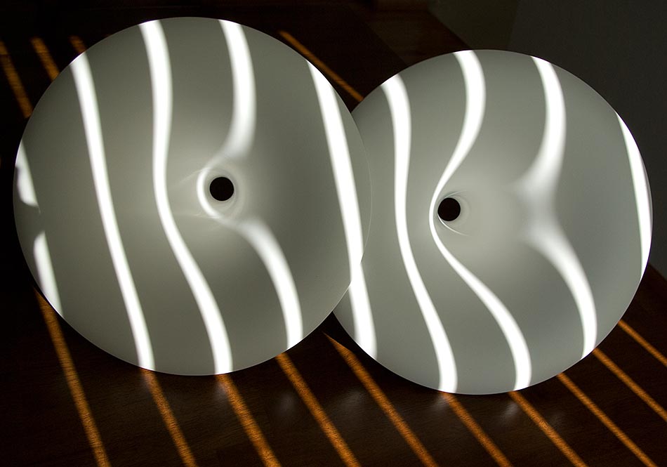

The Beyond the Ariel project continues. The Azurahorn AH425 has turned out very well, and delivers very flat response with the Altec/GPA 288 and the Radian 745P 1.4" (large-format) compression drivers.
I am collaborating with a colleague in Texas on a complementary bass unit. We're taking a dual-track approach. The first approach is a hybrid front-horn with a vented box - Bjorn Kolbrek is doing the simulations on this one. The second approach, which will be suitable for smaller rooms, is a dual 15" woofer using Altec/GPA 416-16's (or similar, like the AE TD15M's) in resistive-vented cabinets.
If we can't get satisfactory performance from the more complex hybrid front-horn, the simpler resistive-vented box with dual 15" drivers should be a reasonable fallback - it will also be smaller and more suitable for smaller rooms. Planet10 has given me good suggestions for the starting point for the resistive-vented enclosures for the Altec/GPA 416's.
The AH425, as used with the Altec/GPA 288, Radian 745P, or the Yamaha 6688 (as used by Martin Seddon of Azurahorn), does not need equalization. Constant directivity was never a goal, but constant power loading on the diaphragm was - and the real system follows Bjorn's BEM simulations very closely. The polar pattern is free of sharp edges or fingering patterns, and mimics a direct-radiator in terms of a smooth and gentle off-axis falloff. Diffraction appears to be low, based on the frequency response, impulse response, and freedom from sharp cutoffs in the polar pattern. (Diffraction typically causes in ripples in all three domains.)
A 2nd, 3rd, or 4th-order (electrical) crossover anywhere from 630 to 800 Hz is suitable, since the system response is ripple-free right down to the 425 Hz horn cutoff. The 2.88" aluminum diaphragm has the first breakup around 10 kHz, as expected, but continues out to 15 kHz. The differences between the 288 and the Radian come down to the different suspension of the diaphragm and the different phase plugs. The AH425 has become part of Bjorn's and Martin's personal systems, with BK using his vintage Altec 288C's, and Martin his Yamaha 6688's (measurements are shown on the Azurahorn website).
