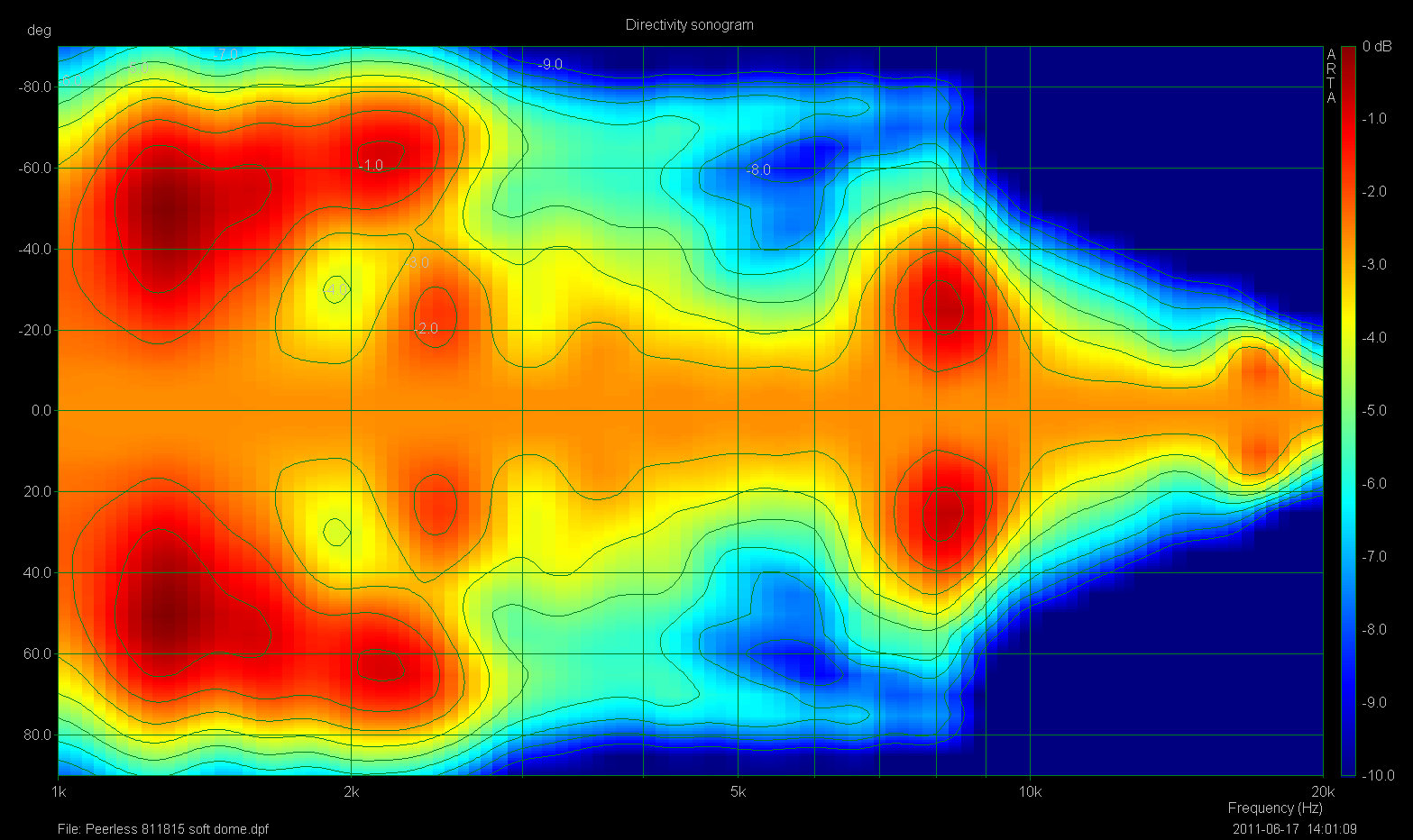

I look at ur plot of ur tweeter and I see it narrowing with frequency.
Vertical and horizontal.
In the vertical plane it's narrowing smoothly and gradually with frequency yes. In this plane the dispersion at the top end is set by the length of the ribbon, but at the low frequency end (down to about 2Khz) the waveguide takes control and restricts the excessive increase in dispersion that would otherwise occur.
In other words its more directional at the bottom end of it's range with the waveguide than if the ribbon was just suspended without any form of waveguide, thus reducing the total shift in directivity index with frequency. (If you by necessity have narrow dispersion at high frequencies, controlling the dispersion at low frequencies to reduce DI shift is a good thing)
In the horizontal plane the directivity is relatively constant. Yes it starts to narrow above 10Khz, but less than a typical dome, with directivity maintained down to about 2Khz.
It's probably helpful if I post a couple of other tweeters so you have something to directly compare against with the same scales and measurement setup.
The first is a Peerless 811815 fabric dome. A fairly typical dome tweeter, nothing fancy. Compare that to the horizontal response of the ribbon and tell me which one is narrowing more with frequency... in fact it's all over the place. Below 3Khz it's almost +/- 90 degrees (eg the angle of the baffle) while at the treble end above 10Khz it's narrower than the horizontal ribbon response. Total DI shift is far greater than the horizontal response of the ribbon.
As well as that there's a surprising amount of on axis cancellation, especially below 3Khz, as well as around 8Khz. On these graphs anywhere where you see orange along the middle and dark red above and below is an indication that the off axis response is greater than the on-axis response, which is never a good thing in a driver and shows poor directivity control. (Another way of looking at it is the response is not falling off monotonically as you go off axis) The off axis response is up to 3dB greater than on axis in many frequency regions. (Very obvious in polar plots too, although I wont bother posting those)
There is a small amount of this in the horizontal plane at 5.5Khz on the ribbon but it's quite minor in the order of 1dB and that's the only place it occurs, certainly not nothing below 3Khz, and nothing in the vertical plane, where it falls off monotonically.

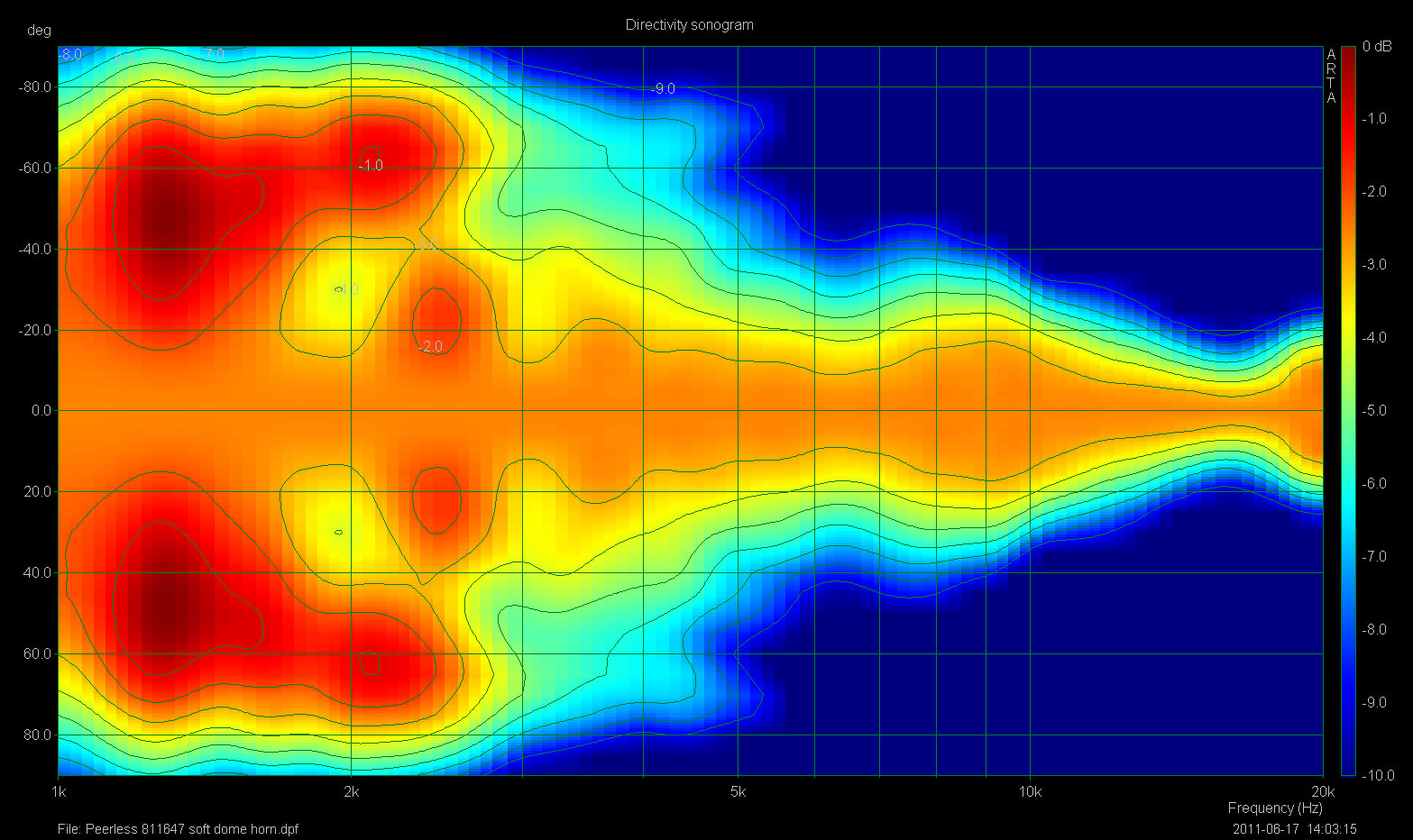

The second driver I measured is a Peerless 811647 - an interesting second comparison because it's basically the same dome driver as the first one, but with a horn on the front instead of a nearly flat face plate. It's not a big horn, only about 40mm deep, but it is a horn profile rather than a waveguide profile.
If you compare the second graph you'll see that below about 4Khz the horn does absolutely nothing for directivity control - all the off-axis response increases at the bottom end are the same. This is an example of a horn doing nothing for directivity control when it's too short for the frequencies...All it's done to the directivity is to make the top end narrower, a lot narrower than the ribbon horizontally, and almost as narrow as the vertical response of the ribbon.
The polar responses of both those drivers are a mess IMO, (but quite typical) they're just not good drivers, and both have sibilance problems which is one reason I never used them in a project. I'll post the frequency response and CSD of them in another post because interestingly enough, both of them have a poor decay response right smack in the sibilance region, and it might help to get me back on topic
I think if you study the graphs I attached, you'll see that a horn that's too short does nothing for low frequency directivity control, but a waveguide can.Afaik, it followed the Romagna design, which was integrated with a cast exponential horn (as seen in the Decca version in your link) which again was intended to permit the ribbon to be used lower in frequency, not for dispersion control.

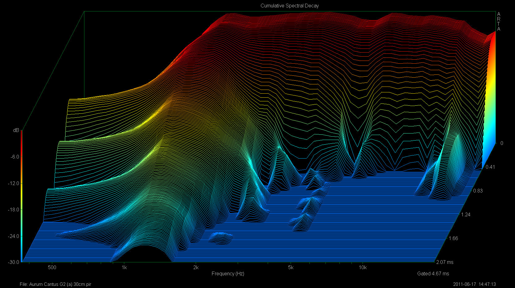

Here are the CSD plots of the three tweeters up against each other, and a bit of analysis.
I've remeasured the ribbon since posting the previous CSD so all 3 were measured in the exact same test environment. I also lowered the cut-off level to -30dB to better show low level resonances. (I can't go much lower than this without room noise from the measurement computer showing up)
The first is the ribbon - a tweeter I consider to have no problems with sibilance, and plenty of "sparkle". Not a perfect CSD by any means, but 5-10Khz is pretty clean. (Maybe a slight cavity resonance at 15Khz - hard to tell if this is really there or not as I know my mic has a peak in that region that will interact with the speakers response)

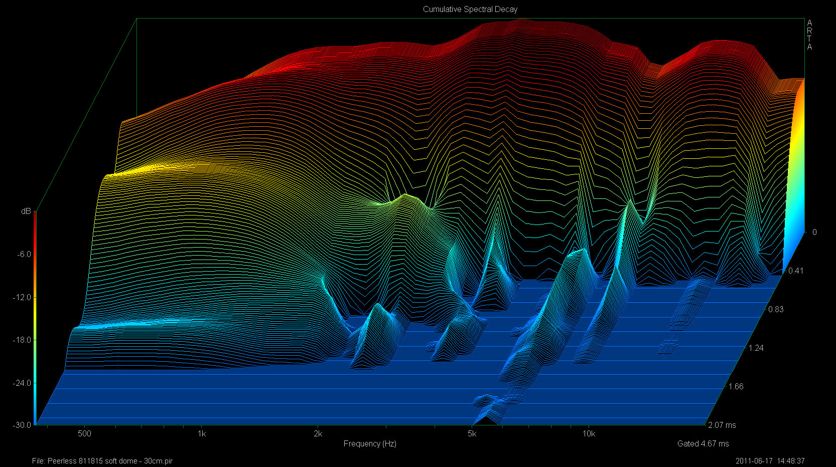

Next up is the soft fabric dome (Peerless 811815) - It's by no means a high end tweeter and I'm sure there are plenty of much more expensive domes that will measure a lot better, but it's probably representative of an average mid price dome.
Subjectively it sounds like a "typical" soft dome tweeter - it's fairly crisp (I wouldn't say it had sparkle or air though) but sibilance is quite noticeable on many recordings, nothing terrible that non audiophiles would notice or complain about, but I certainly notice it and find it annoying.
Between 5-10Khz there are two significant resonances, one at 6Khz, one just over 8Khz - both right in the sibilance region. Of particular interest is that the 8Khz resonance is an "anti-resonance" which actually occurs at a dip in the frequency response. (You can see the dip at the top of the waterfall, and as the response decays it then comes back up again - eg a decay that is not falling monotonically)
In a speaker an anti-resonance is often a sign of cone breakup. In the case of a dome tweeter it's almost certain that at this 8Khz resonance the middle of the dome is moving in the opposite direction to the outer part of the dome - thus causing partial cancellation. When the signal is removed and the outer part of the dome stops moving the middle continues to oscillate and flap around at this frequency and thus the ridge appears on the graph.
These resonances from 6-8Khz in my opinion are the cause of sibilance in this driver. If you look at the frequency response (at the top of the waterfall) it's not "hot" in this region at all, in fact there is a broad depression through the sibilance region which isn't there on the ribbon.

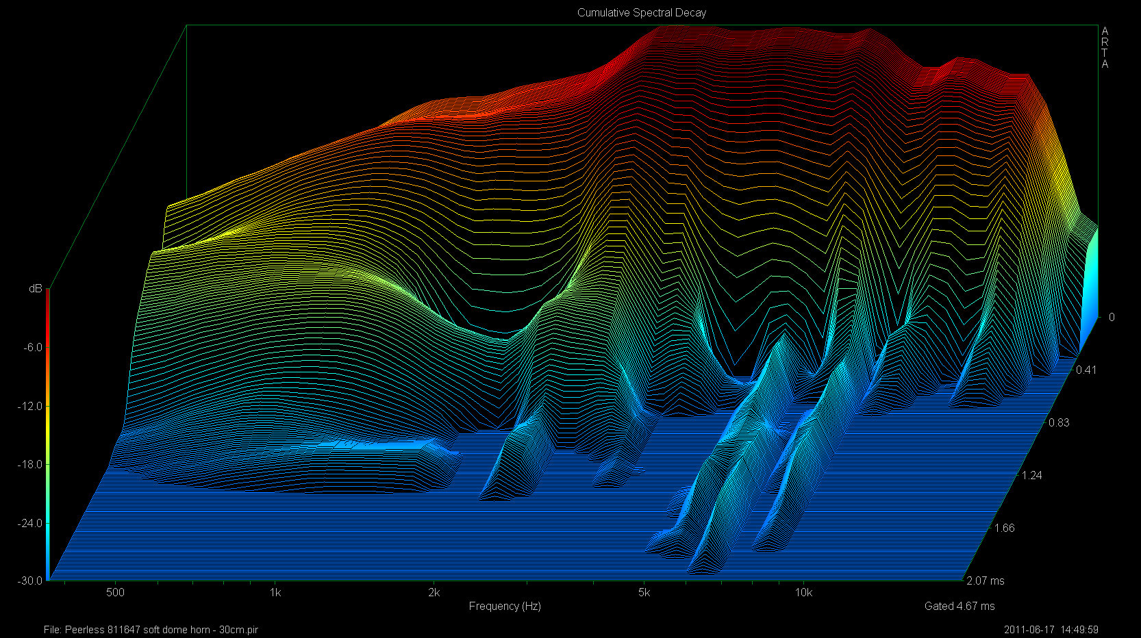

Ok onto tweeter number three - the Peerless 811647 soft dome horn - as mentioned in a previous post it's basically the same tweeter as the dome, but with a 40mm deep horn front plate instead of a flat face plate.
Subjectively I would say this is easily the worst of the three as far as sibilance goes. It's a very sibilant driver to the point where "essess" on just about everything sound bad. It's also got no sparkle or air at all, due to the rapid fall off in the treble above about 14Khz.
If we look at the 5-10Khz region again we can see that the resonances are even worse than the 2nd driver, and occurring at much the same frequencies - not surprising when it uses the same soft dome diaphragm. One critical difference though is that there are no "anti-resonances" visible, and much less of a dip in the response in that region.
Why ? Because as well as a horn it has a large phase plug in front of the middle of the dome which is blocking the out-of-phase radiation from the centre of the dome. You still have a resonance occurring because the rest of the cone is in cone-breakup as well, but you get a monotonically decaying resonance on the CSD because there is no out of phase cancellation from the middle of the dome.
In a way I think this actually makes it even more audible, because the overall amplitude in the frequency range where the resonances are occurring is increased.
Anyway that's my take on sibilance, I really do think it comes down to the decay response of the driver between 6-8Khz, (maybe even 5-10Khz) with the distortion characteristics possibly being a mitigating but secondary factor by increasing the excitation of the resonances depending on the spectra of the music. Frequency response balance only affects how noticeable or annoying it is.
