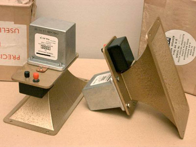

The Decca ribbon is not even remotely the same design as the G2. For one thing the Decca is horn loaded with a moderately large horn, while the G2 uses a small waveguide that's only about 15 mm deep.I suggest you look at the Decca Ribbon. They required silicone grease to be placed approximately at the 1/3 points to maintain ribbon stability due to the various modes and standing waves that naturally occur.
Compare:
Ribbon Tweeter Horn Loudspeaker: Decca London/Stanley Kelly - Efficiency, Size, Filter and Frequency Response.

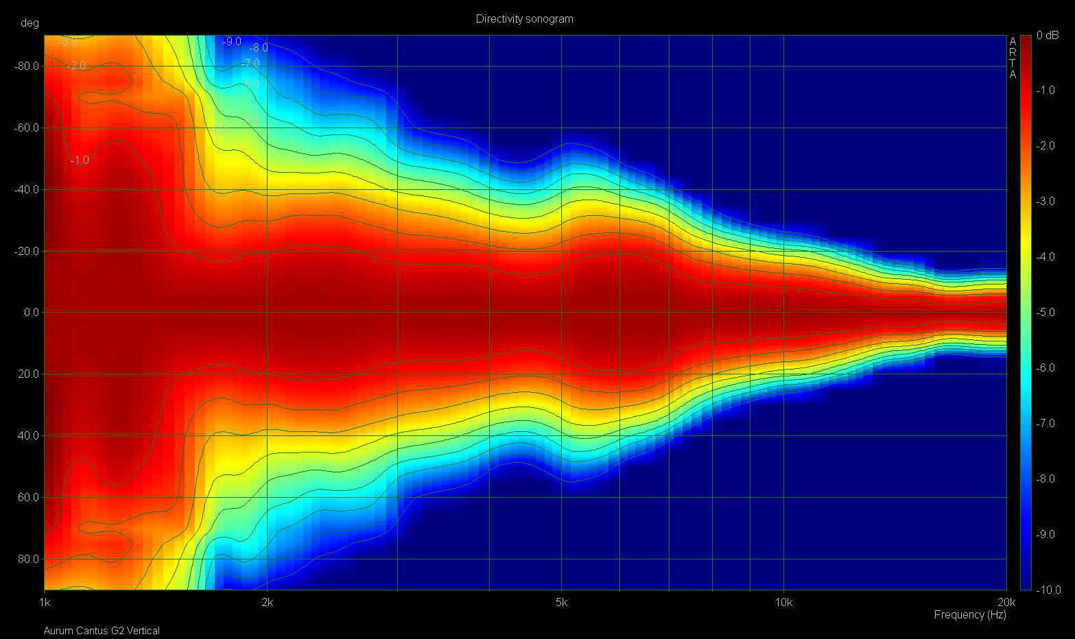

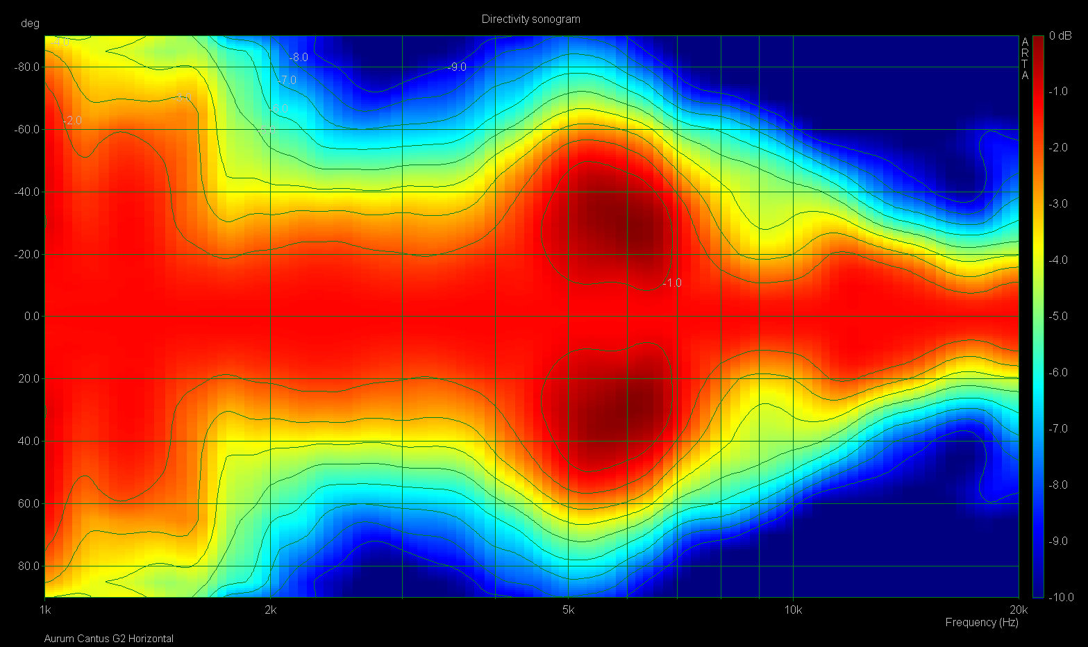

The Aurum Cantus G2 (and a lot of other modern ribbons) are not horns because they're nowhere near deep enough for the frequency range they're covering - the foil is only about 15-20mm behind the front of the face plate on the G2, and if it had a horn taper it would only be effective down to about 8Khz if you were lucky.
In fact it measures almost flat right down to about 1.5Khz, because it's acting (in the horizontal plane) as a CD waveguide with no horn loading. The horizontal off axis response is almost dead flat out to about 40 degrees then then entire range starts dropping off quickly - a CD characteristic. There is no significant horizontal off axis beaming of the high end - it stays steady from below 2Khz to 10Khz at about 90 degrees, then smoothly drops to about 60 degrees by 20Khz. Directivity index stays between about 2dB and 3dB across the entire operating range.
In short, a constant directivity waveguide has completely different characteristics to a horn, so don't confuse the two. There's a great article here that's well worth a read and explains horns vs waveguides:
Not all DECCA ribbons used a horn.
The effect of the horn was in the main on the LF end of the ribbon's output.
You're completely misunderstanding the differences between horns and waveguides. Technically they are both similar devices, but as far as what parameters are optimized they're at the extreme opposite ends of the spectrum.
A horn's primary purpose is to act as an impedance transformer increasing efficiency and net power response - directivity is something of a side effect. A horn typically has a gradual progressive expansion profile. The long throat and gradual curvature tends to cause beaming of the high frequencies since the driver diaphragm is obscured from view past a certain angle, and only the lower frequencies will bend to follow the curvature of the mouth. The "horn loading" only exists down to a certain frequency depending on the length of the horn - to get it to work down to 2Khz it would need to be something of the order of 50-100mm long.
The Decca ribbon is an an example of a horn.[/quote]
No the Decca ribbon is an example of a ribbon driver.
The horn was added, and is/was optional.
I'm talking about the behavior of the ribbon, without regard to the horn.
In fact it measures almost flat right down to about 1.5Khz, because it's acting (in the horizontal plane) as a CD waveguide with no horn loading.[/quote]
I tend to think it is doing next to nothing, and the polar response is entirely due to the shape and size of the ribbon WRT wavelength.

First, the SA ribbon had an optional wavguide.
It was non-flat with the waveguide.

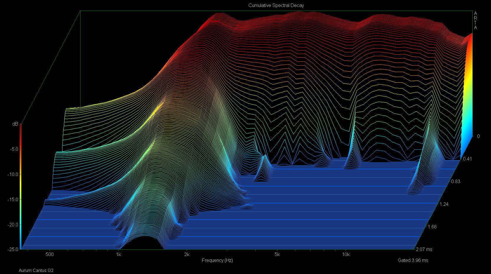

The CSD we can argue.

Yikes, considering we're getting well off topic in this thread, there is a ton of stuff that we'll just never agree on, so I'll just respond to a few points.
Analysing the response of a pure ribbon hanging in free space doesn't really tell you anything about what it will behave like once in it's horn/waveguide, so there's really no point in going down that path.
There is some apparent bloom in directivity around 5-6Khz but this is mostly a measurement artefact due to a 1dB diffraction dip in the on axis response, and the graph being normalized to the on axis response. (Thus boosting the apparent off axis response) There is some actual narrowing above 10Khz.
I've attached the vertical response as well. Yes it is a lot narrower, obviously.
Where the polar pattern and directivity control matter is in a room, not outdoors. Indoors, controlling the directivity is all about reducing the reverberant field in the room relative to the direct field, which is beneficial for good imaging at a distance among other things.
This is why I think sibilance is not a tonal balance issue but a resonances / spectral decay problem - the tonal balance of the recording and speakers just makes it more or less obvious, but a specific frequency response is not a cure.
Intermodulation and Harmonic distortion may be involved as well, (thanks to Lynn for starting me thinking along those lines) as it would cause sibilance region resonances to be excited by unrelated frequencies in the source material - for example the 3rd harmonic of 2Khz program material would excite a slow decaying 6Khz cone breakup resonance even though there is no 6Khz signal in the recording, making the distortion that much more obvious due to being stretched out in time. Likewise IM products from dense spectra would do the same - exciting the treble region resonances a lot more than the frequencies that belong in that region alone would.
Reducing distortion of the driver will reduce this tendency but only elimination of the resonances can cure it completely IMHO. Both would be ideal of course. 😀

Perhaps some actual measurements will tend to make you think differently. 😉 In the horizontal plane the ribbon element is only 8.5mm wide, so you would expect it to have extremely wide horizontal dispersion in the 2-3Khz range, right ? If it didn't have a waveguide it would, however if you check the first image I've attached you'll see that the -6dB directivity is held to about 90 degrees (+/-45) right down to 2Khz. Below that it loses control and gets much wider as the waveguide becomes ineffective.I tend to think it is doing next to nothing, and the polar response is entirely due to the shape and size of the ribbon WRT wavelength.

It may offer an improvement IF the main source of sibilance is a driver with a distortion and/or breakup issues. But so can any "better" driver than the one before offer an improvement.
Doesn't it suggest that there is something about the characteristics of the driver that causes it to still have sibilance ? Do you have a way to measure their CSD ? That would be interesting to see. I've attached a CSD plot of the G2 for comparison. The "resonance" at 15Khz is actually a capsule resonance on my microphone which shows up on every driver I measure, but otherwise I think it's reasonably accurate. The gate markers were set so decay begins at 0.4ms.I mentioned the SA as an example of a driver that while flawed in the vertical polar response department offers a full order of magnitude better distortion spec than almost anything out there, your driver included.
It did not "eliminate" sibilance. It did offer improvements in that department, as things that were heard to be much more "obvious" became apparent once it was being used... the other sources of sibilance remained to be conquered.
In otherwords, sibilance does not have a single source or cause.

I look at ur plot of ur tweeter and I see it narrowing with frequency.
Vertical and horizontal.
The Decca was NOT designed WITH the horn per se.
It was sold without a horn as well.
Afaik, it followed the Romagna design, which was integrated with a cast exponential horn (as seen in the Decca version in your link) which again was intended to permit the ribbon to be used lower in frequency, not for dispersion control.
If I recall correctly there were three different models of the Decca Ribbon Tweeter. The first was the Decca Kelly DK30, then there was a larger Decca London Ribbon, and finally a Decca Super Tweeter. Only the latter was hornless, and was released in the 1970s because so many people were removing the horns from the earlier versions to use them for supertweeters.
Yes, but think about what this implies - horn vs. no horn.
The purpose of the horns was to get the unit to go LOWER in frequency.
As I mentioned earlier, the first one in ur nice pix was a copy of the Romagna tweeter... same unit.
