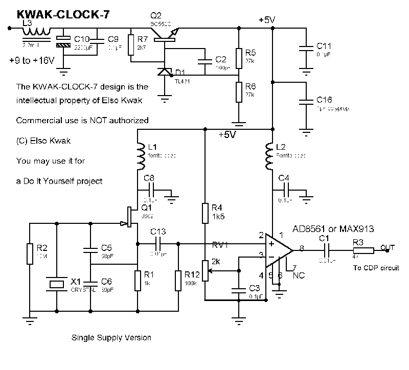

The 431 circuit uses feedback to regulate the output voltage. The divider is at the output side and provides a feedback to the 431. Any noise produced by the 431 will be present at the output because it's a closed loop, correct me if i'm wrong.
The other circuit has the divider at the input side and doesn't use feedback. The voltage at the base of the BC550 is well filtered by the divider R1/R2 and C3. Nothing more than a passive RC filter. The transistor is a simple voltage follower that provides extra current. My guess is that this transistor produces less noise than a 431 + transistor combination. But of course it may sound worse, i'm hoping to find out 😉

Regarding the regulator, many "experts" consider the TL431 shunt regulator superior to other series regulators, at least for digital applications. I have used them extensively in my TDA1541 non-oversampling DAC and I' m quite satisfied. I don' t say that I have compared them to other regulators - I neither have the time nor the knowledge to try so many things. I simply follow others' suggestions - people that I estimate them to be a level or two higher than me. So, I just use a previously applied idea or circuit.
Now, my suggestion was that, since the Kwak Clock does not draw large current, one can make the TL431 regulator simpler, that is, without the transistor.

Ah, o.k. Way too much deep thinking on my part. You mean just use it as a pure shunt regulator. Well, it's easy to bypass the NPN on the PCB, when I have it working I'll try it.

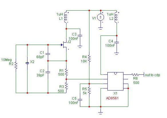

I have just measured >5V, with 5V power supply. Also the sims gave that. I did not want to post without controlling. Did you measure the signal with the jfet source disconnected from the comparator inp? [pin2] Try it please. And then reconnect.
Because one pic is better than a page of explanations, I've made a short demo drawing of what I'm talking about.
But anyway, this is only a mod for the lazy, like 6h5c..🙂
Otherways your standard version works. I only brought this up, because it may be an explanation.
Ciao, George

oops again, just recognized that the ground for the osc. is missing in the pic. It should be grounded.
George

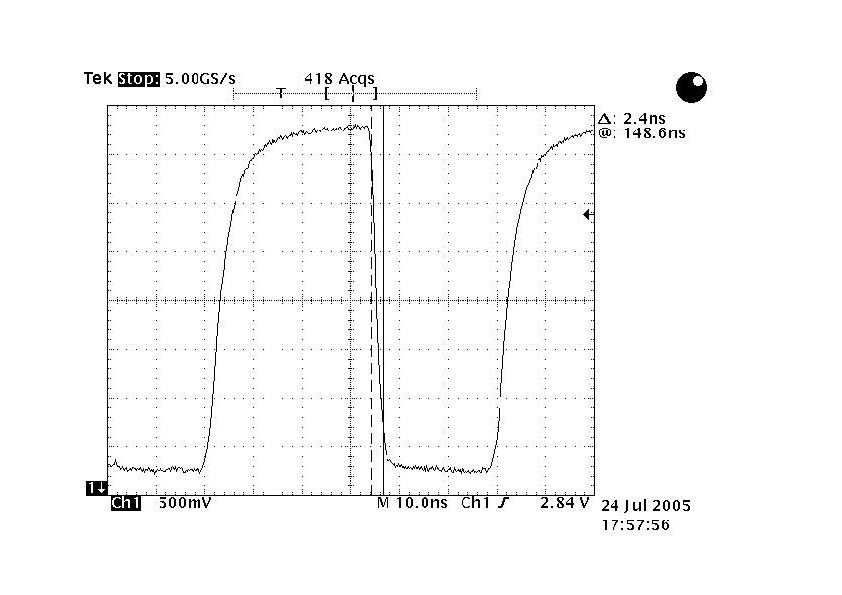

So, first the oscillator output in the Kwak Clock, measured on pin 2 of the [connected] comparator. The power supply, measured with the same scope probe, is 5.02 V. Notice the base shift of the signal versus negative.

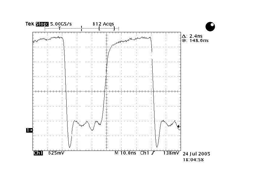

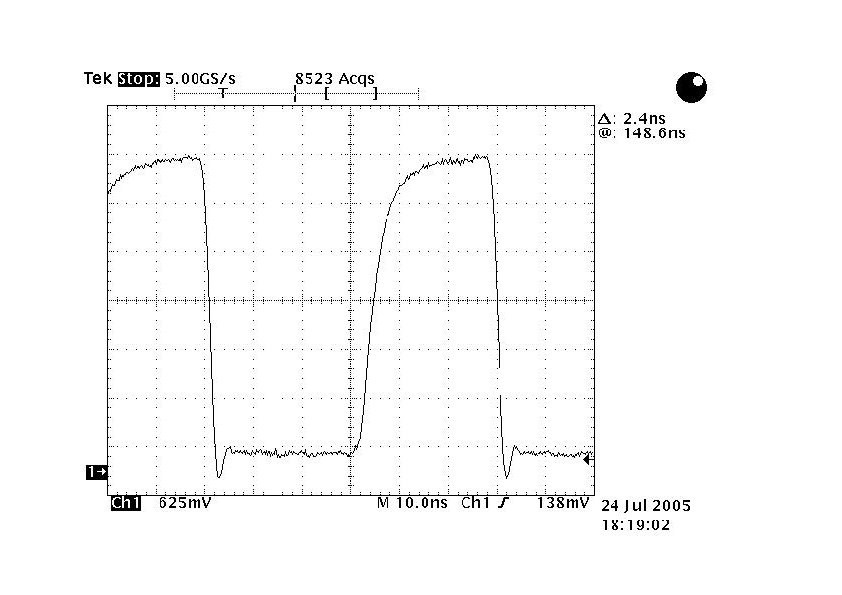

Nice, eh? Now I can admit, that it was a pain to get it.. That is, to arrive to this, one should have the right instrumentation. Here I would enclose the same thing, but with the standard [though still better than average scope probe]
I hope it is more familiar.. 🙂
Now I can disclose the difference: the first graph was taken by a Tek P6243 fast/active/divide by ten probe, having, most importantly, < 1pF input capacitance, 1Meg input impedance, 1G bandwith - and a local springy ground lead applied.
The second, standard case was taken by a Tek P6137, Only 400 Mhz, but most importantly, 10.8 pF/ 10Meg input impedance, with the usual, or still better than usual ~10cm ground lead. Which I tried to wrap up / fit tight, but it's impossible.
So as to see which is the bigger problem, the ground lead or the input capacitance, I tried to place a small variable cap on the Qout. with this having a ~4pf [minimal ] value, the situation is the following:
