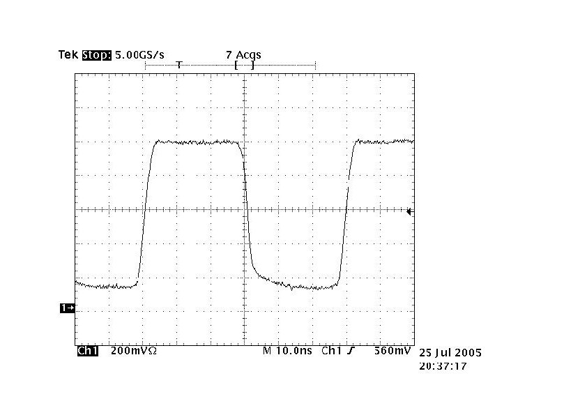

So, after having looked up ALL the kwak pict. postings around here, I finally got it. We just kept on talking beside each other. What You [all] wanted to see is the usual, 50 ohm terminated clock output. Ok, here You are: the very same clock, on the Qout there is a 50 ohm back termination, the other side is terminated at the scope [so there is a heavy amplitude loss, look it up in the original graphs: the output is more than 3.5V]
But, I would like to emphasize that it's not the proper way of doing it! That is, it's the proper way of getting the signal out of your clock in practice. But when presenting, the real output signal graphs are those of MINE. THAT is the reality! If You want to see what is happening really in the circuit, you load it as less as possible - with your measurement probe. AND change the different test loads.
Ok, rant mode off, please understand me, I feel like I have lost a full day trying to understand what is wrong with the circuit...🙄 😱 :hot:

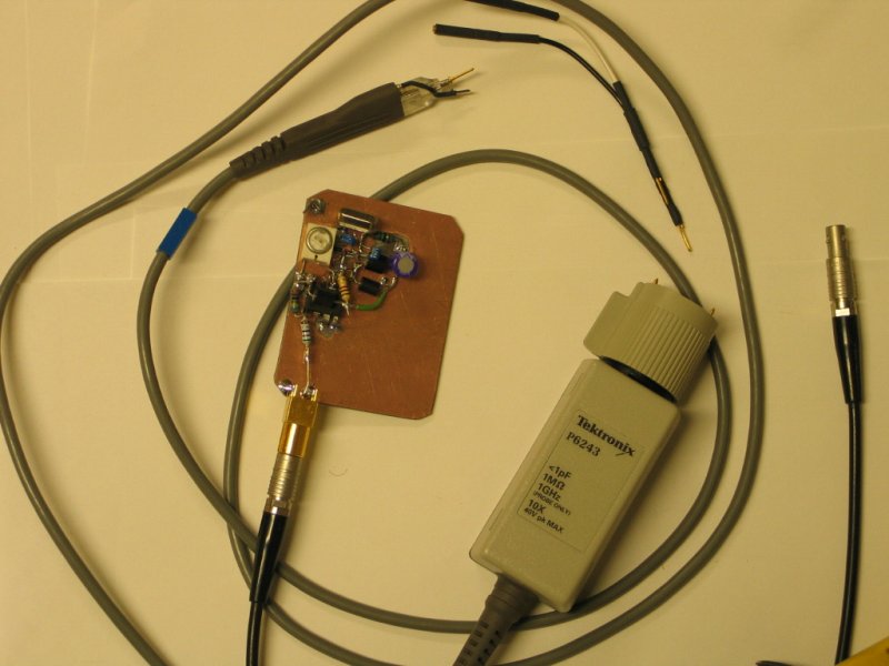

Now I would like to post a pic of the cause of all my troubles:

I think it really works in the same way as You could notice it on the ad8561 output: [where you can see it better, because there are no power supply problems in the way - remember, on the F74 I was intentionally using a weak supply]
The upper half driver is just much weaker than the pull down driver, so the falling edge is much more dramatic, and so generates more bounce. You don't see it very well, because of the probe effects; the weak power supply effects. This is why the edges seem to be more similar.
By the way, your idea of the non-symmetric drive on the comp. inp is for sure valid, anc I checked it [sort of] : according to this, if one takes the signal from the divided up source resistance [shown previously] than it should became more symmetric. I tried it, but no visible effect on the output. The output is affected by the : optional pull-up resistor; the power supply rail values.

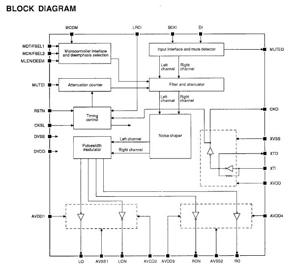

I'm afraid my inverters are just across the border (the DAC is a CD67 SM5872). But it has separate power pins, just for the inverter section, so that is the good news. Never the less, I'd like to see a measurement when the clock is actually in a player, and see how the MCLK or CKO line looks :bigeyes:.
