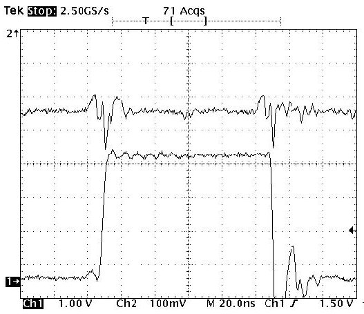

Joseph K said:With the trimmer set to ~13pF [max.], I got this picture:
So, it seems that hte ugliest part was due to the scope ground lead, but still, it seems to me that the Qout is extremely sensitive to the load capacitance present.
asymmetrtical output impedance - anyone care to explain ?
Finally, I would like to ask pardon from Elso for being unfoundidly obtrusive...

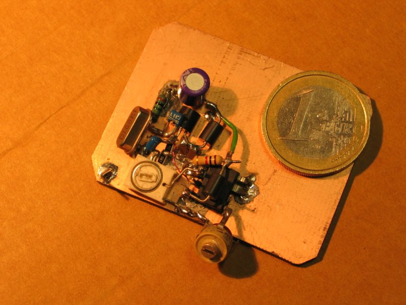

Hi George,
No problem at all! Feel free to experiment with the circuit as it is no secret.
Maybe this:
http://www.hagtech.com/hagclock.html
can give you some inspiration too.
I experienced also problems measuring the square wave. It sounds all too familiar to me.

Some afterthoughts about the above measurements: Looking at the graphs in posts 115 /116, I feel like I should quantify the [possible] differences. So I will repeat them, but now doing an FFT.
As regards double supplies, it really resolves this problem, [if exists]. And, as came to my mind later, helps also with respect to ground bounce: the [+IN] is not referred any more to the jumpy ground, but to the - supply.
Though there is also the 100nF filter cap, which happily transfers the bounce backwards... life is difficult..
Then, the ground bounce instead is a problem. What became clear for me is that one should be very careful with the load on the comparator. Reactive loads generate groundbounce. Because the negative going edge is just too fast. Would be better if the comparator would be slower..
And reactive load means the simple, short wire that leads to the main circuit. Not to speak about a multipoint distribution..
There is only one way to make that wire not reactive - a transmission line.
With all it's consequences, that is, signal amplitude loss at termination, and an overall heavy load close to the chip output capabilities..
Or, a buffer right after the comparator, very close to it, and presenting small input capacitance? Then one should decouple also the buffer very well..
Or, the re-sampling flip-flop only a cm away, directly [and uniquely] connected.. This is what in fact I try to do, always.
I think I'm not just imagining all these, these are real problems. But it does not mean that the clock would not work, only not so well as it would be theoretically possible.

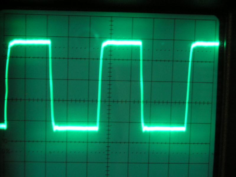

There are alternatives for the comparator, you may try LT1016.
For reference, one of my clocks measured with 15 cm twisted wire into 50 ohms.

Guido,
Your pic is nice, but before saying Wow, I would like to clarify some details, so as not to compare apples & oranges.
Your vertical division is obviously 1V/div, this is clear. Also is clear that the circuit is some type of cmos, probably HC. [from the amplitude & symmetry] Your horizontal scale is 20 nSec, I suppose. Because if it's true, then one cycle is ~90nsecs, as it should be with a 11,288 MHz clock.
Now, the scale on mine graph is 10nsec /div, the problematic edge is actually, as can be seen by the cursors, 2,4 nsec fall time, conservatively measured. Measured like in the data sheet [20%-80%], it is very close[~1.7nsec] to the data sheet value. This is valid also for the rising edge, that is, it's like the data sheet value[3.8 nsec, or 5nsec, if conservative]. So nothing is wrong with the chip, or setup. [And I would challenge anybody (Bricolo) to reproduce the data sheet values as nice as it is here]
Now, your rising /falling edges are also slightly assymetric, though much less. And they are, at least, and in accordance with the 20 nsec/div time scale, 5nsec, the slower might be even more. So, your output edges, BOTH, look like the rising edge on the Kwak Clock.
And as it can be seen on mine graphs, indeed at this velocity there are no problems showing up, and this is why I said slower might be better here.
The AD8561 is a bipolar device, and as such, it uses some fast TTL like output driver configuration, and as we all know, TTL level signals are indeed assymmetric, not rectangular.
You are right, that other comparators will behave differently, and indeed, the Hagerman clock has a more symmetric output.
But, while looking around about the common-mode input range problem, I have just noticed, that this problem will present itself in a more brutal form with the LT1016, properly because that one is an NPN input pair device, and the strongly positive -going input signal will encounter a much heavier load. So no wonder, that Elso was experiencing a better sound with the AD unit. Or at least this is my hypothesis. Of course, proper signal conditioning would be due.
