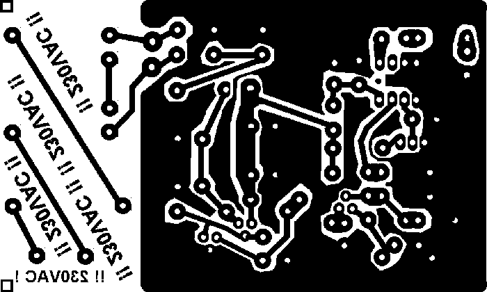

Franz, your 230 VAC looks not 100% good, it might even be dangerous. The creapage distance is way too small between primary and secondary side. You should strive to have 8 mm creapage.
Don't forget that your text is also made of copper so it will also decrease the general creapage.

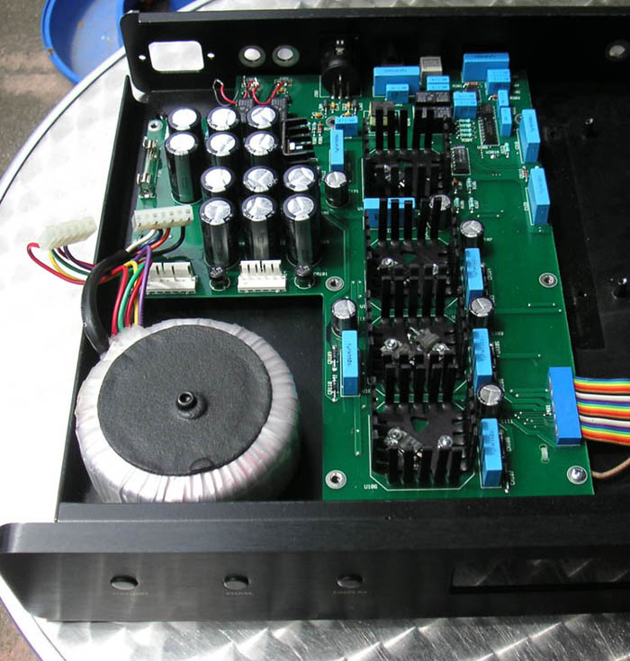

My next project, a external DAC with tube output, will be based on this Classé 1 enclosure with the original psu (the original dac board has burned out...).
Here, I find primary traces 4 to 5 mm away from the groundplane. And: originally, the middle pin of the IEC connector, the earth, is hanging in the air, not connected at all!
But: still a very nice base to build a own DAC. 10mm alu frontplate and very nice finish at all.
That is called double insulated in Europe, nothing wrong with that. No ground loops and safe if well implemented.
