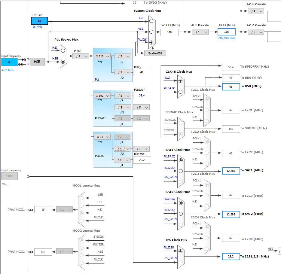

Can low jitter be achieved with STM32 microcontroller
Yesterday I found what I was looking for to be confident in being able to develop the Async USB with explicit feedback, which was my main concern. It derives from the the Audio-widget project that's here : http://www.diyaudio.com/forums/digital-source/185761-open-source-usb-interface-audio-widget-10.html

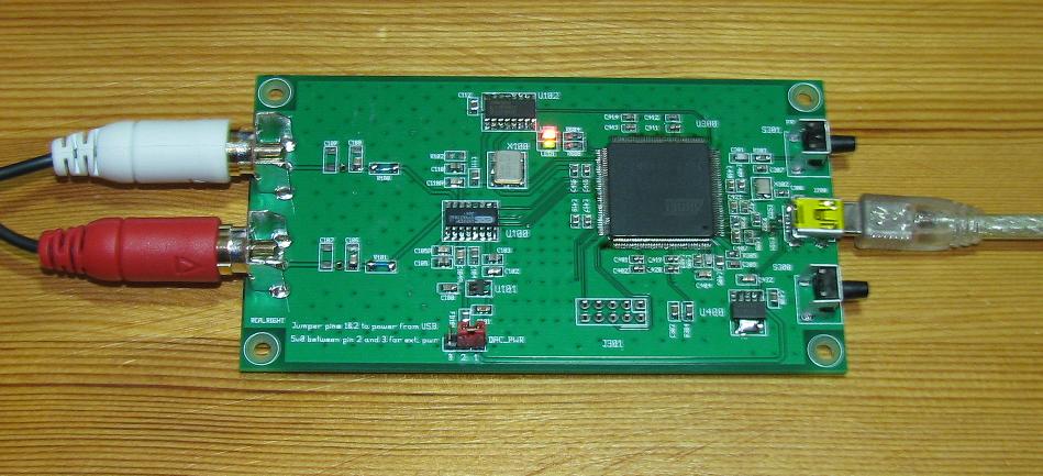

The Audio Widget designed by George Boudreau relies on a ES9023 Stereo DAC, a SiLabs Si532 dual rate oscillator as a DAC clock, and a 144 pin AT32UC3A3256 CPU. See the attached .jpg.
The code running in the Atmel AT32UC3A3 is documented on github, here : https://github.com/borgestrand/sdr-widget/tree/master/src
Latest commit 928d195 is dating back from 20 Oct 2012.
There is another Audio Widget, this time designed by PAVOUK, see the attached .pdf and webpage http://www.pavouk.org/hw/audiosystem20/en_at32uc3a3256usbi2s.html
It reads : For Linux and Mac are not needed any drivers for full use of module, because they are part of system core. Windows includes only support for UAC1 mode and for full use is needed to download drivers from original pages. It is needed to get right driver which will know exact card ID according to used firmware. In Linux I hit the troubles that in Alsa mode doesn't work playing in XMMS application. When I use OSS emulation that it works perfectly in UAC2 mode. In other players I didn't see this problem and with another USB-I2S converter XMMS works correctly. In UAC1 mode is situation a little worse. In OSS mode it plays incorrectly. Music jumps and tears. I can't tell if problem is in firmware, in player or in a kernel driver.
The schematic remains simple and qualitative :
- two quartz oscillators supposedly acting as Master Audio Clock (USB Async Audio ?),
- a flip-flop dividing the 512 x Fs frequency by two for guaranteeing a perfect 50% duty cycle on the 256 x Fs
- a galvanically isolated I2S + MCLK bus, thanks to a ISO7240 chip receiving an external 3.3 Volt power supply.

I'm not insisting on the schematic, because it is more complicated than the PAVOUK one. Please try understanding the PAVOUK schematic, and you'll be fine with your STM32F7 implementation. Add a frequency divider (D-type flip-flops) for generating at will, 256 x Fs (SAI in I2S protocol), and 64 x Fs (SAI in SPDIFTX protocol).

Steph
  • Audio Widget designed by PAVOUK.pdf

Please review the six clock schemes inside the attached .zip.
Hi Steph,
I studied your clock schemas. Thank you very much. From those schemas, I feel that the standard 8 MHz crystal allows the main configuration for the 48 Hz sampling rate with 0% error : I2S in master mode, Spdif.
Maybe we can also get an acceptable 44.1 reference.
I wonder what is the order of magnitude of the jitter in the PLLSAI, and by how much it would be reduced with an external I2S_CKIN.
I think I will start with the standard 8 MHz crystal.
By the way, there is a point that I don't understand in the CPU 8 MHz XTAL driving SAI(I2S) master for 48 kHz audio file.
You achieve 12.288 MHw for the SAI1 & 2. If I try to configure the I2S1 with the same parameters using PLLI2SR (8MHz /5*63/4, I arrive to 25.2 MHz. Why with same parameters PLLI2SQ delivers 12.288 and PLLI2SR delivers 25.2 MHz ?
JMF
