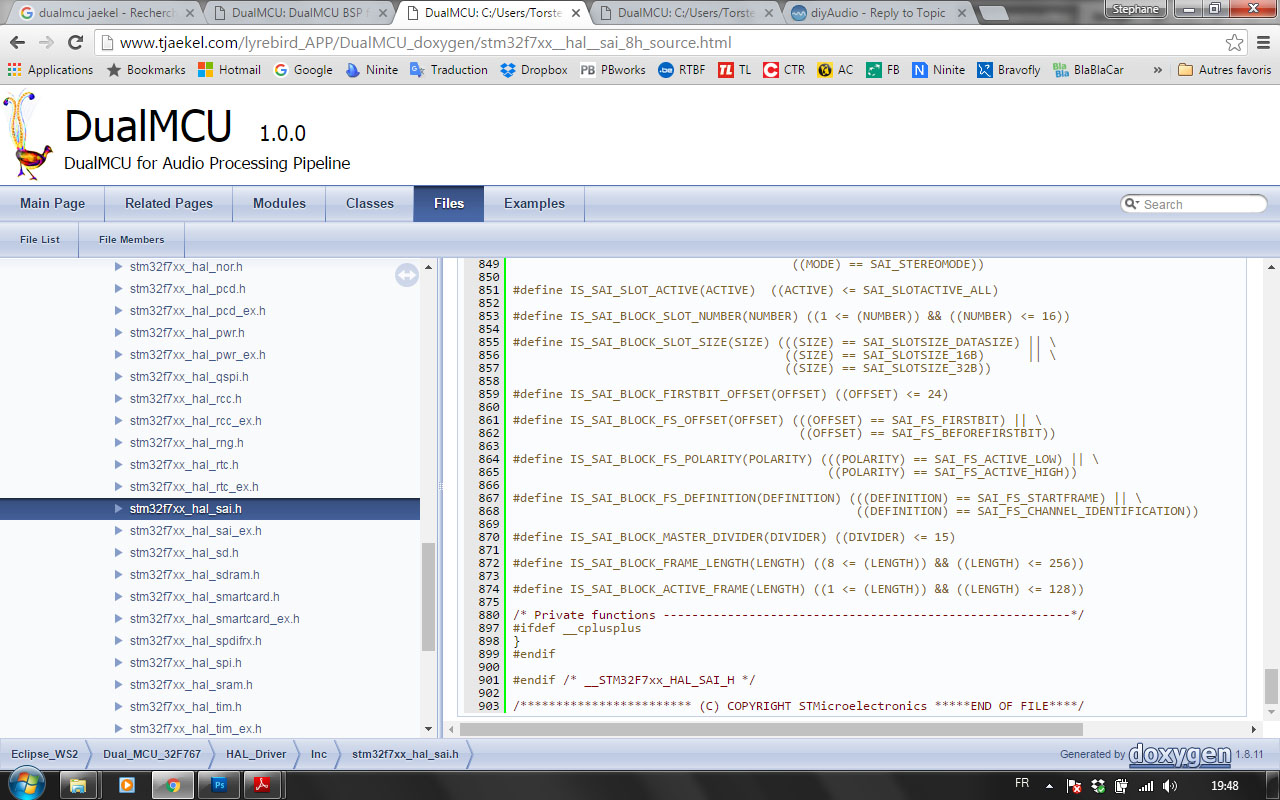

I'll go forward 🙂 even if it may be slow... Two weeks leaves will take me far form that project, but I hope to have something by the end of summer on the stm32F4 discovery, with USB in (the one provided by ST) => DSP => I2S=> onboard DAC + another I2S not connected to anything.
This will be the basic template for the stm32F7 project with SPDIF output.
As I have 2 left hands and not enough knowledge, I have to keep the hardware part as minimal as possible.
JMF
JMF

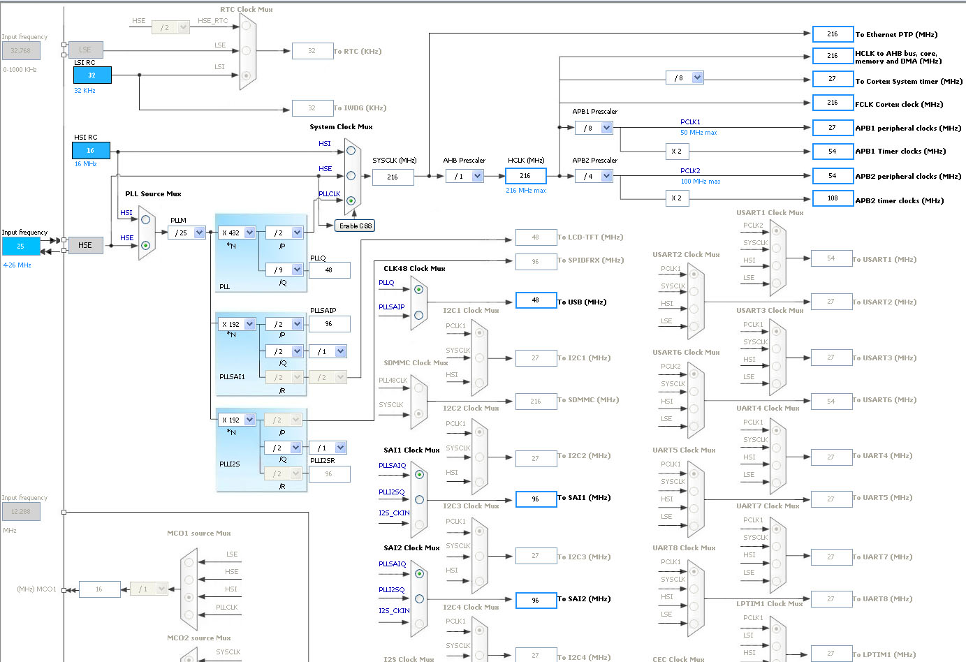

Because of relying on a USB to I2S module, the STM32F4 or F7 doesn't need to deal with the USB protocol, and thus, there is no precise 48 MHz clock required. The STM32F4 or F7 could thus rely on their built-in RC oscillator, instead of a 16 MHz quartz.
Knowing this, you should rely on STM32CubeMX for configuring the STM32F4 or F7 clocks, peripherals, and pinout.
Decide who will act as I2S master. Will it be the USB to I2S module or will it be the STM32 ?
Make sure you understand the difference between I2S master/slave and MCLK clock master.
Check the MCLK frequency the USB to I2S module is actually outputting. Add some frequency divider (hardware) if required. It may be a tiny IC like the CS2000 tjaekel featured on his DIGI-STM board. The CS2000 gets controlled by a I2C bus. Apparently, he relies on a 24,576 kHz quartz oscillator as master clock, then divide it by a certain factor, eventually fractional, for attaining all common audio frequencies like 12,288 kHz (48 kHz) or 11,2896 kHz (44.1 kHz).
Configure the STM32F7 I2S that's receiving the audio data, in such a way that it generates an interrupt each time there is new audio data available. Such audio interrupt should recur at 48 kHz.

Later on, T. Jaekel designed a board that he calls "DualMCU" that's again acting as interconnect between a STM32F7 Discovery and a miniDSP DIGI-FP, but this time, such board embeds a STM32F7. The name "DualMCU" comes from the fact that one can daisy-chain a supplementary STMF7 board, exchanging audio data through the SAI.
Regarding the audio clocking, the "DualMCU" presentation sheet says about a "high-performance PLL used to support 48 as well as 44.1 KHz based audio sample rates" which means that again, we'll find a Fractional-N Frequency Synthesizer configured by I2C. This time, it can be a CS2300.
Quite interesting is that such "DualMCU" board is driven by software that has been published by T. Jaekel. The webpage dealing with 1) the configuration of the miniDSP MINI-FP, and 2) the configuration of the on-board Fractional-N Frequency Synthesizer is here : DualMCU: C:/Users/Torsten/Documents/Eclipse_WS2/Dual_MCU_32F767/BSP_DualMCU/src/BSP_DualMCU_i2c.c Source File

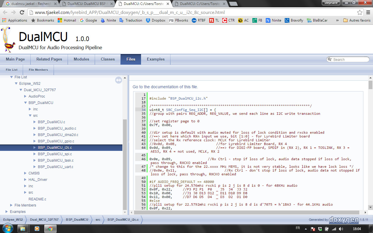

The software has a section named "BSP_DualMCU_i2c.h". This is in the form of a Board Support Package, only dealing with the I2C functions described above. It takes T. Jaekel, 648 lines of source code in C, for doing the required configurations through I2C.
See the attached .jpg.
Such is the drama of nowadays software engineering.
By the way, we still don't know about the STM32F7 Audio Clock Input, and the way T. Jaekel configured the SAI. He does through this : DualMCU: C:/Users/Torsten/Documents/Eclipse_WS2/Dual_MCU_32F767/HAL_Driver/Inc/stm32f7xx_hal_sai.h Source File
There are 903 lines of source code in C, this time originating from STM, as HAL (Hardware Abstraction Layer).
What do you think about this ?
Steph
Steph
tjaekel Lyrebird DIGI-STM board connecting on miniDSP DIGI-FP (schematic).pdf352.2 KB · Views: 245
tjaekel Lyrebird DualMCU is configuring miniDSP DIGI-FP using I2C (source code).jpg306.7 KB · Views: 458
tjaekel Lyrebird DualMCU is configuring the SAI using STM HAL (source code).jpg301.9 KB · Views: 445

Here is the system initialization code from the DualMCU webpage : DualMCU: C:/Users/Torsten/Documents/Eclipse_WS2/Dual_MCU_32F767/src/main.c Source File
It consists of a mix of code generated by STM32CubeMX, and code generated by T. Jaekel. Conditional compilation is used for selecting between overdrive (260 MHz) or no overdrive (212.336640 MHz).
It seems that the STM32F7 Audio Clock Input is not used.
Some things are unclear to me, like manually edited sections and values.
We need to revert to STMCubeMX, asking STMCubeMX to configure the chip, and see what code gets generated.
Steph

I propose a clean sheet start.
There must be a 25 MHz quartz on HSE. One cannot rely on the 16 MHz internal RC oscillator, then ask PLLM to divide it by 16. Doing so, STM32CubeMX turrns the "PLL Source Mux" red, warning that "PLL Mux should have HSE as input". Can somebody tell why ? By the way, one could have relied on a 16 MHz quartz on HSE, divided by 16 in PLLM.
Anyway, we get a 216 MHz SYSCLK. No overdrive thus.
The AHB prescaler is set to 1. We get a 216 MHz HCLK.
The APB1 prescaler is set to 8. We get a 27 MHz PCLK1 (max is 50 MHz).
The APB2 prescaler is set to 4. We get a 54 MHz PCLK1 (max is 100 MHz).
Please note, in tjaekel DualMMU, APB1 prescaler was set to 4, and APB2 prescaler was set to 2, meaning their frequencies were exceeding the max.
PLLSAI1 gets in charge of clocking the SAI1 and SAI2, clocked by PLLSAIQ.
N = 192
P = 2
Q = 2
R = 2
PLLSAIQ is 96 MHz.
Can somebody tell the purpose of such clock in the SAI ?
The SAI get configured same way as tjaekel DualMCU.
They are all SLAVES.
Which means that they receive both the 48 kHz frame sync, and the bit clock.
Am I right ?
By the way, I am not sure about the SAI "SynchroExt" parameters.
Can somebody tell ?
Anyway, here is the code that's generated by STM32CubeMX.
I don't like the way STM32CubeMX interleaves user code with automatically generated code. There is an option in the STM32CubeMX settings, about keeping the user code. I don't know how this can work.
I am attaching the STMCubeMX .ioc file wrapped into a .zip so you can reverse-engineer the clean sheet start proposition.
I added USB support, just in case, as future discussion base.
Steph

RCC_PeriphCLKInitTypeDef PeriphClkInitStruct;
__PWR_CLK_ENABLE();
__HAL_PWR_VOLTAGESCALING_CONFIG(PWR_REGULATOR_VOLTAGE_SCALE1);
RCC_OscInitStruct.OscillatorType = RCC_OSCILLATORTYPE_HSE;
RCC_OscInitStruct.HSEState = RCC_HSE_ON;
RCC_OscInitStruct.PLL.PLLState = RCC_PLL_ON;
RCC_OscInitStruct.PLL.PLLSource = RCC_PLLSOURCE_HSE;
RCC_OscInitStruct.PLL.PLLM = 25;
RCC_OscInitStruct.PLL.PLLN = 432;
RCC_OscInitStruct.PLL.PLLP = RCC_PLLP_DIV2;
RCC_OscInitStruct.PLL.PLLQ = 9;
HAL_RCC_OscConfig(&RCC_OscInitStruct);
HAL_PWREx_ActivateOverDrive();
RCC_ClkInitStruct.ClockType = RCC_CLOCKTYPE_HCLK|RCC_CLOCKTYPE_SYSCLK
|RCC_CLOCKTYPE_PCLK1|RCC_CLOCKTYPE_PCLK2;
RCC_ClkInitStruct.SYSCLKSource = RCC_SYSCLKSOURCE_PLLCLK;
RCC_ClkInitStruct.AHBCLKDivider = RCC_SYSCLK_DIV1;
RCC_ClkInitStruct.APB1CLKDivider = RCC_HCLK_DIV8;
RCC_ClkInitStruct.APB2CLKDivider = RCC_HCLK_DIV4;
HAL_RCC_ClockConfig(&RCC_ClkInitStruct, FLASH_LATENCY_6);
PeriphClkInitStruct.PeriphClockSelection = RCC_PERIPHCLK_SAI1|RCC_PERIPHCLK_SAI2
|RCC_PERIPHCLK_CLK48;
PeriphClkInitStruct.PLLSAI.PLLSAIN = 192;
PeriphClkInitStruct.PLLSAI.PLLSAIR = 2;
PeriphClkInitStruct.PLLSAI.PLLSAIQ = 2;
PeriphClkInitStruct.PLLSAI.PLLSAIP = RCC_PLLSAIP_DIV2;
PeriphClkInitStruct.PLLSAIDivQ = 1;
PeriphClkInitStruct.PLLSAIDivR = RCC_PLLSAIDIVR_2;
PeriphClkInitStruct.Sai1ClockSelection = RCC_SAI1CLKSOURCE_PLLSAI;
PeriphClkInitStruct.Sai2ClockSelection = RCC_SAI2CLKSOURCE_PLLSAI;
PeriphClkInitStruct.Clk48ClockSelection = RCC_CLK48SOURCE_PLL;
HAL_RCCEx_PeriphCLKConfig(&PeriphClkInitStruct);
HAL_SYSTICK_Config(HAL_RCC_GetHCLKFreq()/8000);
HAL_SYSTICK_CLKSourceConfig(SYSTICK_CLKSOURCE_HCLK_DIV8);

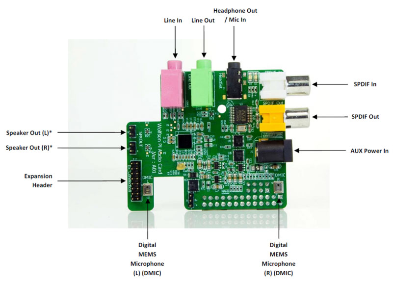

The WOLFSON AUDIO CARD for Raspberry Pi.
Eventually to be used as bit-perfect SPDIF-in (no ASRC involved).
See here : wolfson-audio-card/carte-raspberry-pi-soundcard/dp/2347264
Selling price : less than $25.
This is the audio hub originally developed by Wolfson and Element14, for the old Raspberry Pi featuring the 26-pin expansion connector along with the "P5" 8-pin digital audio header.
The Wolfson Audio Card embeds :
- one WM5102 Audio Codec featuring stereo audio in (analog) and stereo audio out (analog),
- one WM8804 SPDIF transceiver featuring SPDIF-in and SPDIF-out,
- two WM7720 Digital Siicon Microphones.
The difficulty with such arrangement, is to properly configure the WM5102 using I2C. Get warned : the WM5102 datasheet is 334 pages long.
Fortunately there is a Raspberry distribution supporting the Wolfson Audio Card.
This webpage provides a Raspberry Pi Image from Element14 that contains support for the Cirrus Logic audio card : https://www.adafruit.com/products/1761
Beware of the 2 Gigabytes to be downloaded. This is massive Linux stuff.
One may try locating the WM5102 initialization source code, and copy-paste it to a STM32F4 or STM32F7 application.

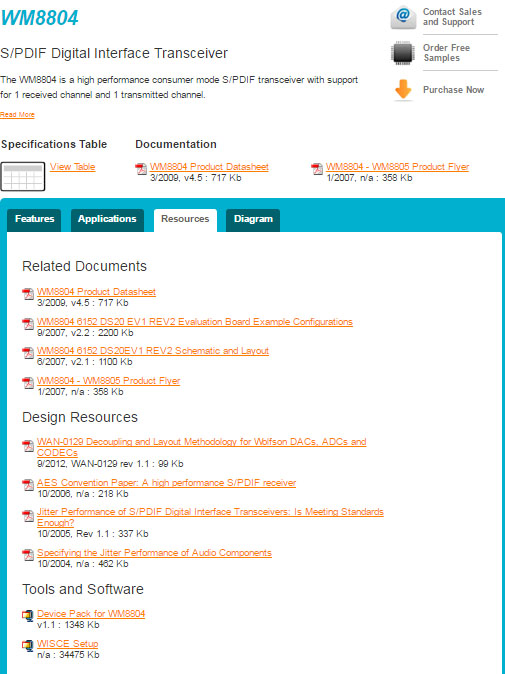

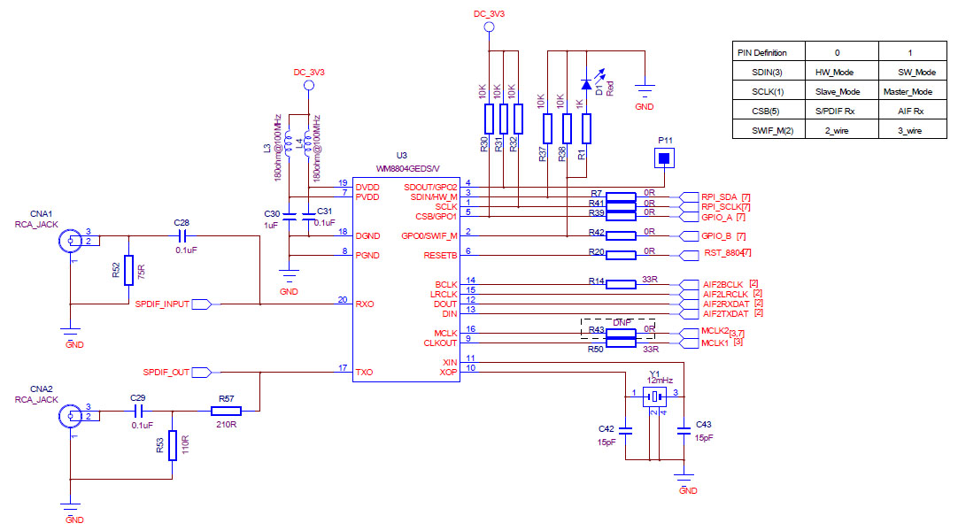

For the ones only interested by the WM8804 SPDIF-in (listen from a CD player or from a PC), there exist a different way. The WM8804 is easy to configure using I2C. The WM8804 datasheet is only 66 pages long. Unfortunately, on the Wolfson Audio Card, the WM8804 I2S is passing trough the WM5102, prior reaching the "P5" 8-pin digital header that you'll hook on the STM32F4 Nucleo or STM32F7 Nucleo. Consequently, you may be tempted by soldering three wires on the WM8804 (I2S_LRCK, I2S_BCLK, I2S_TX) for directly providing audio to the Nucleo board, not to forget the MCLK that's also generated by the WW8804 to be considered as high quality "Audio Clock In" that you are obliged to provide as 256 x Fs clock for the Nucleo I2S blocks, operating as I2S slaves. Indeed, by choosing SPDIF as audio source, the WM8804 becomes the audio clock master, and the I2S master also. In case you rely on the STM32F7 SAI, you need to clock them from the "Audio Clock In" also, and configure them as "Asynchronous Slaves in I2S Protocol".
I'm also attaching the schematic on .pdf, as it tends to vanish from the web.

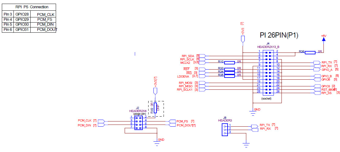

Wolfson Audio Card - schematic diagram (version with 26-pin Raspberry and 8-pin P5).pdf325 KB · Views: 166
Wolfson Audio Card for Raspberry - Raspberry connexions.jpg118.9 KB · Views: 322
Wolfson Audio Card for Raspberry - WM8804 SPDIF transceiver.jpg145.7 KB · Views: 631

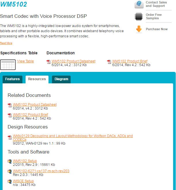

I went on Cirrus Logic website and found the required resources.
WM5102 : Smart Codec with Voice Processor DSP
Go in the "resources" tab.
Over there you will find "WISCE Setup" (.zip download) and "WM5102 Setup" (.zip download).
Once both are installed on your Windows computer, you ask WISCE to open a WM5102 project.

While doing so, we see WISCE updating the historic, that one can save on a text file. Provided that you act in a clean way, this is what you are going to find in the historic file :
* REG DATA ACCESS READ OR DEVICE
* INDEX VALUE TYPE WRITE ADDRESS COMMENT (for information only)
0x55A 0x0001 SMbus_32inx_16dat Write 0x34 * AIF2 Rx Enables(55AH): 0001 AIF2RX2_ENA=0, AIF2RX1_ENA=1
0x519 0x0001 SMbus_32inx_16dat Write 0x34 * AIF1 Tx Enables(519H): 0001 AIF1TX8_ENA=0, AIF1TX7_ENA=0, AIF1TX6_ENA=0, AIF1TX5_ENA=0, AIF1TX4_ENA=0, AIF1TX3_ENA=0, AIF1TX2_ENA=0, AIF1TX1_ENA=1
0x700 0x0028 SMbus_32inx_16dat Write 0x34 * AIF1TX1MIX Input 1 Source(700H): 0028 AIF1TX1MIX_STS1=0, AIF1TX1MIX_SRC1=AIF2RX1
Such is the list of the registers you need to write, and the data you need to write in.
In summary, you need to write :
register 55A (hex) with data 0001 (hex)
register 519 (hex) with data 0001 (hex)
register 700 (hex) with data 0028 (hex)
That's all, what's regarding the required WM5102 audio data routing. Three lines of code.
In case the "by default" settings of the WM5102 don't match the "by default" settings of the WM8804, you may need to write more WM5102 registers what's regarding the AIF2 configuration.
In case the "by default" settings of the WM5102 don't match the "by default" settings of the I2S (or SAI) of the STM32F4 (or F7), you may need to write more WM5102 registers for defining the protocols (I2S/DSP 16bit/24bit master/slave), and the clocks.
Steph
Configuring the WM8804 using I2C.
WM8804 : S/PDIF Digital Interface Transceiver
Over there you will find "WISCE Setup" (.zip download) and "Device Pack for WM8804" (.zip download).
Once both are installed on your Windows computer, you ask WISCE to open a WM8804 project.
The WM8804 being an uncomplicated chip, the only thing you can do using WISCE is to view all WM8804 registers, and to edit them by clicking on meaningful bit groups. Simple and efficient, provided that you read the datasheet.
Steph
