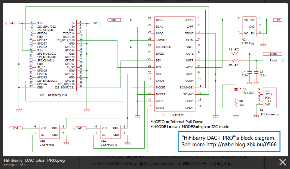

Maybe it can help, there is a schematics of I2S hifiberry DAC PRO for raspberry pi with 2 external clocks (depends of the frequency : 44.1 kHz or 48 kHz)
HiFiBerry DAC+ PRO????????? - nabe????
I guess this is the schematic you are referring. See the attached .png file.
X44 is a 44.1 kHz x 512 = 22.5792 MHz quartz oscillator with an enable pin.
X48 is a 48.0 kHz x 512 = 24.5760 MHz quartz oscillator with an enable pin.
They both feed the SCK pin (aka MCLK) of the PCM5122 DAC.
You may rely on something like this.

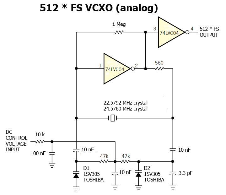

When your system must work in USB Audio Isochronous mode, the universal panacea is to rely on two discrete homemade inexpensive quartz-based oscillators (11.2896 MHz and 12.2880 MHz) divided by 4 (two D-type flip-flops) feeding the STM32F7 "Audio Clock In" aka I2S_CKIN, for clocking the SAI(SPDIFTX) at 3.0720 MHz (48 kHz FS) and 2.8224 MHz (44.1 kHz FS).
The oscillators must be discrete and homemade, in order the system to fine-tune their oscillation frequency using a Varicap diode.
Nowadays the Toshiba 1SV305 Varicap is widely available, kind of old days BB104, albeit requiring a lower voltage and featuring an improved capacitance ratio.
The 1SV305 Varicap datasheet is here : http://www.mouser.com/ds/2/408/DST_1SV305-TDE_EN_1341-736624.pdf
Such Varicap diode acts a variable 6 pF to 18 pF capacitor, depending on the reverse DC bias voltage that's applied on it. Using a STM32F7 PWM output and a 1 Hz lowpass filter, you will increase or decrease a DC voltage output, proportional to the buffer underrun / overflow trend. Such DC voltage to get amplified (min 1 VDC, max 4 VDC) and applied to the Varicap, as reverse bias voltage, for implementing a high-quality analog PLL, tracking the USB FS * 64.
No more a quick and dirty fix like dropping or repeating one audio sample from time to time.
No more a quick and dirty fix like increasing or decreasing the PLLSAI multiplication factor from time to time.
When your system must work in USB Audio Asynchronous mode, there is no need for a Varicap frequency control. In such modality, you need to set the STM32F7 PWM to some fixed value, that you determine using a frequency meter, for generating the exact nominal FS. Such frequency meter may be part of the STM32F7, using the built-in 16 MHz quartz (HSE) as timebase / gating and one of the many TIMER inputs (TIM1 ... TIM14) as hardware counter.

More about Voltage Controlled Xtal Oscillators (VCXO).
You can find them here :
22.5792 MHz : http://eu.mouser.com/Passive-Components/Frequency-Control-Timing-Devices/Oscillators/VCXO-Oscillators/_/N-7jdks?P=1z0wnr9
24.5760 MHz : http://eu.mouser.com/Passive-Components/Frequency-Control-Timing-Devices/Oscillators/VCXO-Oscillators/_/N-7jdks?P=1z0wnsv
Some VCXOs are analog, featuring a fundamental mode quartz inside that's loaded by varicap diodes. Look the Pletronics datasheet.
http://www.mouser.com/ds/2/326/vha6%203.3v-4748.pdf
They consume approx 5 mA from the power supply.
Attached is a .png of what's inside such Pletronics VCXO. Nothing complicated here.
Some VCXOs are digital, relying on a DSPLL clock synthesis, featuring a fixed frequency quartz inside followed by a Direct Digital Synthesis. Look the Silicon Labs datasheet.
http://www.mouser.com/ds/2/368/Si552-52721.pdf
They consume approx 100 mA from the power supply.
My preference goes to the analog variety (Pletronics).

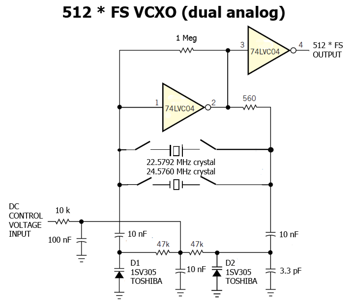

One may rely on a 74LVC4066 quad bilateral analog switch, for selecting the quartz that's actually connecting to the oscillator circuitry. Only one oscillator circuitry.This would be simple and elegant. Look the datasheet.
http://www.mouser.com/ds/2/302/74LVC4066-839854.pdf
Attached is a .png of what could be a '"dual analog" VCXO relying on a 74LVC4066 quad bilateral analog switch.
Steph
