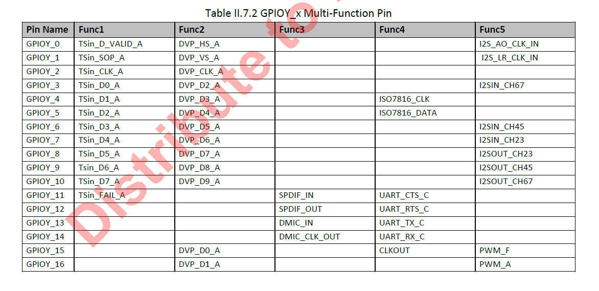

ODROID C2 is not so expensive and can output 2 I2S it means 4 channels.
The ARM CPU is capable of 7.1 I2S OUT unfortunately there is no implementation 🙁

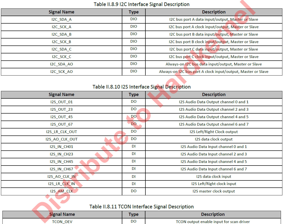

2 I2S ports are exposed (I asked Hardkernel in its forum) that allows 4 channels.
I am not sure, but I think linux drivers can drive 2 I2S instead 1. I didn't investigate.
ODROID C2 Amlogic S905 is capable of 8 x I2S-out.
Indeed. In the absence of a proper 256 x Fs clock input dedicated to audio, in case the Amlogic S905 works as master audio clock, it should generate a lot of jitter and possibly remain unable to generate exact audio clocks because of relying on its CPU quartz and PLL.
A proper audio use of the Amlogic S905 would consist of defining it as slave what's regarding the audio clock. The Amlogic S905 would read the left/right clock and data clock, that are provided by a 8-channel DAC acting as master audio clock. A high quality quartz oscillator would provide the 256 x Fc MCLK to such DAC. The 8-channel DAC would output the left/right clock and data clock to the Amlogic S905.
What's regarding the audio input, the Amlogic S905 can act as async USB audio soundcard, in plain stereo.
Considering what's above, one should not use the Amlogic S905 as SPDIF receiver. The SPDIF clock that's imposed will always differ from the local 256 x Fs quartz. A possibility is to rely on a ASRC for resolving the clock conflict.
In case you don't want to mess with some ODROID C2 audio shield hosting a 256 x Fs clock and 8-channel DAC, there is always the possibility to output the 8-channel audio through USB. Simply hook a 8-channel USB2 sound card like the ASUS Xonar U7, and you are done.

Great stuff. Thanks for the indications. I'm glad to see somebody confirming the precautions one must take, when using SBCs for qualitative audio. I'm glad to hear that one can configure a ODROID C2 SBC as I2S slave (audio clock slave).
Before going to much out of thread (we are supposed to deal with STM32 microcontrollers), can you please describe your sound reproduction arrangement, and tell us if there is a possibility for implementing a stereo 2-way crossover, in case one can exploit the two I2S channels that are exposed.
By the way, I am in search of somebody able to exploit the Func5 feature, for exposing the remaining two I2S channels, for outputting 8-channel audio. See the attached pictures.
