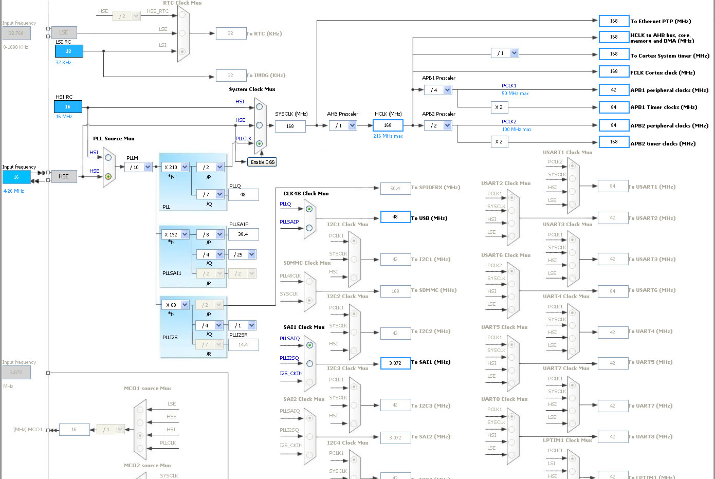

Next stage is to set-up the USB audio class input, to get the full chain blocks. How to build an external audio clock for clean SPDIF or I2S clock (components/schematics/implementation or product)?
The SAI(in SPDIF TX protocol) requires a 256 x Fs clock divided by 4.
Which means for 48 kHz : 256 x 48 kHz (12.288 MHz) divided by 4 = 3.072 MHz.
USB Audio-isochronous : the USB is the audio master clock. Unfortunately it is of poor quality. Look the PCM2702 datasheet here : http://www.ti.com/lit/ds/symlink/pcm2702.pdf. As you can see, the USB writes data into a FIFO that gets read by a PLL whose frequency is managed in such a way that it corresponds to the USB audio frequency, only in the long term. Kind of smoothing and filtering. You can emulate this using a STM32F7, by realtime altering the PLL multiplier (in +1 or -1 discrete changes) that's in charge of generating the SAI(SPDIF) clock. Your criterion for speeding up / leaving intact / slowing down the SAI(SPDIF) clock, is the analysis of FIFO underrun trend / FIFO overflow trend in the long term. Be warned that in case the USB audio frequency is significantly departing from 44.1 kHz or 48 kHz, the SPDIF receivers connecting to your SAI(SPDIF) won't synchronize. On the other hand, rest assured that in case the machine that's generating the USB Audio-isochronous is decent, you won't get issues.
Here is the STMCubeMX sketch corresponding to this :
- 16 MHz quartz CPU clock (for precision)
- HSE clock selection
- PLLM / 10
- PLLN * 210
- PLLP / 2
- PLLQ /7 for getting the 48 MHz that's required for USB
- PLLCLK clock selection
- SYSCLK = 168 MHz (max is 216 MHz for the STM32F7)
- PLLSAI *192 (this is the one to be decremented by 1 or incremented by 1, acting as long term PLL)
- PLLSAIQ /4
- PLLSAIQDIV /25 for getting the 3.072 MHz that's required for 48 kHz audio on SAI(SPDIF)
- PLLSAIA as SAI1 audio clock source

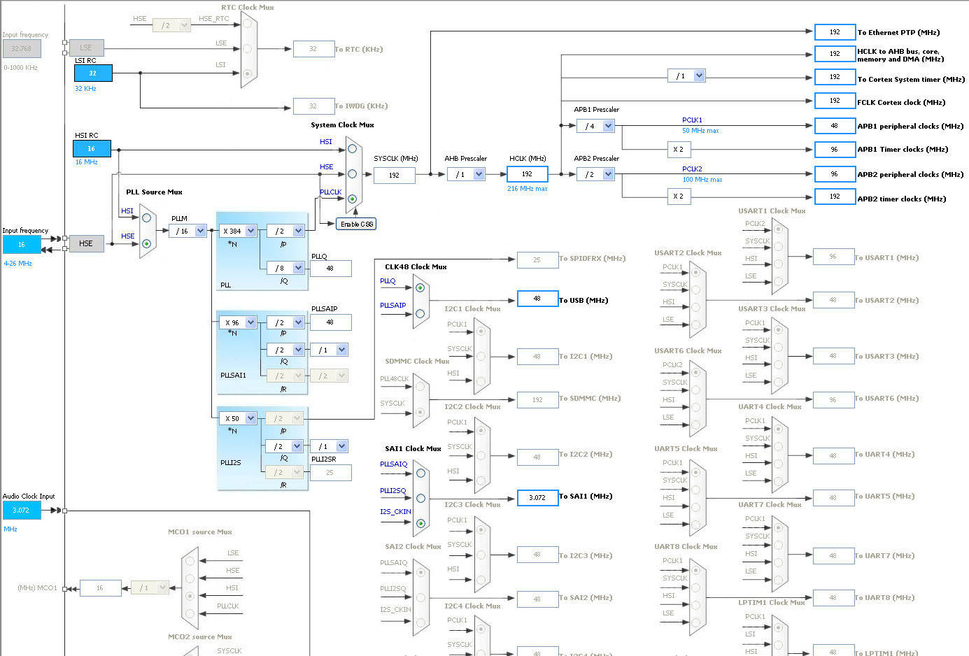

USB Audio-async : your SPDIF transmitter(s) shall act as audio clock master, explicitly requesting audio packets over USB. Your "audio shield" must feature the local high quality audio clock, 44.1 kHz or 48 kHz or both. There are 256 x Fs oscillators available, with an enable pin. As stated above, you need to divide the 256 x Fs clock by four, before applying it to the "Audio Clock Input" pin of the STM32F7.
- PLLM / 16
- PLLN * 384
- PLLP / 2
- PLLQ /8 for getting the 48 MHz that's required for USB
- SYSCLK = 192 MHz (max is 216 MHz for the STM32F7)
- a 12.288 MHz quartz / 4 = 3.072 MHz clock on the "Audio Clock Input" pin of the STM32F7
- I2S_CKIN as SAI1 audio clock source
Have a look to the attached files. The .ioc files are the STMCubeMX files. Double click on them and STM32CubeMX will start and load them.
Steph
