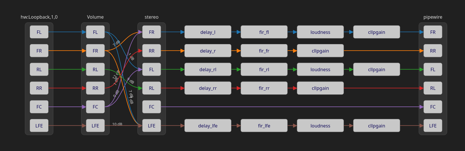

Posting my setup for 2.0 to 5.1, no upmixing. Used both as a home theater (MLP):

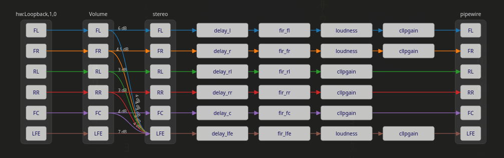

and for playing games or computer work (2nd listening position, at the keyboard, 90 degrees left of MLP). Center speaker not used in this situation and its signal, whenever present, is being centered between the new front speakers. In case you wonder why so different gains for the new front speakers, I'm sitting 3-4x closer to the left one:
Hope that makes sense. In case you wonder why positive gains, I loose 9 dB with REW FIR filters. HPF for satellites and LPF for subwoofer are handled by the FIR filters. Still work in progress, but you get the idea.
The labels are very useful. It can get pretty confusing with numbers.
