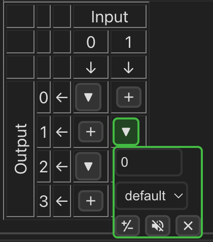

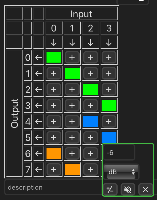

The prototype I posted above puts all the controls in each cell. I think it's nice to be able to see all of them, but the downside is that each cell gets quite big. An alternative could be to do like in the Motu app, and just have a small colored square showing if it's active or not. Then clicking it could open a dropdown with the controls.

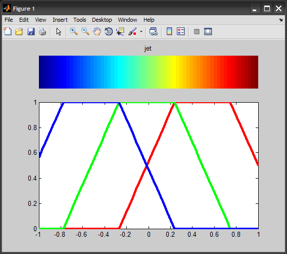

Motu seems to use just blue to show the status, but it would be possible to let the color indicate the gain, using a scale such as this:

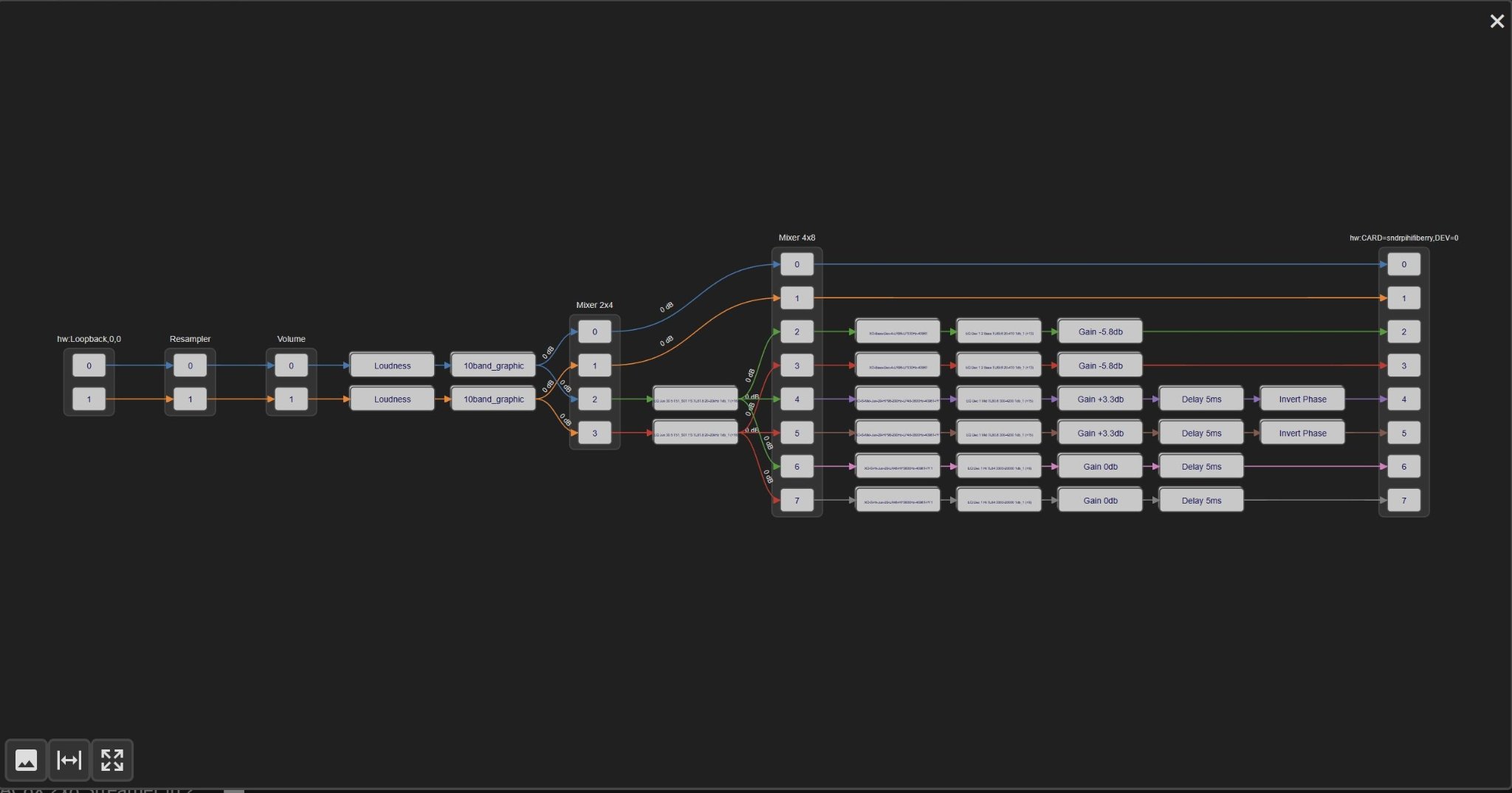

I agree with Michael that the pipeline flow diagram makes it easy to visualise. For instance when I was building the attached pipeline I was going back and forward between config of the mixers, pipeline flow diagram and config of the pipeline until it made sense.
Which reminds me Henrik, could you add to the top of the Pipeline tab display, the icon to add a step and the icon to display the pipeline. That would save having to scroll down to the bottom, and if a step is added using the add step icon at the top, then place the new step at the top and require it to be "downed" rather than "upped" from the bottom. Would be especially good for adding an input filter to a long config.

The existing mixer ui works, but it has some issues:
  • difficult to see what a mixer does, you need to plot the pipeline to see it. Especially for a mixer with many input and output channels, when it becomes quite large.
  • it allows defining some weird mixers, like having two mappings with the same destination channel, or the same source twice in a mapping. This is technically allowed but is more confusing than useful.
  • it's clunky to select both source and destination channel in numeric fields (and this doesn't work well with channel labels)
