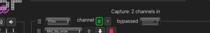

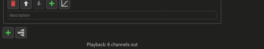

In the Pipeline tab there is a heading "Capture: 2 channels in" but there is no e.g. Playback: 4 channels out
For the sake of symmetry and completeness 😉 I suppose it should be placed just above the mixer that feeds the playback device.
Also, an arrow pointing downwards would help to understand how the pipeline page shall be interpreted i.e. indicating the process direction.

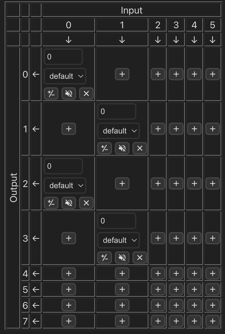

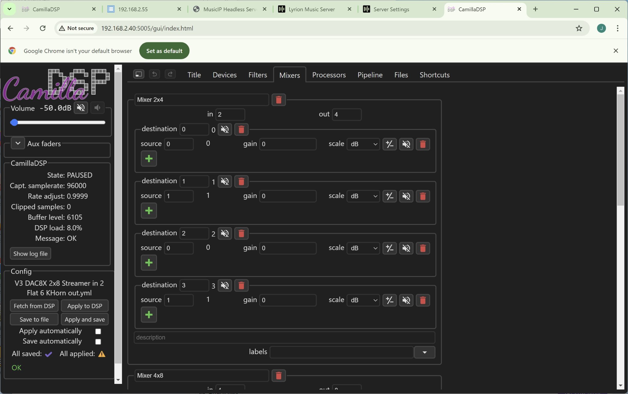

I'm not really happy with the UI for defining mixers. It's very difficult to see what goes where. It's quite common to use a matrix layout for this kind of thing, and I made a prototype of how that could look in CamillaGUI:
It needs some colours to make active cells more visible etc. What do you think, could be better than the existing UI?
