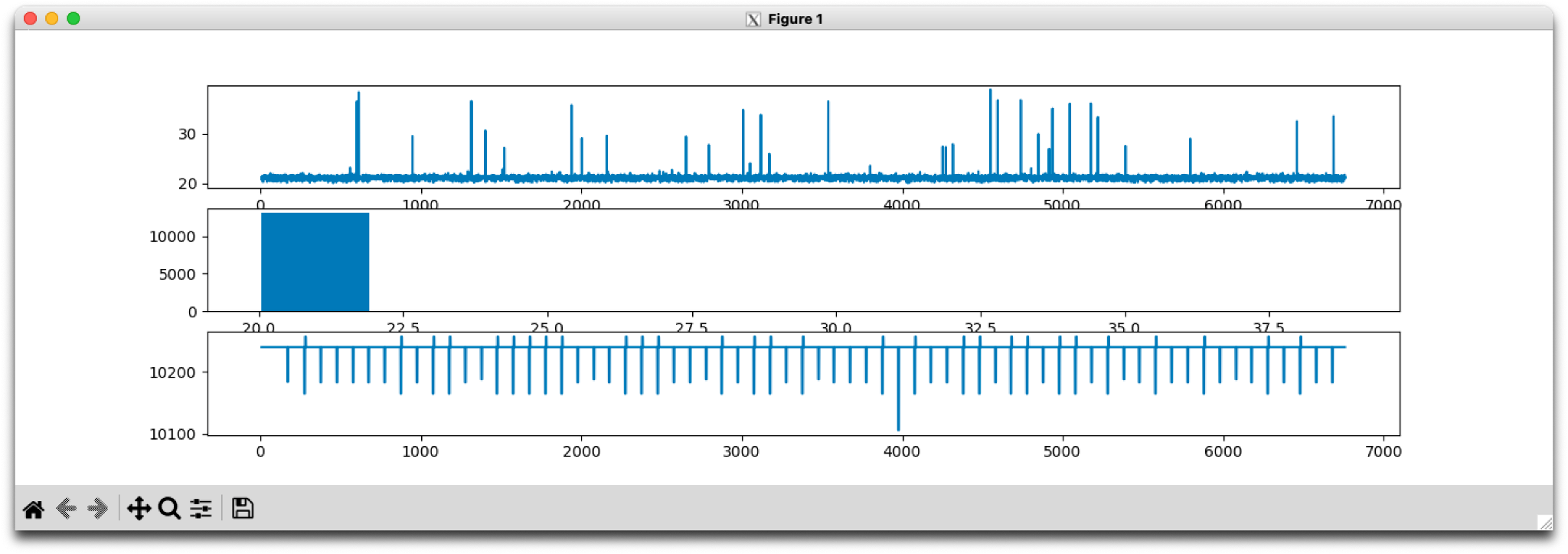

On v3, I'm getting XRUN's on the Loopback Capture. This was discussed briefly in another thread.
@phofman and @HenrikEnquist I'm attaching tracelogs, config, and graph of testscripts/log_load_and_level.py.
With chunksize=2k, target_level=6k I observe capture overruns, followed by playback underruns.
I'm using next30 and have merged the skip_instead_of__block branch.
Increasing chunksize to 4k (and target_level to 12k) doesn't help - the same behaviour is observed.
In the trace log , have a look around lines 518 and 65399 where the "Capture: read overrun, trying to recover. Error: ALSA function 'snd_pcm_readi' failed with error 'Broken pipe (32)'" error is reported.
Any suggestions welcome, I'm starting to go a bit crazy.

@siraaris : IMO the actual period size of half the buffer and twice the chunksize may not work reliably. Things like this do happen when many channels are used, the drivers often have limits which start showing up at these situations. That's why I always keep asking what the actual hw params are being used, not just what are those requested by CDSP.

The trace log is important, but unfortunately since it's not complete (snipped in the middle), it does not show why at the beginning the capture loop spent about 20ms waiting for data (which is exactly what 2048 frames at 96kHz last) but in the second part after snip the capture loop spends only microsecs (i.e. the capture buffer is getting fuller and fuller, eventually ending with overrun). Grep the log for "Capture waited for Some" to see what I mean.

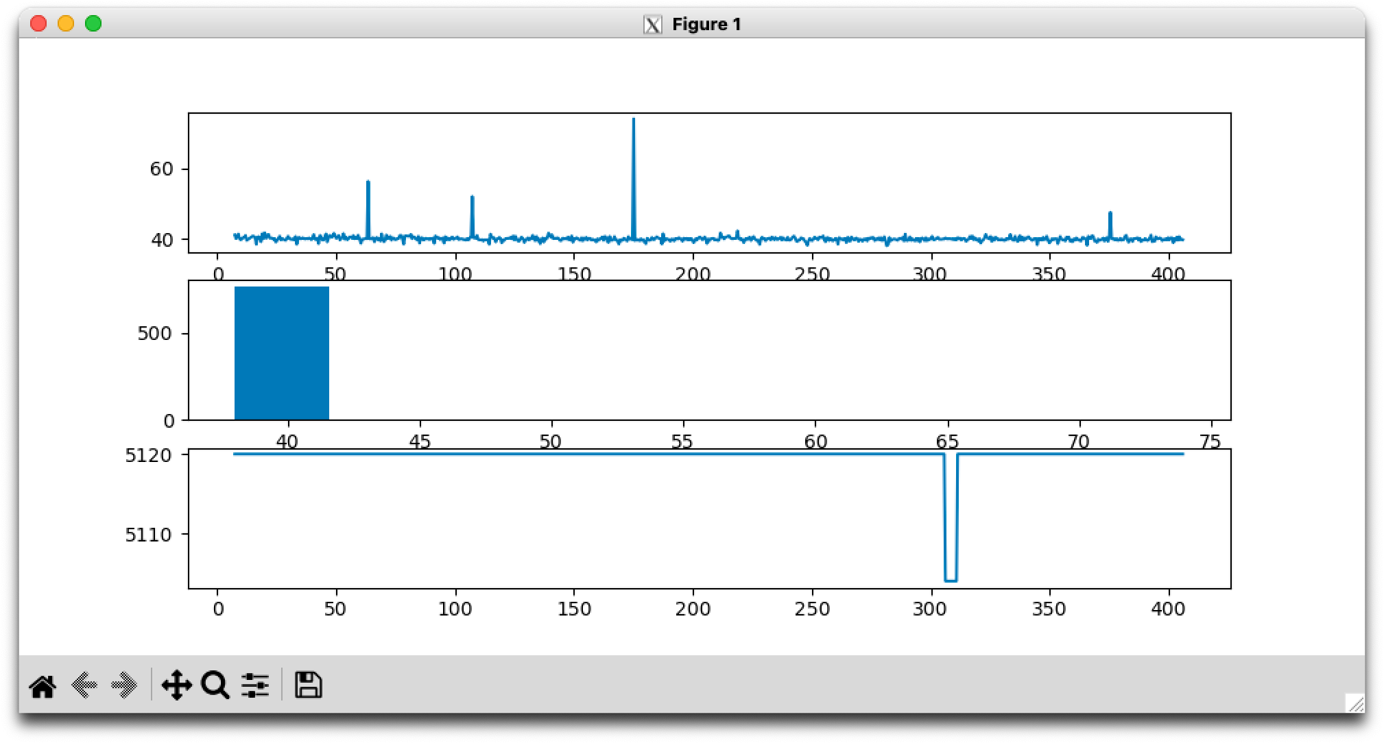

It's what I've noted when attempting to set the period size manually. I'm just running an instance of CDSP where there is a periodic capture issue. Capture issues occur roughly every 1m40s.
I have not been able to idenfity a process or job as cause. Any ideas?
