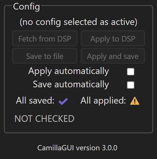

I changed it to only show the GUI version:

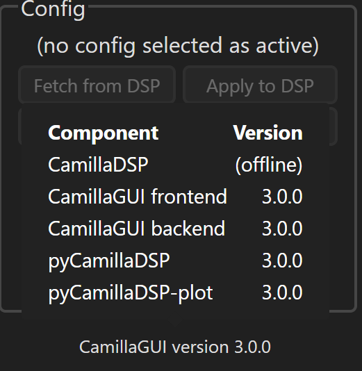

And when you hover over that, it shows all of them:

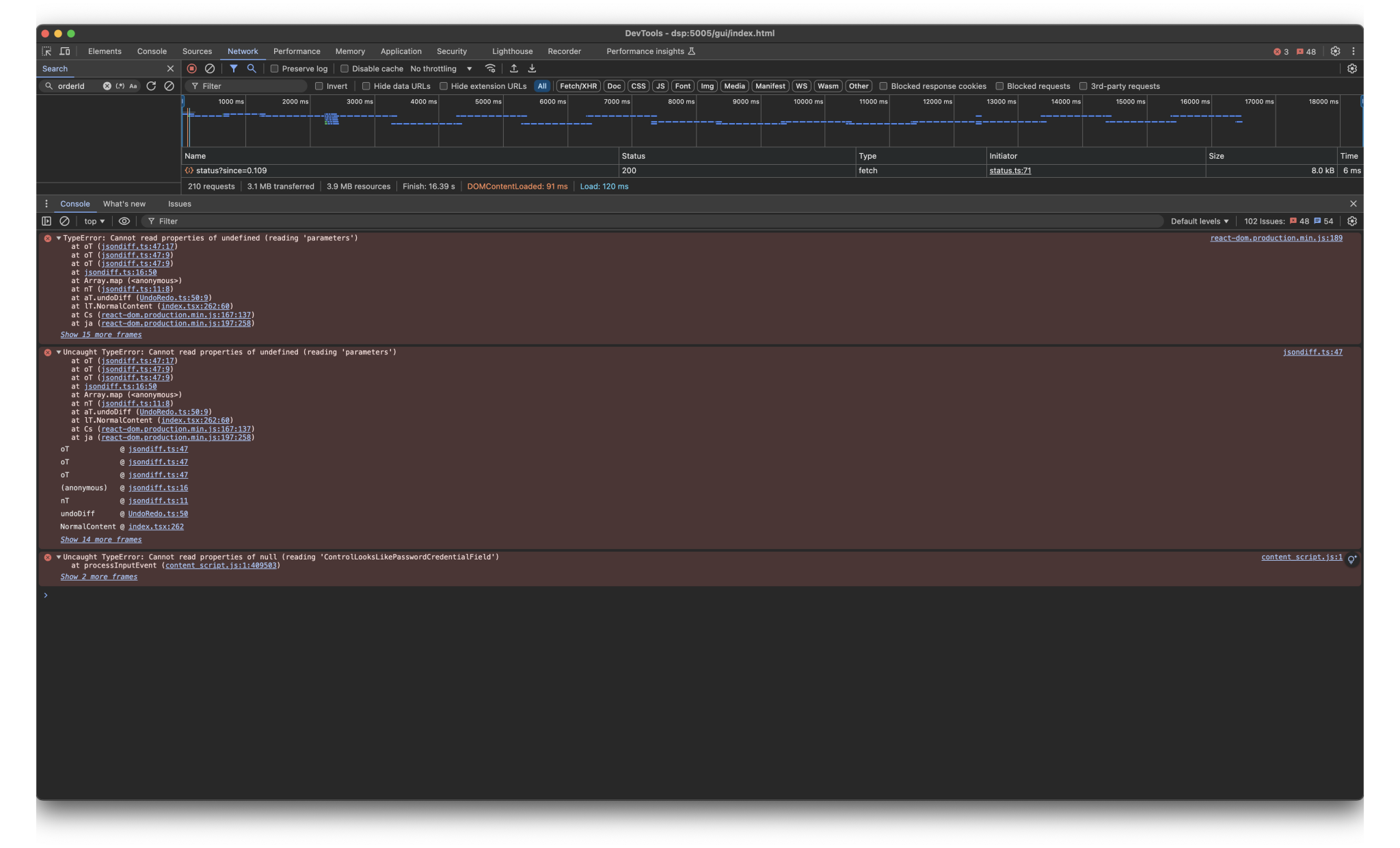

I am facing an issue with camilladsp-gui. When changing a parameter of a filter (like the gain or frequency), sometimes the screen goes blank and a javascript error is thrown in the console. Any unsaved changes in the config are lost when I hit command-R to reload the page.
I am using what I think are the latest stable releases:

This is a new issue! But there is a good chance that it's already solved in the upcoming 3.0 release.
There is nothing strange in your config file that should cause trouble. Can you find a way to reliably trigger the issue? A list of steps would be great, like 1) create new blank config, 2) add a filter of type Highpass, 3) Click the + button.... etc etc until crash.

When you delete the dot, instantly the screen goes blank with the javascript error described in my previous post.

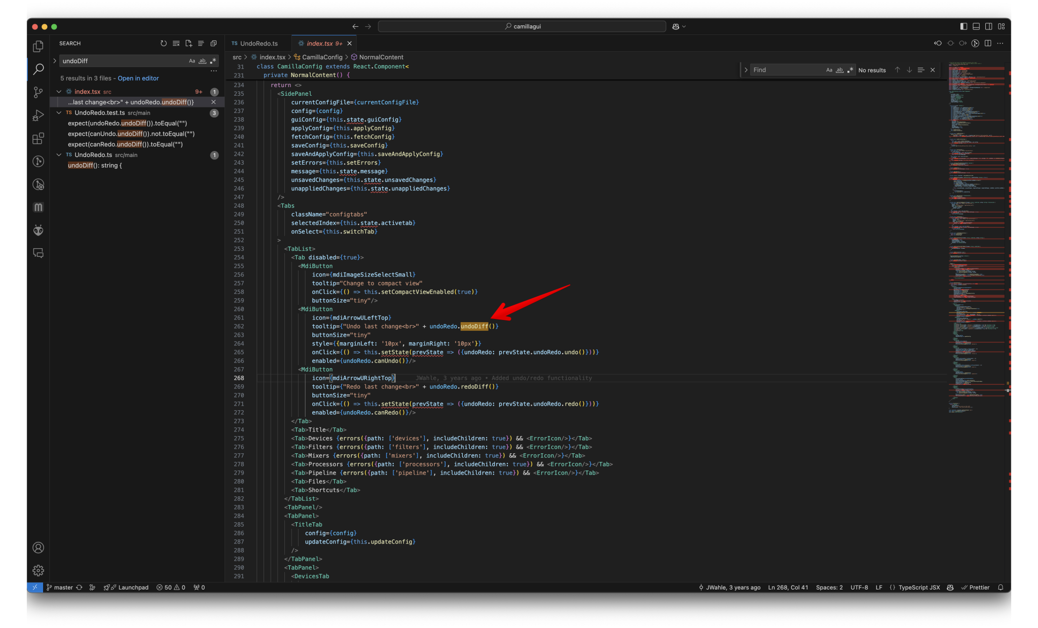

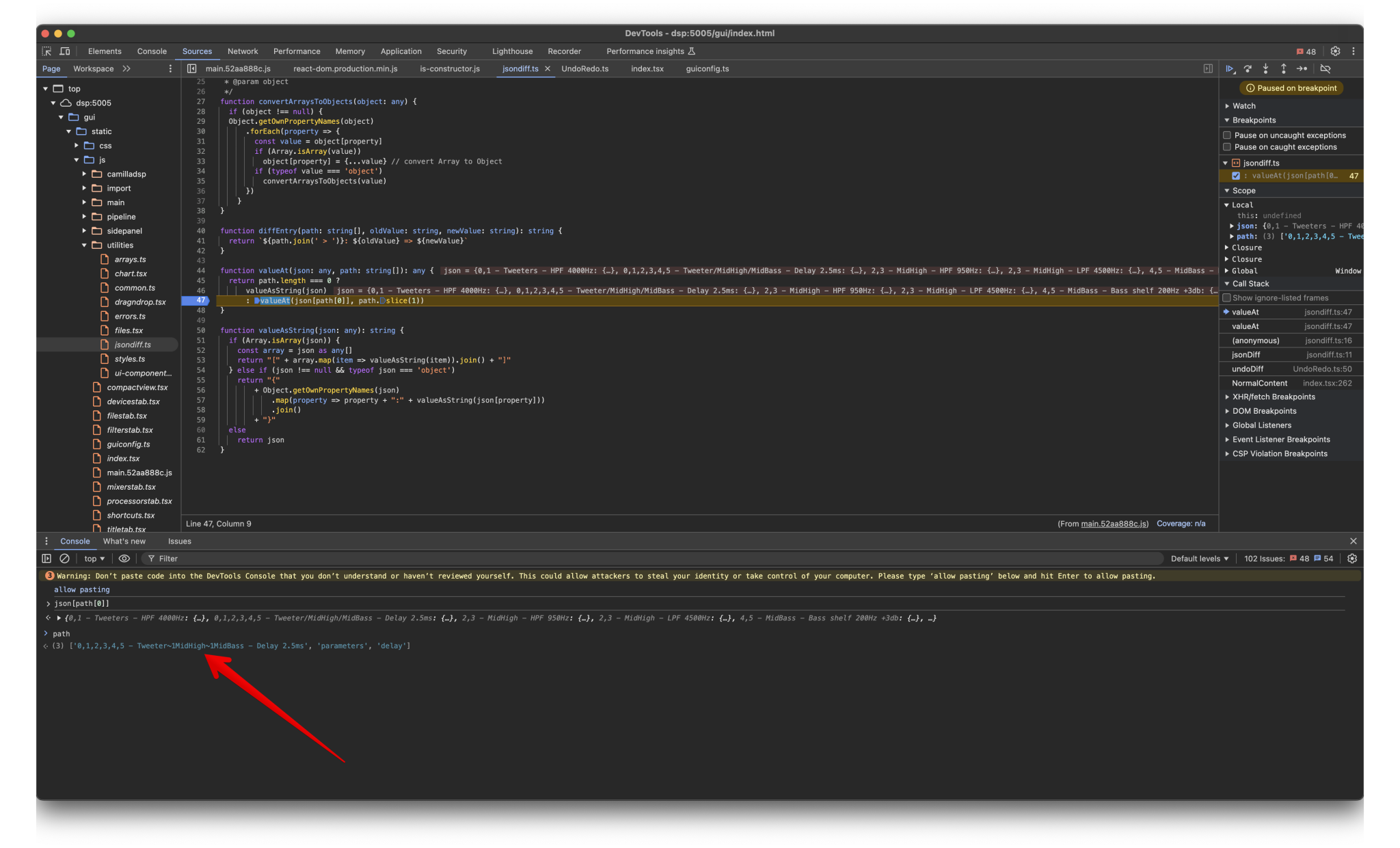

I debugged a little bit and found out that the error is within undoDiff function in UndoRedo class. When this function calls jsonDiff, it throws the error.
In order to avoid this issue I edited index.tsx and removed the call to undoDiff function. Of course this is not a solution, but at least the error isn't happening anymore.
Please let me know if you were able to reproduce the error. If not, feel free to ask for any help - I can change the code, adding a few debug messages, so we can understand exactly what is triggering the error.
Henrik, I guess I just found the error:
Look at how the filter name gets to this method. This "~1" is actually a "/" (slash) in my config. Apparently there is some sort of encoding that is messing up with the filter's name.
I renamed the filter to use dashes instead of slashes and the error is not hapenning anymore.
Got it! Thanks for investigating! The json diff library returns the path with / and ~ escaped as ~1 and ~0 and I did not handle that. I have fixed it for the 3.0 release now.

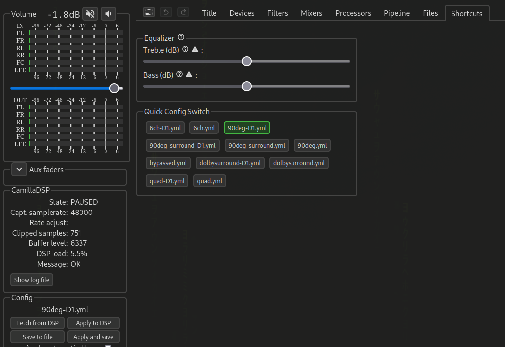

Here is my setup on linux. It's similar on Windows 7
6ch is for normal 2-6 ch use. dolbysurround is self explicit for 2 ch use. quad is also self explicit. They all use the main speakers on the front wall.
The 90deg variations are used when the main channels are on the left wall, using RL and FL as main speakers and RR and FR as surround speakers.
The D1 variations are using new IR filters created for that new sound card.
