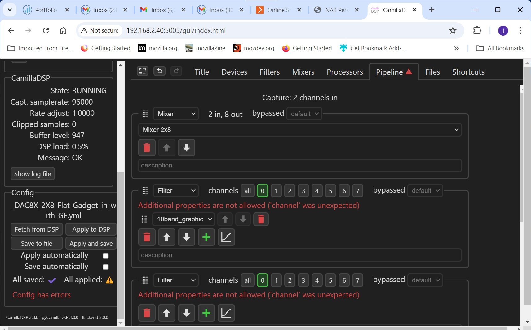

Ok great that it works now. Looks like I forgot to update the version number in pycamillasdsp-plot so it still thinks it is 2.0.0.
Not sure what was going on with the setup which gave me issues, I think I might have forgot to restart my camillagui service after installing the GUI. I updated another install to V3 without issue.
I needed to work out was the new pycamilladsp volume / mute nomenclature for my OLED / FLIRC scripts, but that was pretty simple.
The only odd thing I've noticed is channel assignment of filters in pipeline has some issues. I've been playing around with simple bass / treble filters on my input channels and noticed that if I switch tabs or refresh my browser the assignment appears to go away in the GUI. This doesn't seem to happen in reality as the assignment is still in my configuration file and will re-appear if I use the Fetch from DSP button. However, if the assignment disappears in the GUI (say I am making a change in another tab for example) and then I apply and save that configuration, the assignment is lost.

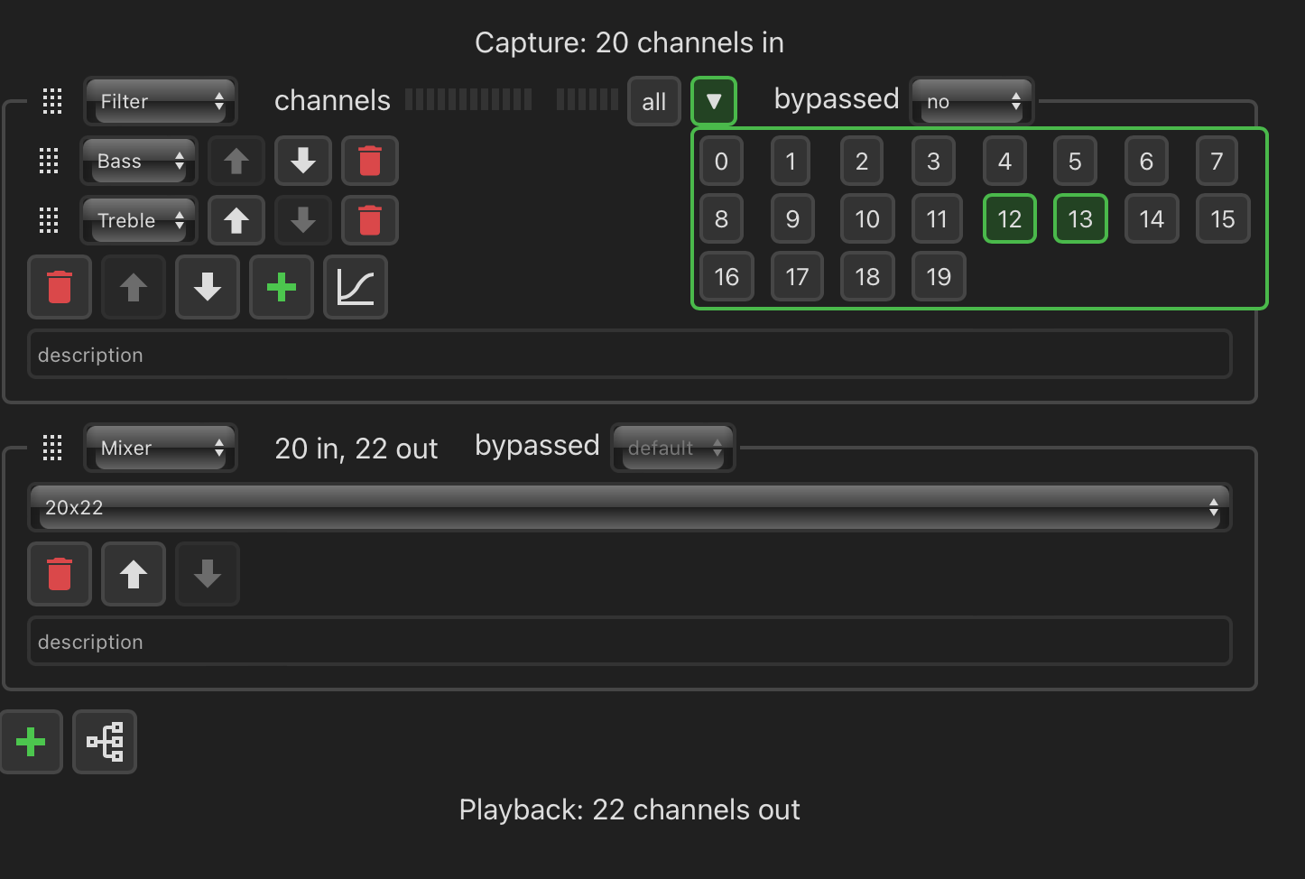

I'm trying to reproduce the issue with channel assignments but don't manage. Can you give a list of clear steps I can follow to see it?
I have my configuration loaded in to GUI and marked as active.
Moving to Pipeline, I apply Bass and Treble filters on channels 12 and 13, I click Apply and save. I can use the Bass / Treble controls and they clearly work.

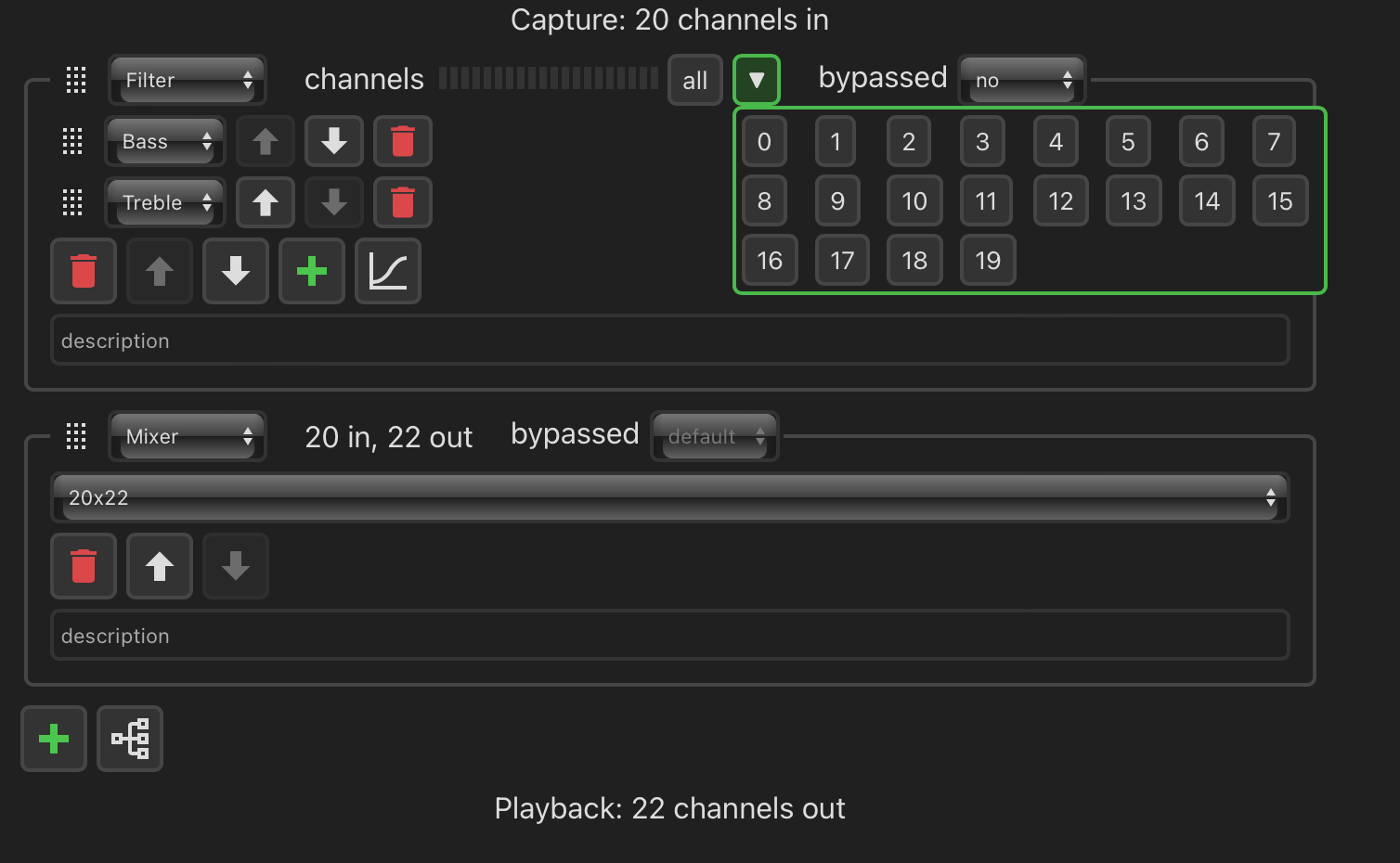

Now if I navigate to say the Filters and then back to Pipeline, channels 12 and 13 are no longer selected. If I click Apply and save, the configuration saves like it shows in the GUI and the Bass / Treble filters no longer work.
I've attached my configuration both when it is correct and when the assignment has been removed. I've observed the same behavior on Safari and Chrome on a 2015 Mac book pro running Monterey.

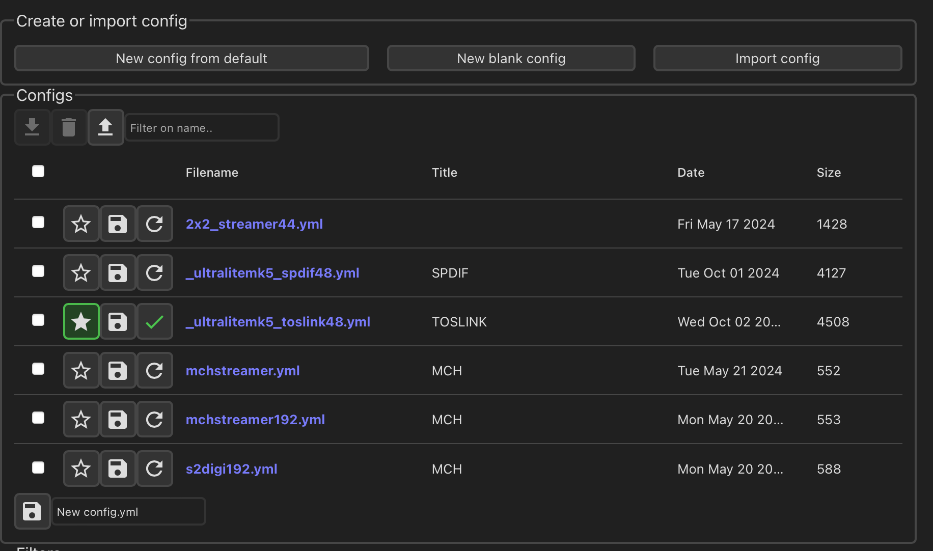

Those fields are quite new, they were added in v2.0. Many examples are older than that, so they don't have them (but the fields are optional so the files are still valid).I had no title or description in my files... up to add a comment (starting by #) on top of my files. Why so many files without them?

Understood. Excellent improvement. I use them to select the files. Very useful also in the GUI.Title and comments : Those fields are quite new, they were added in v2.0. Many examples are older than that, so they don't have them (but the fields are optional so the files are still valid).
