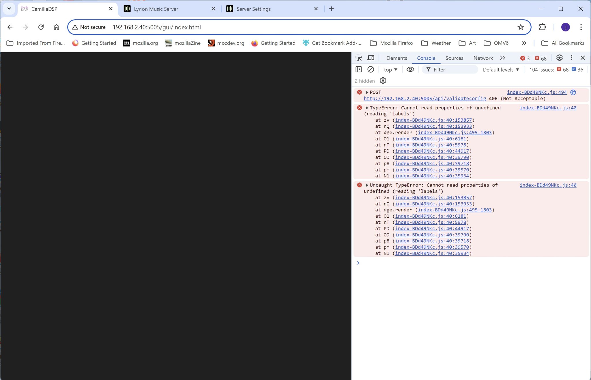

Henrik, I have converted some v2 configs to v3 and they work fine. However I have a config that is causing me grief. I tried converting it in full but when in the "pipeline" tab and I add a mixer I get a blank screen.
So, I have zipped up the config and coeffs directories and offer these to you as real world test data from the great unwashed user land down under.
The config that is causing trouble is "DAC8X Streamer In 2 flat 6K-Horn out.yml" that I have converted to "V3 DAC8X Streamer in 2 Flat 6 K-Horn out.yml". CamillaDSP is running on a RPi 5.
@Wirrunna I'm playing around with your files but I have not been able to reproduce the problem. Can you try to trigger it with the browser console open? There could be some useful error message. Also check the logs from the backend. You will likely see something there with "KeyError: 'ramp_time'". Just ignore that one. I have fixed it but it should not be able to cause the issue you describe.

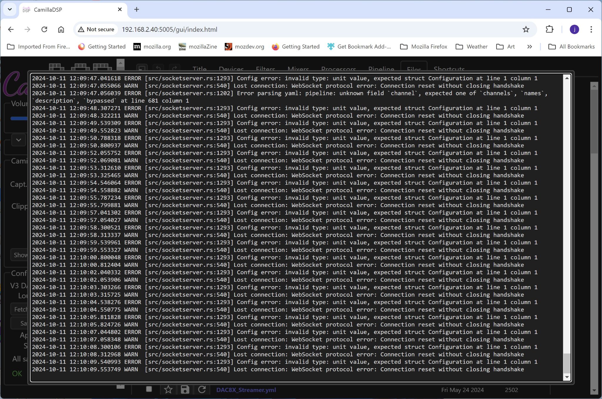

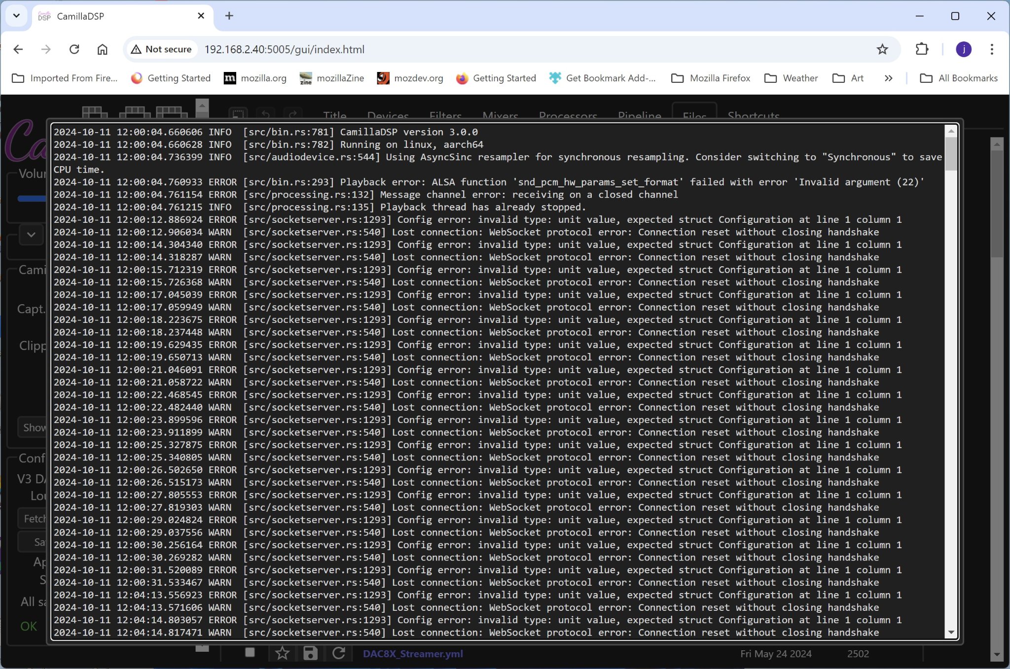

The log file screen is attached as two jpgs.
If I use the RPi 5 running CamillaDSP with HDMI 10.1" attached screen, USB keyboard/mouse and Chromium browser, GUI 127.0.0.1:5005/gui/index.html

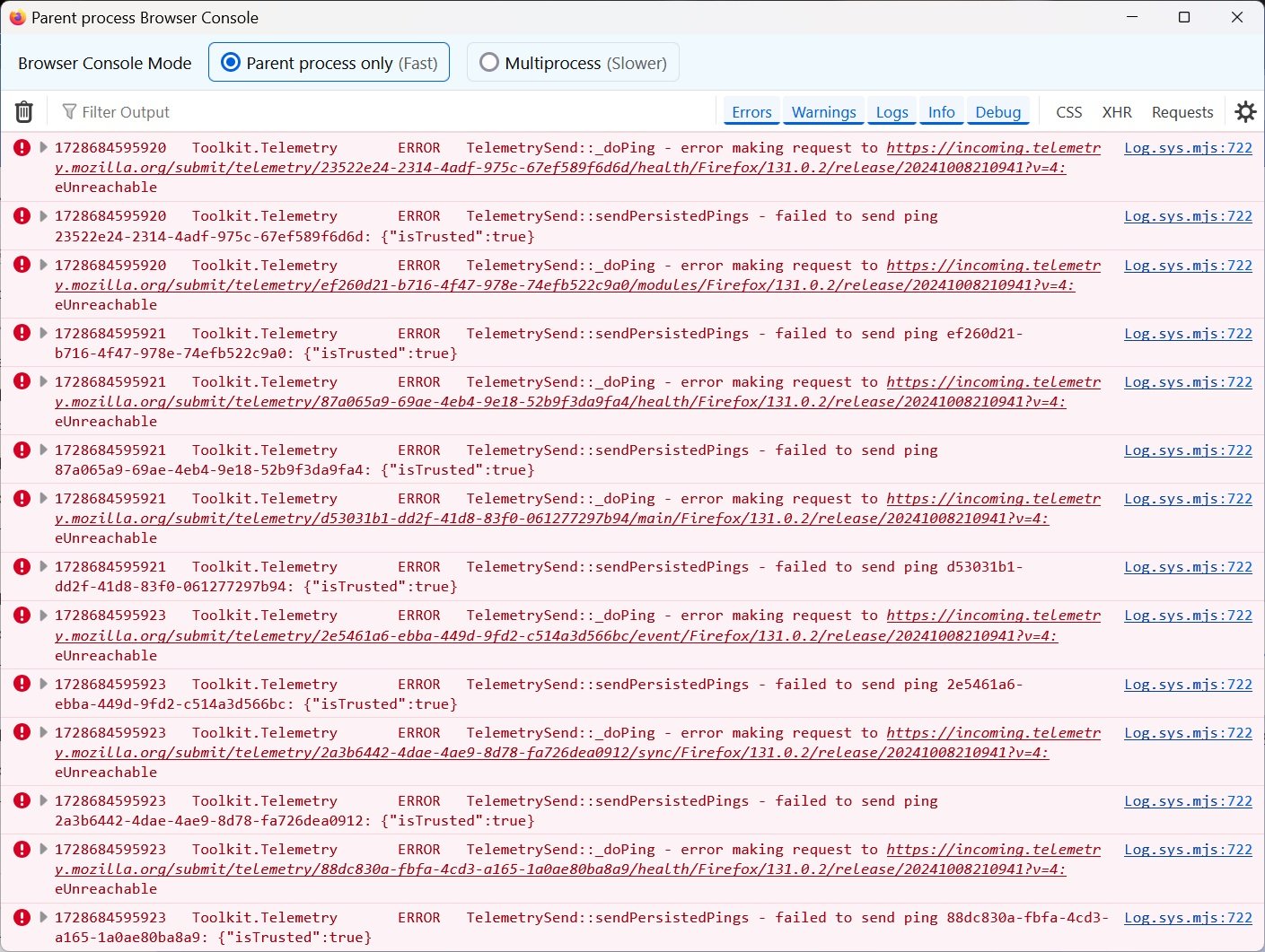

Open the console, then follow the steps to get the blank page, and see if there are any errors in the console.

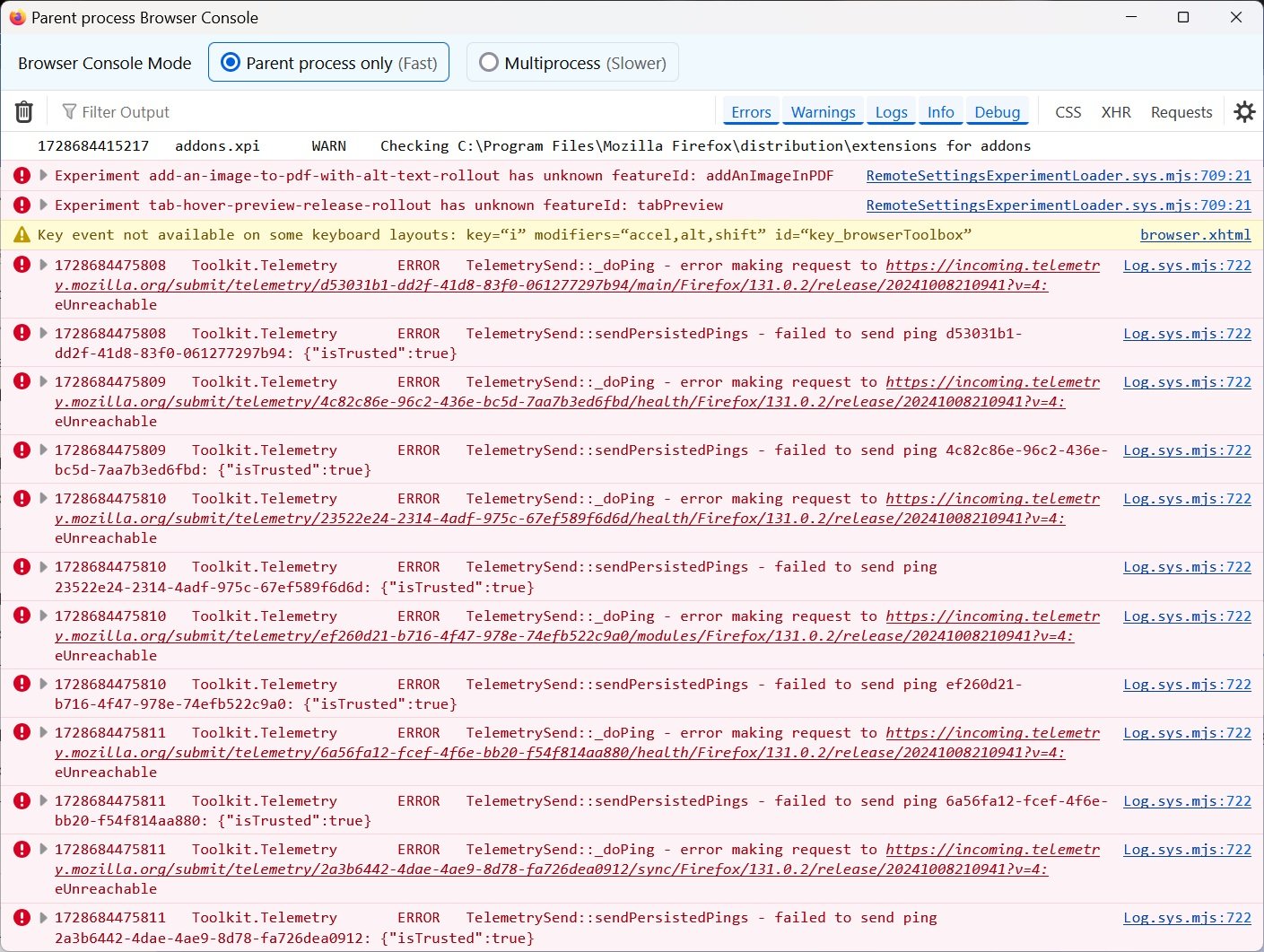

Henrik, here are the errors, but this is a distraction. Somewhere we should document the procedure to convert a V1 or V2 config to V3 -
Never mind, I managed to trigger the problem myself. New gui version (hopefully) soon!
That's a relief, I was going mad trying to get the browser JavaScript console. It is only a nuisance if you haven't saved a converted config before you go to the pipeline tab.

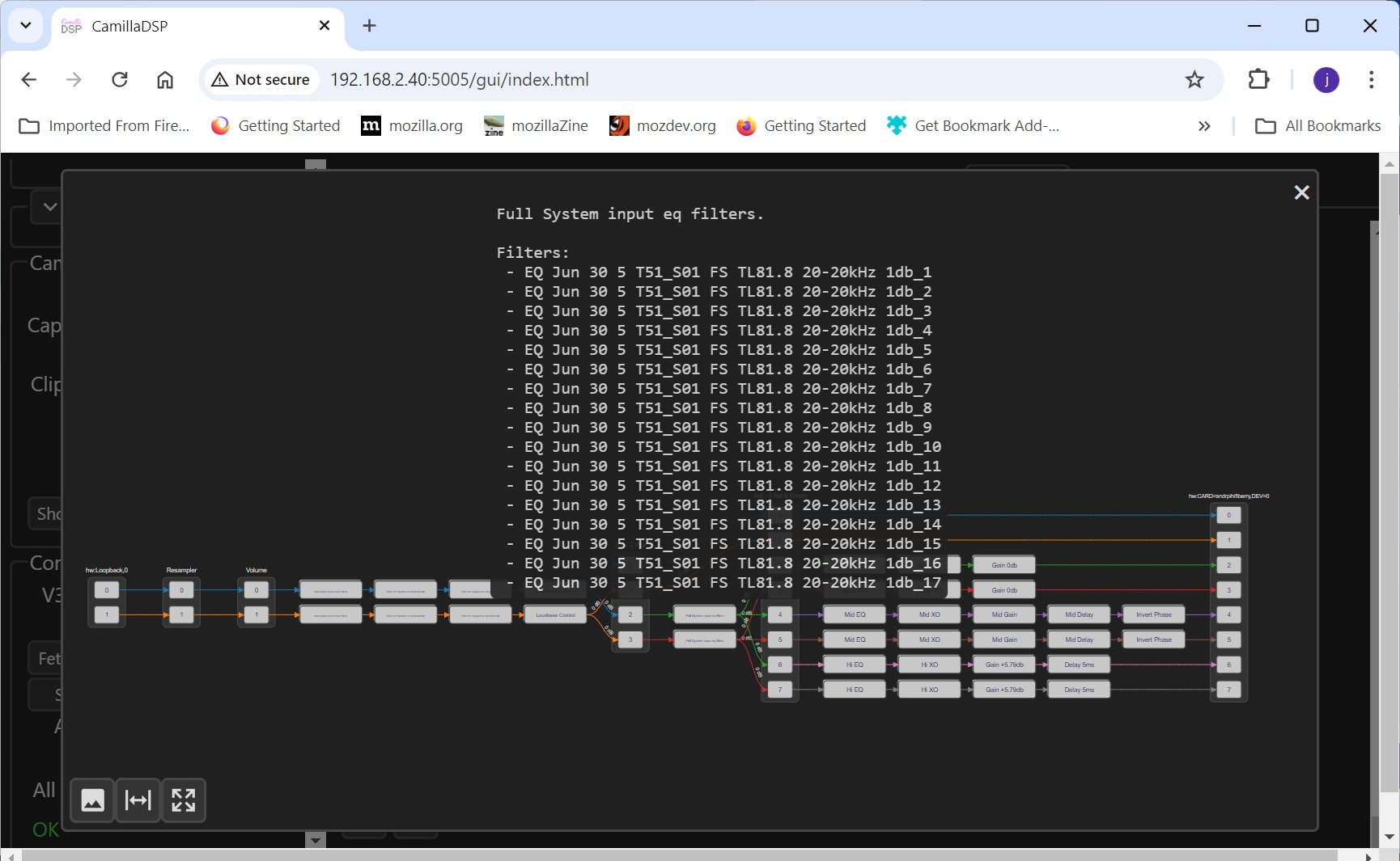

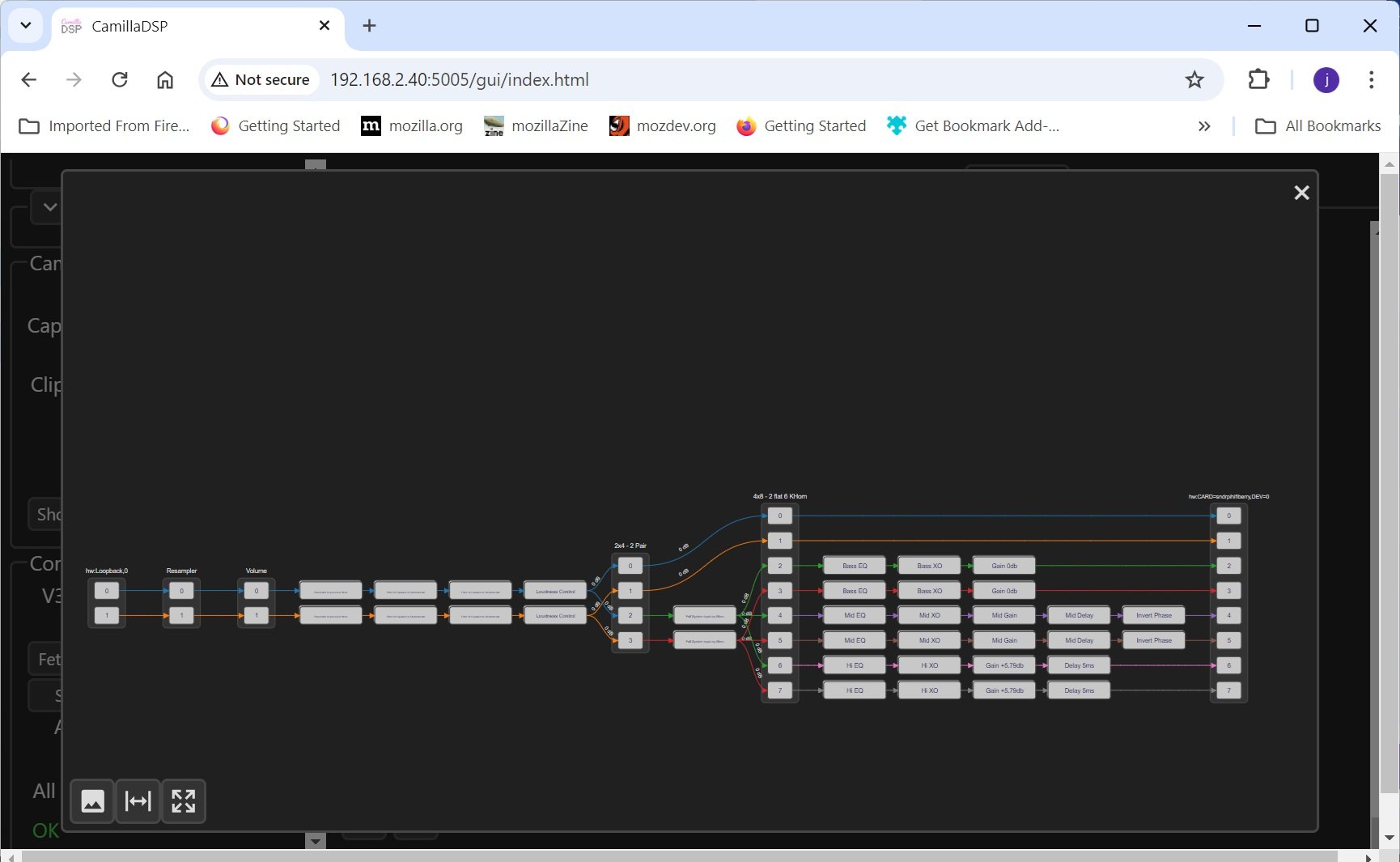

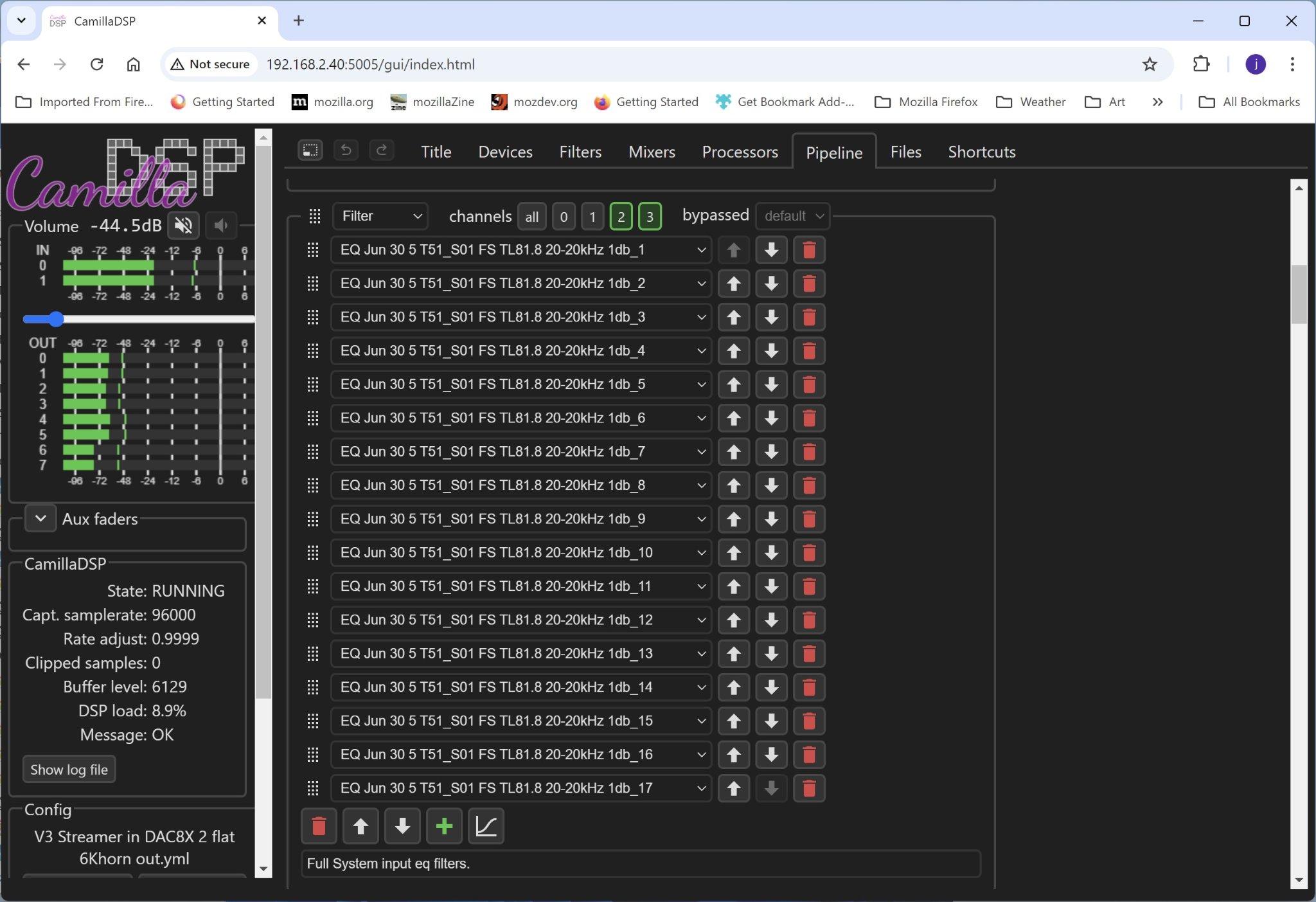

The pipeline plot in V3 - I do like the popup information when the mouse pointer is hovered over a step, made me go back to the Filters tab and fill in the description info for those with none. Pics show a plot with individual filters collapsed into a filter step, then when mouse pointer is hovered over a step the popup info shows the steps.

When one use REW to generate PEQs they get the same name + a digit - perhaps grouping all PEQs in one pipeline symbol if starting with the same characters?

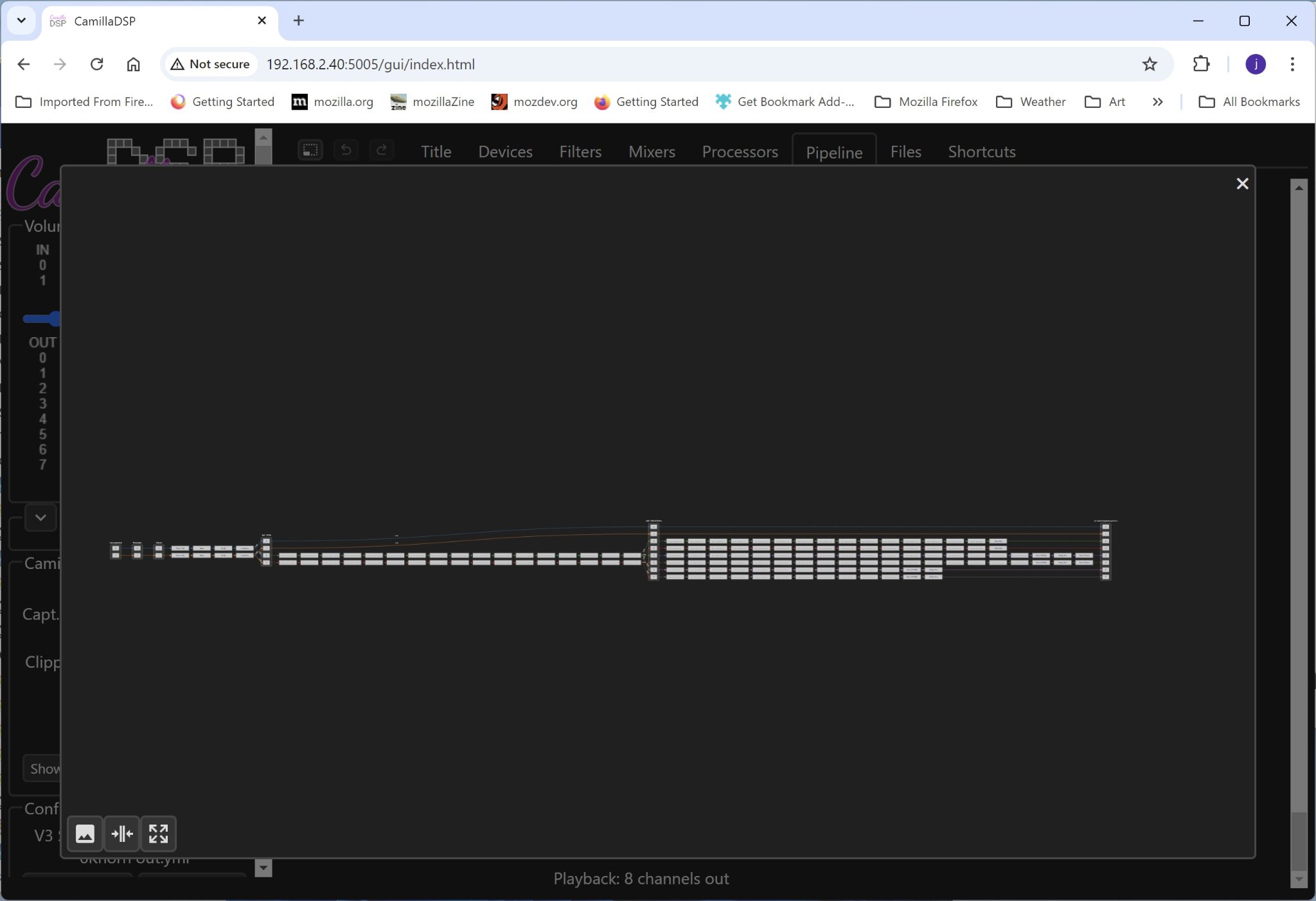

TNT , First pic below is the group of REW generated PEQs, second pic is the pipeline plot showing all the individual PEQs, then in my post above yours, the pic titled config Plot is the Pipeline plot after clicking the "Collapse individual filters into filter steps" icon. The last pic "Config plot showing info" shows as a popup the individual filters.
So Henrik is doing what you are suggesting.

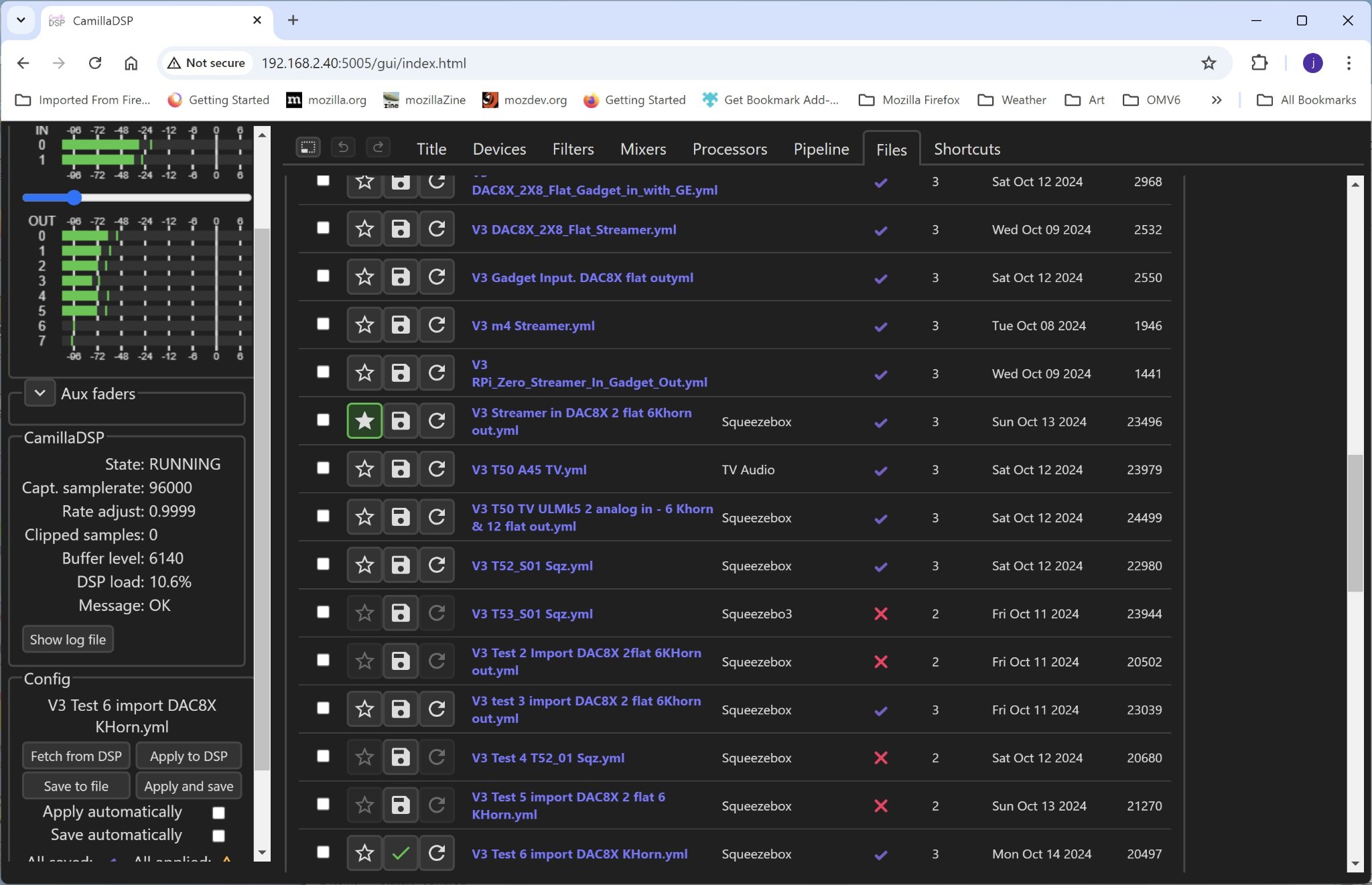

Henrik, Just tried beta 3 converting a V2 config and it worked perfectly. A converted config is playing now, the pipeline conversion worked this time.
The Valid and Version columns in the Files tab are a good enhancement, as is the ability to zoom the plot with the mouse wheel.

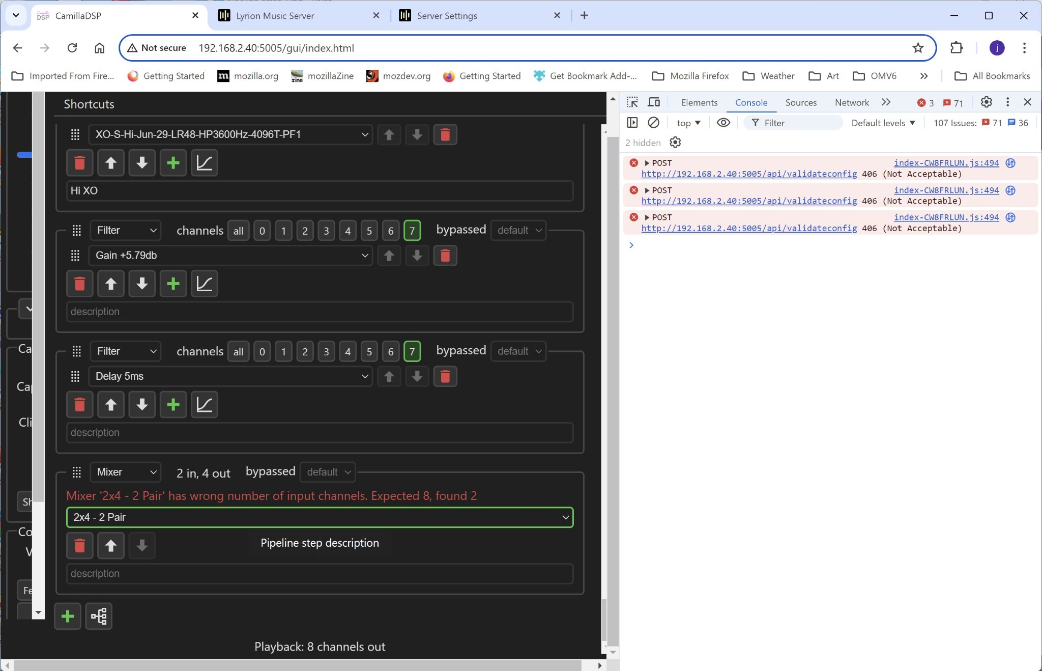

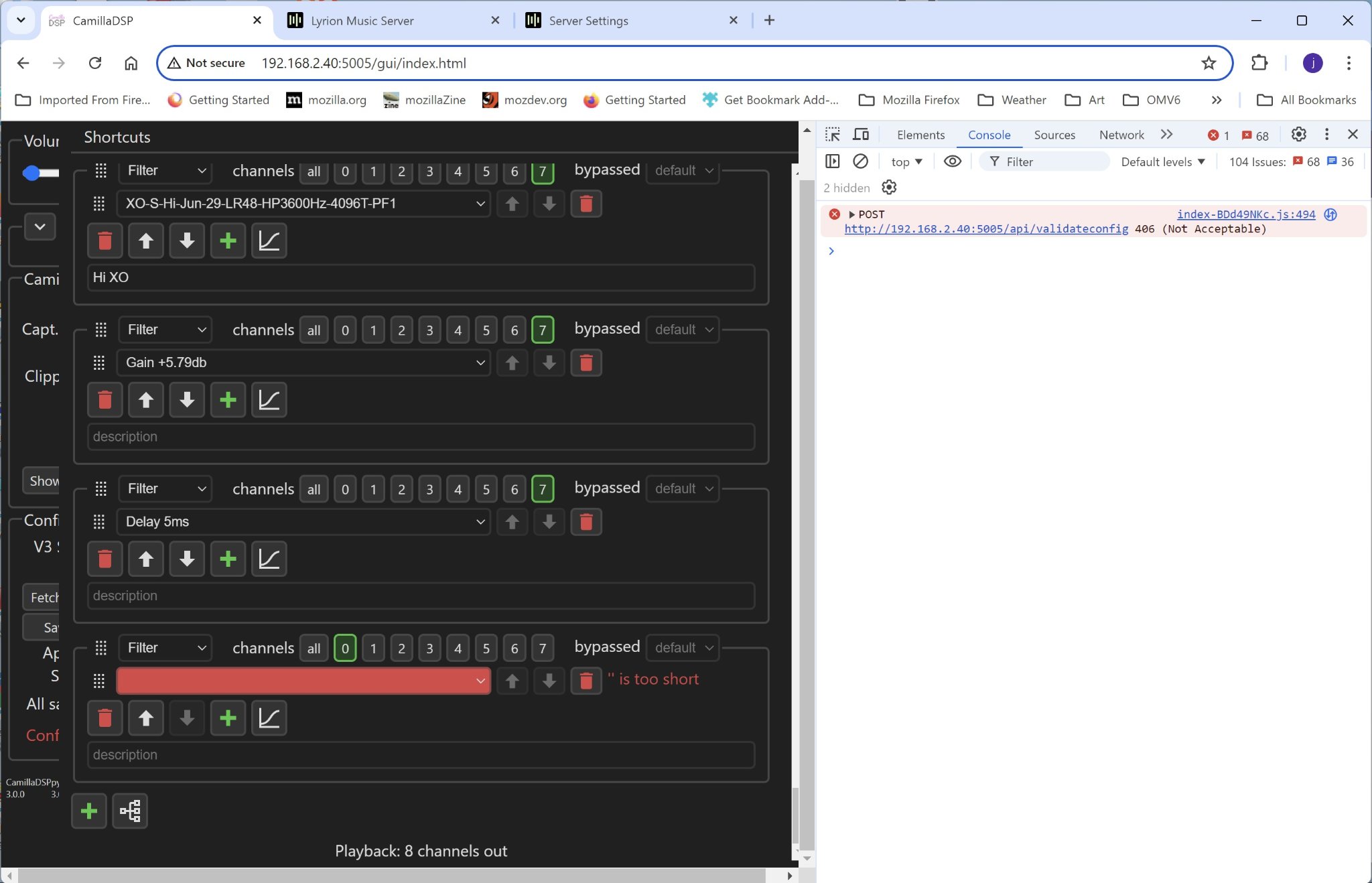

I am running the next30 with the beta 3 gui on raspberry pi with bookworm desktop installed. Can't seem to be able to add a mixer to the pipeline using the + in the pipeline tab. Clicking on the + adds a pipeline step which defaults to a filter, when I change the filter to mixer the screen blanks and the gui is no longer responsive. Seem to be getting the same behaviour on firefox and edge. I tried with beta 2 and getting the same. I am able to manually add a mixer to the pipeline by editing the yml file.
Reactions: rthorntn
I can confirm this.
Edit: in Chrome browser.
First pic is when + adds step, second pic is when you select mixer
