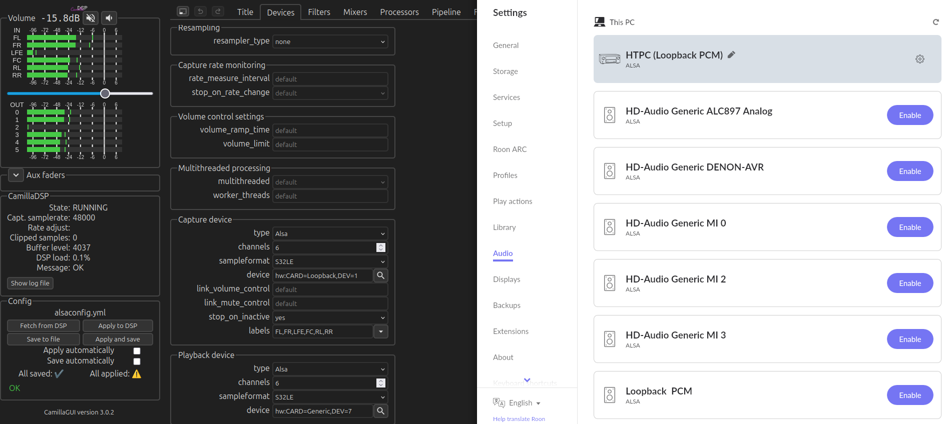

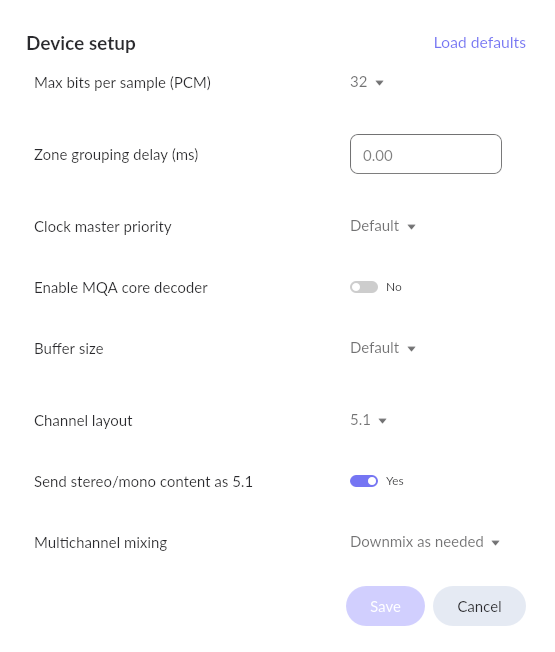

...and reconfiguring the roon loopback device to 5.1 from the default 2 channels gets me the goods. Happy days!
My journey's not over yet, because I was hoping to have camilla DSP handle all output. After a little experimentation, I've found that I can get either plex or roon working using the alsa loopback playback device configured in each app, but they are exclusive, meaning I have to disable it in roon, then enable it in plex for it to work, and vice versa. I also can't get any sound out of netflix or you tube. and I don't know how to set the firefox output device.
How do I get all sounds from the HTPC to route through camilladsp? Edit - and be always on without reconfiguring when switching apps or sessions. Also, how do I get camilladsp to apply the config on boot so I don't have to manually click apply to DSP in the web UI?

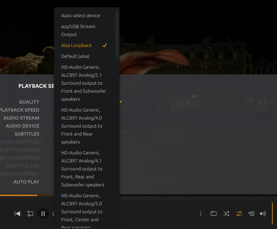

What options for output device do you have in roon and plex?
Edit, looks like this won't work with roon, see: https://help.roonlabs.com/portal/en/kb/articles/audio-on-linux
We only support situations where we have direct and exclusive access to the hardware (in ALSA terms, we are usinghw:X,X
device identifiers)
@HenrikEnquist My roon lists two loopback devices. I just tried both prompted by Chris's comment and one of them worked. The Configured one in the screenshot had an identical label to the one at the bottom of the list. "Loopback PCM" I added the HTPC label. Unfortunately I can't see what device ID is in any aa:x:y:z format be damned.
Roon now works like a charm, on bootup. But sadly, this whole project depends on Plex and Firefox (netflix) working the same way. Plex has the full list of output devices.
After stopping roon. Then playing a movie in Plex, I tried literally every option and not a single one would play sound. There has to be a way to route things.

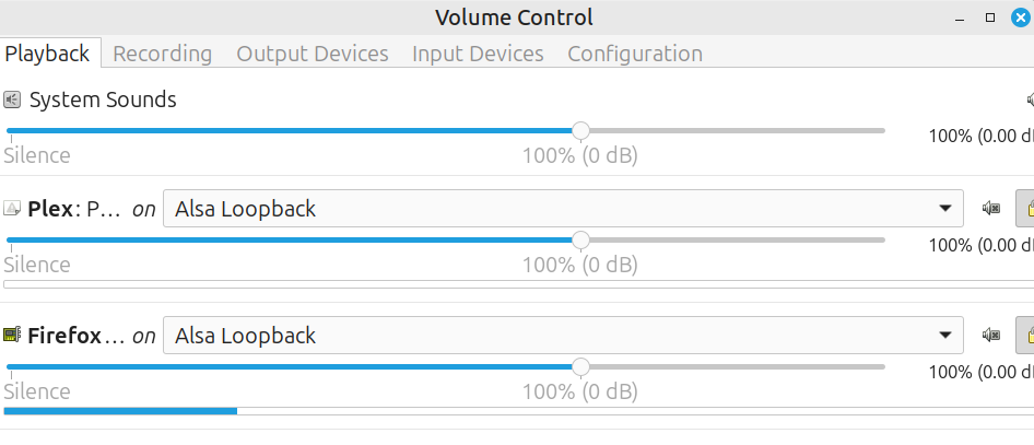

As for getting you tube to play, I discovered pavucontrol, the pulse audio manager that I read runs in between ALSA and pipewire does have an app based audio selection device. In the screenshot below I'm playing some youtube music and the Blue line under Firefox Silence is bouncing up and down like a live VU meter. it knows something is playing. I just can't hear anything.
pavucontrol is a GUI application for controlling pipewire/pulseaudio. THe chain is e.g. browser -> pipewire -> alsa -> hardwareI discovered pavucontrol, the pulse audio manager that I read runs in between ALSA and pipewire

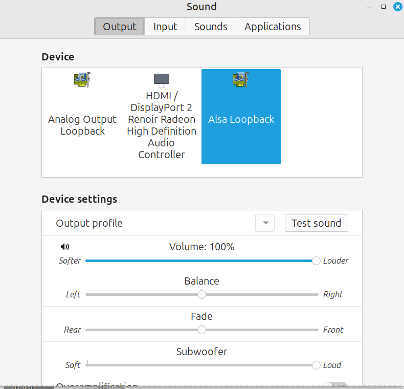

@HenrikEnquist "run everything through pipewire"
How would I do that? I thought everything was already going through pipewire as per $ pactl info. I'd like to try your pipewire suggestion and then work on troubleshooting roon, but I'm not sure where to start.
Edit: I would also be happy running everything through pipewire camilla DSP, except roon as it has it's own DSP engine and I can put the convolution filter there so that one application doesn't require camilladsp, if that helps.

The chain is supposed to be: App -> pipewire -> Alsa Loopback -> CamillaDSP -> HDMI output device@HenrikEnquist "run everything through pipewire"
pipewire can receive sound from apps in a few ways. Most use an Alsa PCM device presented by pipewire. You don't need any asound.conf in you home dir for this, it's automatic (it's better not to have one since it can interfere).

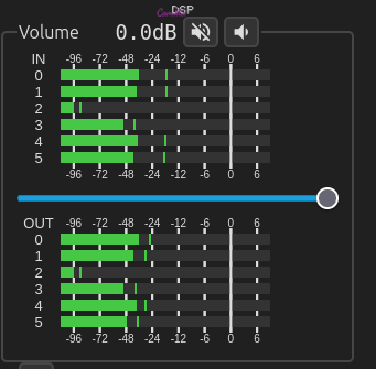

You already see sound the level meter moving for Plex and Firefox, so the first step is working. The next step is to make pipewire output to the Alsa loopback. This is where you need to edit the pipewire config, otherwise it may not show the loopback as a possible output device.
If CamillaDSP captures from CARD=Loopback,DEV=1, then pipewire needs to output to CARD=Loopback,DEV=0. Or vice versa, DEV=0 for CamillaDSP and DEV=1 for pipewire also works. The camilladsp playback device should be the same as before, the Generic.
