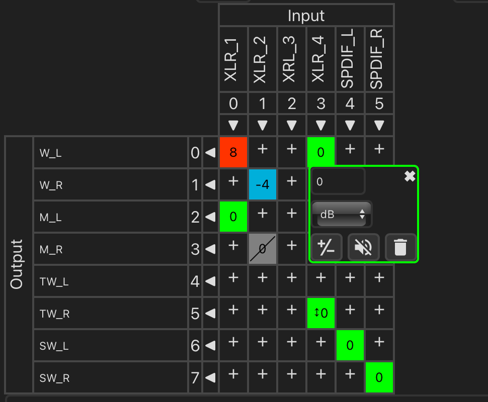

New version of the mixer ui:
This is starting to get ready. It's only missing muting controls for the output channels, and some small tweaks here and there. Other than that it's working well.
I used an arrow (↕) to indicate inverted channels. It's a bit small but I haven't come up with anything better so far.
So, as far as I can see,
Clicking a + enables the cell, and clicking a cell opens the popup with the controls.
The number in the cell indicates the db as does the colour - colourbar coming
A grey cell with a forward slash indicates muted ?
Inverted indicator, agree it is small, I thought it was a 1. What does a horizontal slash look like?
The mixer matrix is looking really functional - great job, Henrik. One suggestion - reserve colours for status and use only numbers for gain, e.g.:

That is the idea yes. Unfortunately I don't think it works out very well in practice. I was hoping that the colors would make it easy to see what a mixer does, but the result just becomes some confusing confetti.What's the color coding really? Hot (+ gain) cold (-gain), green natural?
I think this will be the way to go. I'm thinking:One suggestion - reserve colours for status and use only numbers for gain
Black - no connection
Green - normal connection
Blue - inverted (not red since that color is used to highlight errors)
Grey - muted
Normal and inverted muted connections are completely equivalent, they can just as well share the same grey color.
How about Indigo for Inverted ? pretty close to blue !
and gain is the number in the cell in db
Well, it's well known that males are supposed to distinguish only 4 colors in total 🙂 I would definitely call it blue 🙂How about Indigo for Inverted ? pretty close to blue !
