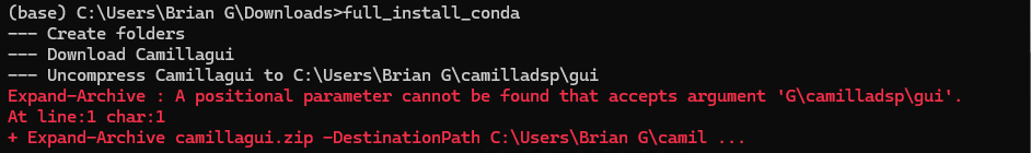

Has anyone got this to work if you have a space in your user name?
Can't get the batch files to run for the GUI and thinking I need to make a new, space-free user
I get the error:
Thanks,

Ok, looks like everything is running
