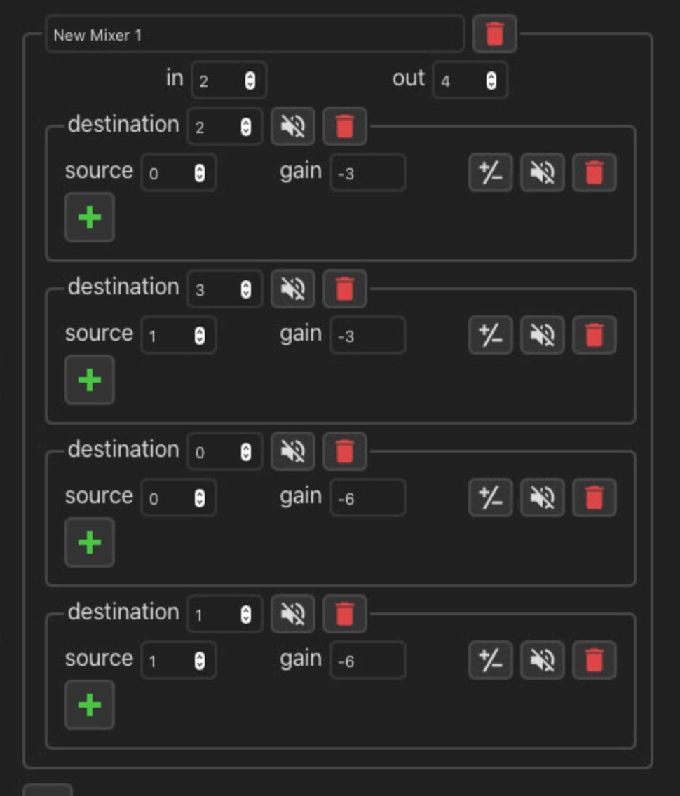

Would it all be possible to assign a "nick-name" to these sources and destinations? After they are created... like little help tabs for the memory 🙃
Every time I enter this pretty simple 2 way setup to do something I just cant seem to remember what is left and right as well as highs and lows 🙂
Maybe. It's something I would like to add at some point. So far I haven't come up with a workable way to implement it (meaning one that makes life easier rather than harder). A nickname is only valid for a part of the pipeline. As soon as there is a mixer, the channels and names change. It gets quite messy..
I help myself regard this with 0dB gain blocks with names describing the path.
Smart! 🙂 My problem is not so much when I'm in the Pipeline but rather in the Mixer...
