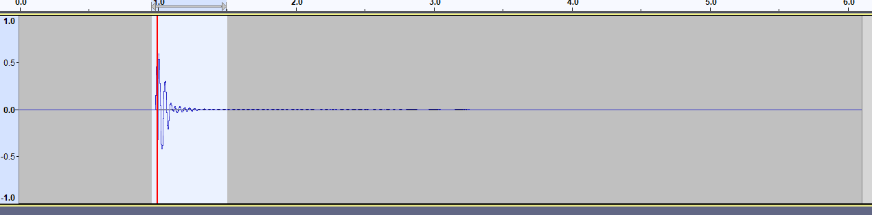

@Quickmcj the filters are almost 1.2 million points log, that is crazy long! You should not need anywhere near that much (and more than half is just zeroes anyway, they contribute nothing but still eat processing power).
You can cut the filter to a tenth of the size, then things should be much easier.
Something like the marked area here:
I think Rephase can help you do this, and apply some windowing so there is no discontinuiity at the end. Just keep in mind to cut all filters the same way, so you don't make them give different latencies.

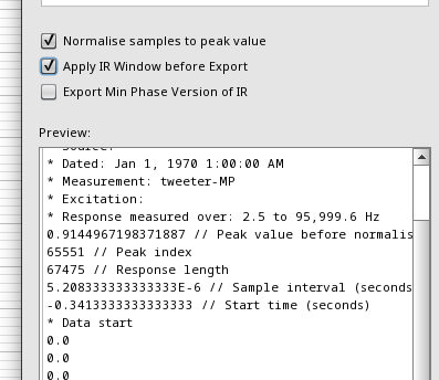

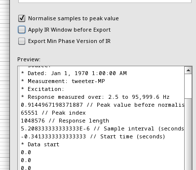

Hi Henrik
I did try Rephase for exactly this, to reduce the number of taps in some thoughtful manner, but I learned that rephase cant actually do that. It will import measurements from REW, but it will do zero with them, only show them, apparently. So all exports from Rephase result in flat magnitude and phase, as I did not adjust anything in rephase at all. I will try to see if I can apply a window in REW before export.
The suspicion were exactly what you point out, I just did not have adequate knowledge about the subject to be sure.
I had trouble creating 192kHz convolution filters for camilladsp based of inverted speaker driver measurements, which would not shift in frequency range when applied, so I might have gotten of the wrong track at some point trying to find a solution.
Many thanks for the reply, this should be the last hurdle before great sound.
Edit: Think I found it, hidden in plain sight (See attachments and the reduction in data points) Again thanks for leading me in the right direction, Camilladsp is much more happy now that I do not bog it down, now running four filters at 18% load.

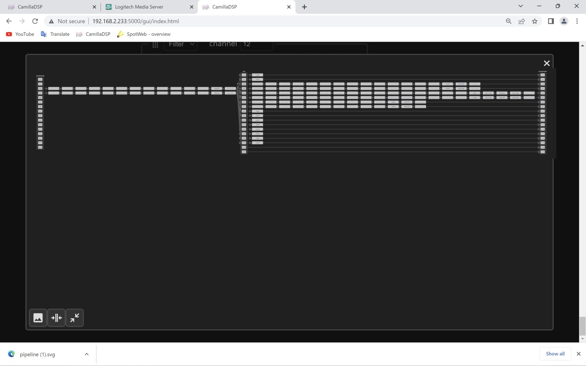

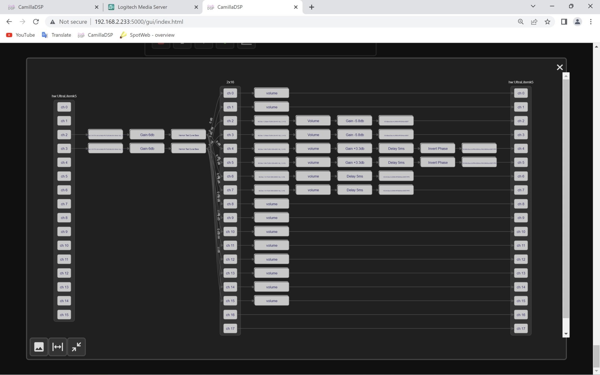

2. The CamillaDSP option to group filters in the pipeline display.
My original request was "The pipeline plot could optionally "group" biquads with the same name less the _nn suffix, reducing a potential 17 boxes to 1 box for the plot." https://www.diyaudio.com/community/...overs-room-correction-etc.349818/post-7106214
I wonder if this could be added as an extra option. The reason being that a filter section (in my case) for each channel contains a Volume filter, FIR filter for xover and phase manipulation, gain filter, delay filter, sometimes a phase invert filter and a bunch of biquad filters. If the only the biquads were grouped it would make it easier to visualise the filter sequence.
This would be quite a large amount of work for a feature I'm not convinced is generally useful. It would depend on filters being named in a very specific way, and in cases when they are not it would often group filters in unexpected ways.
Can't you just put all the "something_nn" biquads in a separate filter step? That would work fine with the existing plot, and would also be easier to overview in the pipeline editor.
Henrik, thank you for your patient polite reply.
Of course I can (and now have) put all the "something_nn" biquads in a separate filter step, I just had not thought of something so obvious !
It is indeed easier to overview in the pipeline editor and works fine with the existing plot.
