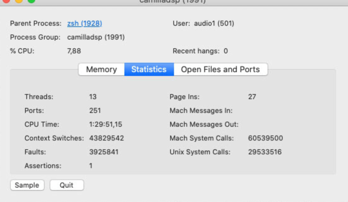

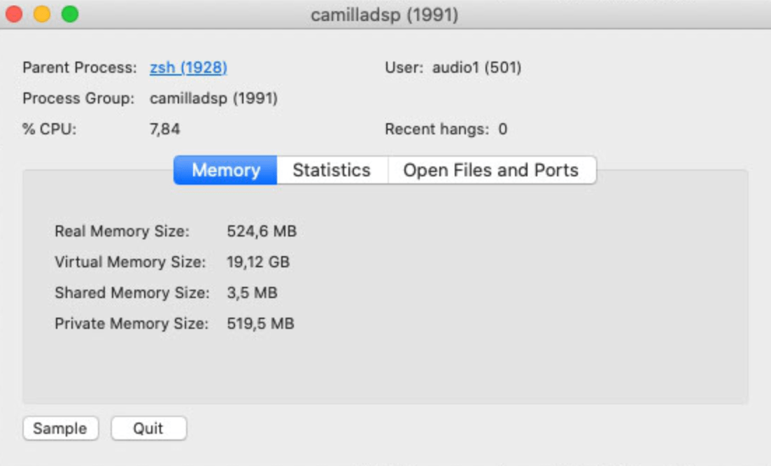

It didn't crash when I tested it now. Funny, I think it crashed when I launched Safari - and I don't think that Camilla was an adress that was present at that launch - maybe a memory problem - I have seen crashes lately - I think the difference is that I have had REW running in the backgrund and it leaks so there might be a shortage of memory that make C crash?
I have two installs - both with Catalina - they have shown that they can run for months - but since I think the last CDSP, it has been a bit shaky as they dont seem to be able to do more than 1 week or two. These are both headless so untouched from efter start to crash.
It doesn't appear that camilladsp is crashing. For some (yet unknown) reason the system terminates the camilladsp process.
Perhaps something related to the sleep behavior in OSX, like https://montemagno.com/long-running-processes-ios-macos-nsprocessinfo/ ?
Btw the M-key doesn't do anything in top on my Mac. But launching it with "top -o MEM" works.
I see, the OSX top is not the GNU version I use in linux https://serverfault.com/questions/3103/a-better-top-command-for-mac-os-x .
Yes I willing to set traps or whatever... I'm just not super proficient - help! 🙂
This is what it looks like now (started yesterday afternoon):
Open files and ports:

TOP:
Processes: 326 total, 2 running, 324 sleeping, 1055 threads 14:13:49
Load Avg: 2.40, 1.52, 1.38 CPU usage: 7.24% user, 4.83% sys, 87.92% idle
SharedLibs: 149M resident, 47M data, 11M linkedit.
MemRegions: 164923 total, 1427M resident, 60M private, 238M shared.
PhysMem: 4075M used (1045M wired), 20M unused.
VM: 1646G vsize, 1990M framework vsize, 0(0) swapins, 0(0) swapouts.
Networks: packets: 23915068/16G in, 23503419/15G out.
Disks: 623013/9374M read, 268130/5297M written.
PID COMMAND %CPU TIME #TH #WQ #PORT MEM PURG CMPRS PGRP
1991 camilladsp 7.9 90:16.91 13 1 252 15G+ 0B 14G 1991
331 Safari 1.1 13:29.47 6 1 397 541M+ 12K 253M 331
2863 perl5.18 0.0 06:21.22 1 0 25 178M 0B 109M 2863
242 WindowServer 3.9 23:12.59 11 5 1302+ 162M+ 1992K 18M 242
46458 Activity Mon 0.0 00:47.58 4 2 1858 89M 14M 0B 46458
0 kernel_task 1.5 16:37.59 178/4 0 0 68M 0B 0B 0
2146 com.apple.We 6.2 71:42.28 9 4 111 58M+ 5504K 18M 2146
328 BBEdit 0.1 00:13.18 3 1 297 46M 0B 41M 328
1661 com.apple.ap 0.0 00:04.77 3 1 256 44M 0B 41M 1661
343 Finder 0.0 00:10.99 3 1 417 36M 0B 19M 343
287 mds_stores 0.0 00:52.33 4 2 106- 34M- 164K 27M 287
127 mds 0.0 02:15.78 5 2 268 32M 0B 25M 127
2118 SqueezePlay 1.8 30:33.20 8 1 382 32M 9216K 10M 2118
256 syspolicyd 0.0 00:19.29 3 1 136 31M 0B 26M 256
46394 screensharin 1.7 00:06.01 8 2 86 24M 0B 0B 46394
1924 python3.9 2.4 32:35.37 3 0 25 24M 0B 18M 1924
413 SafariBookma 0.0 00:00.61 3 1 80 23M 0B 21M 413
325 Terminal 2.4 00:04.64 7 2 248 23M+ 1840K 6688K- 325
