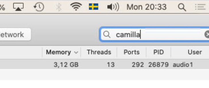

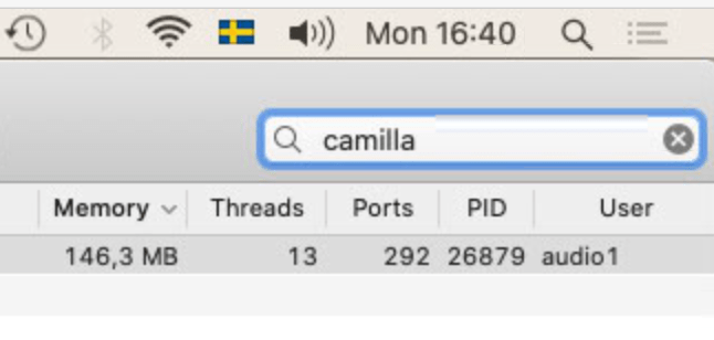

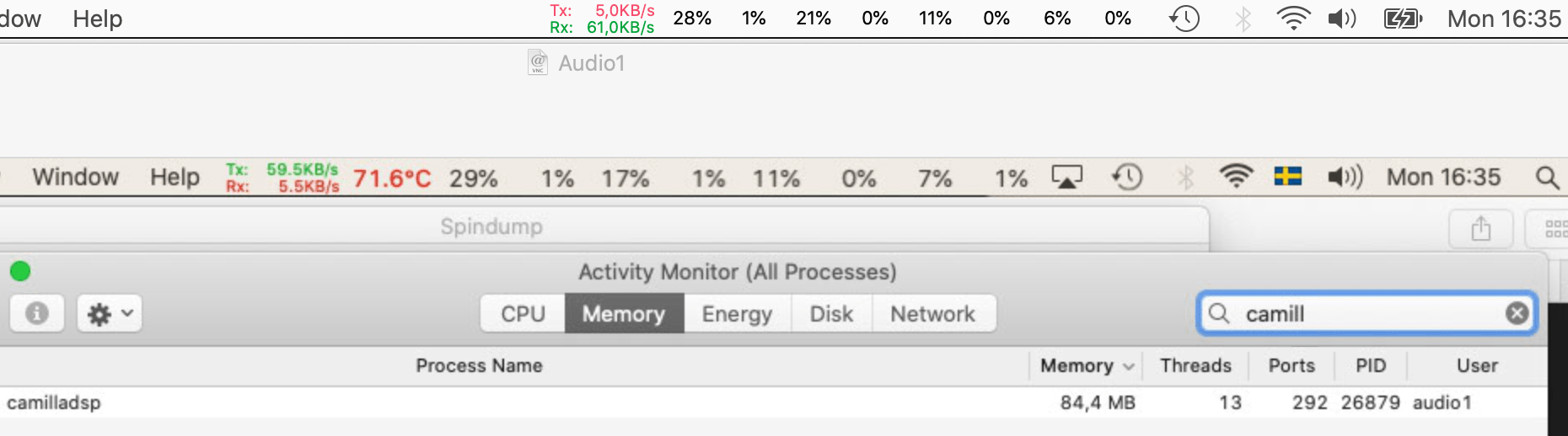

Aha! I did an enquire on how to catch who dose the process killing on a Mac forum (but no luck there) but one comment was that Soundflower wasn't developed any ore since a couple of years as opposed to Blackhole... my installs are not able to run for more than a few days now.
Perhaps I should try Blackhole and see if the situation improves...?
