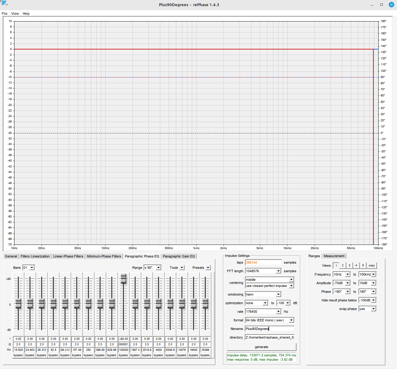

Is there a way to shift a channel's phase by 90 degrees? I would like to decode signals from quadraphonic LPs.

If you want to change JUST phase, this will get you close, but there is some increase in phase in higher frequencies.
If anyone knows of a better way to do it in RePhase (without the high frequency roll), please chime in.
The xxx.RePhase file is in the attached zip file so you can change it to +/- 90, specify sampling rate, output format, # taps, etc. as you require.
