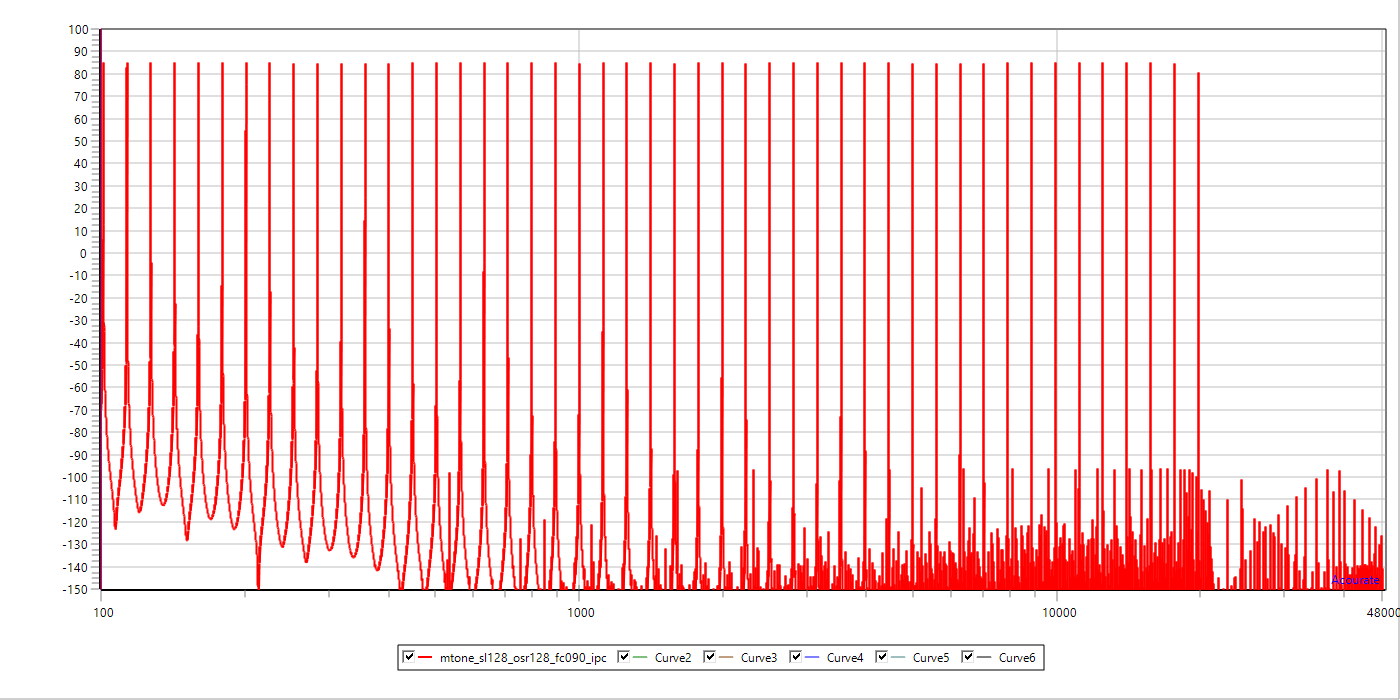

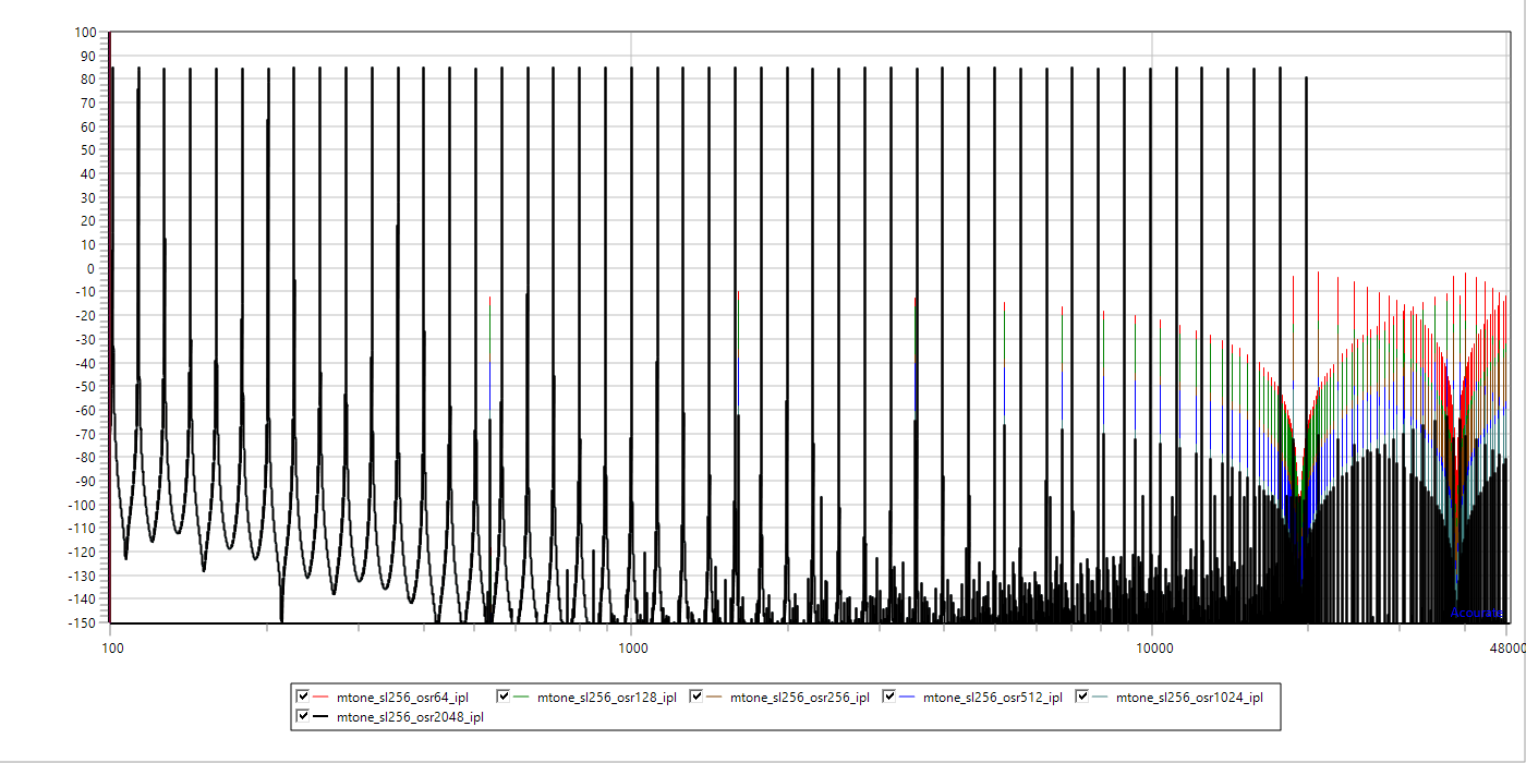

The AccurateAsync asynchronous resampler preset yields beautiful results, but is just a bit too hefty in terms of cpu demands for my rpi3 gadget which I like to run at a "cool" and steady-state 600MHz while resampling everything to 96kHz. In order to find some kind of sweetspot/tradeoff between quality and cpu usage, I therefore made some dry runs along with the FreeAsync resampler type. A multisine signal of 2097152 samples on a 64Bit dbl-file was read by camilladsp, with different settings for the resampler, and then written to an output 64Bit dbl file. I finally found a subjectivly very appealing setting, where all the in-band and out-of-band distortive products are more or less at the same <175dB level:
sinc_len: 128
oversampling_ratio: 128
interpolation: cubic
window: BlackmanHarris2
f_cutoff: 0.9
This is now my sweetspot-setting that I chose for my rpi3.

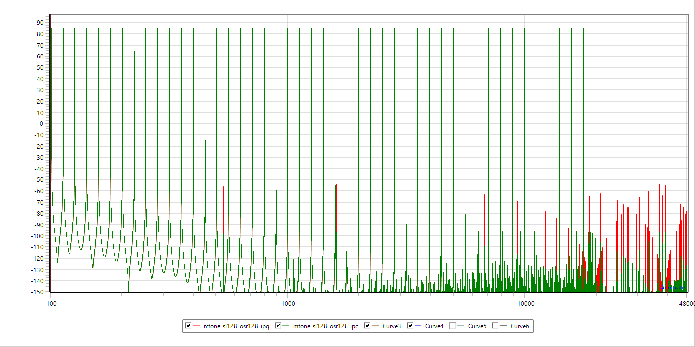

Meanwhile ...
... I have compiled CamillaDSP next20 version branch on my old and outdated, but still faithful linux W500 lenovo laptop. Not to only hypothetically speak about this maybe promising quadratic interpolation option to come. But instead to see in real-world how it might look like. The result in one word: EXCELLENT! It is exactly a best imaginable compromise matching the above talk/logic, merging flawless src with lean cpu usage.
Starting from the cubic interpolated sweetspot (sync_lenght=128 / oversampling_factor=128), as shown already in one of my previous posts with it's fabulous but overkill >180dB S/N ratio, the basically same, but quadratic interpolated 128/128 version will compute at a real-world-best-compromise of 140dB S/N ratio for about a bit more than half the CPU ressource compared to the cubic interpolation algorithm. So this quadratic interpolation option will certainly be a winning addition to the next version of CamillaDSP for the everyday real-world, no-compromise, highest-standard audio experience.
Have a look at the graph, judge by jourself and then make your choice: Red == Quadratic interpolation / Green == Cubic interpolation
