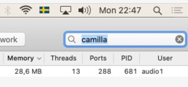

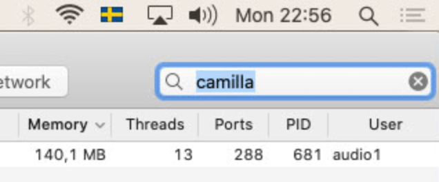

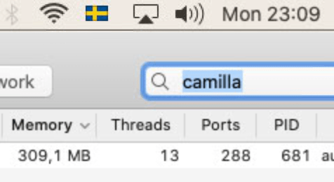

Strange... mine used to.
Now I see ->
I'll send you a process trace on email...

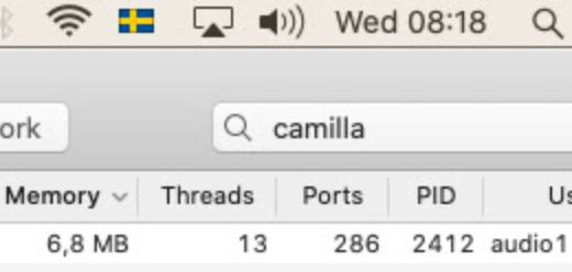

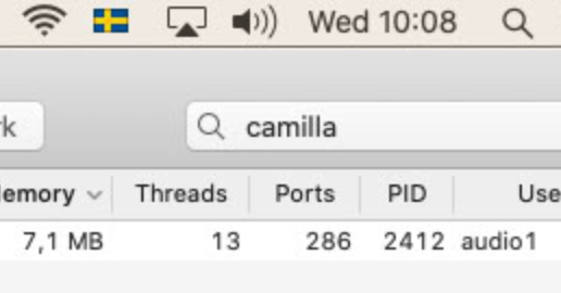

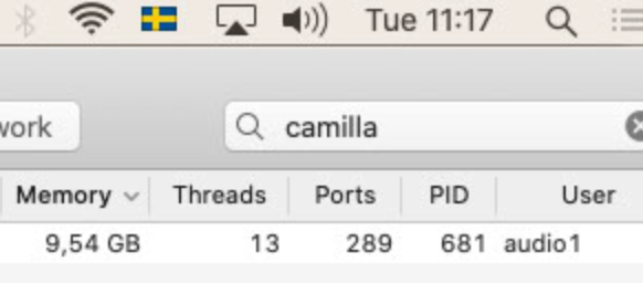

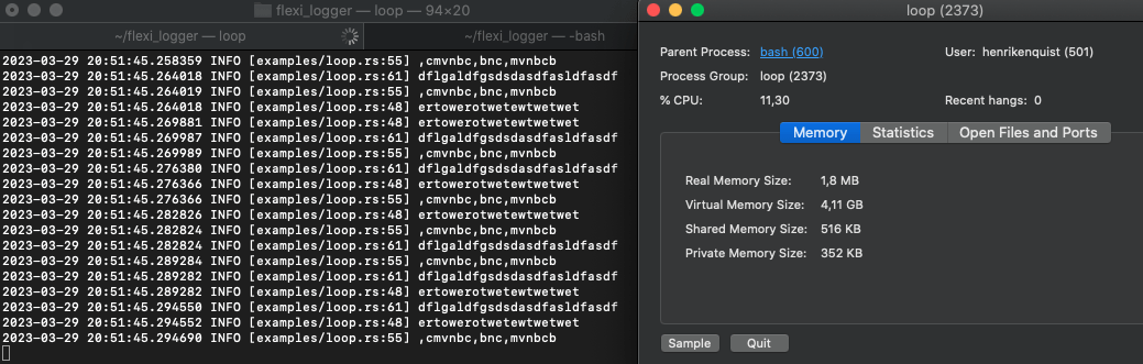

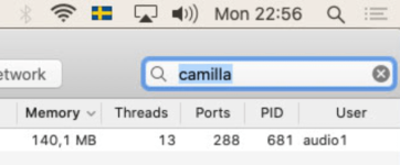

Running 1.0.3 on my old MacBook with Catalina. It looks like the logging is consuming some memory. Without the -v option it's stable at ~7 MB, with -v it increases slowly with a few hundred kB per minute. And with -vv it grows much faster, similar to yours (but didn't measure).
What logging level are you running?
Next step, trying with camilladsp v1.0.3 again.
Freshly compiled -> works fine
Prebuilt binary from GitHub -> leaks
My only reasonable theory so far is that there was a bug in some library that was used to build the 1.0.3 on GitHub. The freshly compiled one uses slightly newer versions of all dependencies. Cargo automatically makes safe updates, like bumping a dependency that was specified as v1.2.3 to v1.2.7. No idea which library it could be (and don't really want to spend time on figuring it out..).
