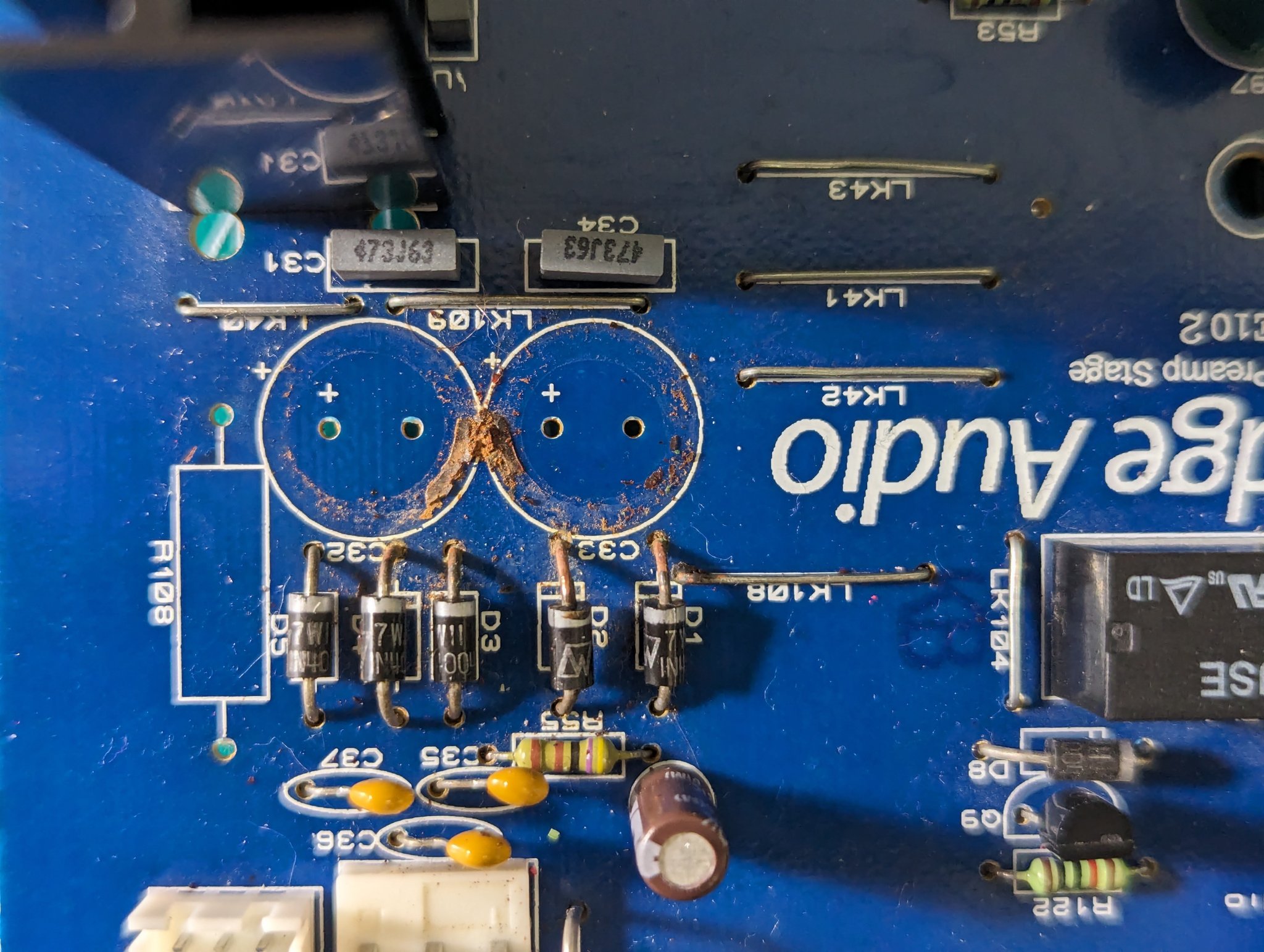

I'll aim to replace the relay, then see if that fixes things or if there's anything else triggering this fault. If that's looking good, I'll probably look at some housekeeping while the unit is open: replacing the carbon resistor you pointed at very early in the thread, and probably also the diodes/capacitors that were sitting under dried glue for 15 or so years. I think I have replacements for all those and they should be easy.
To be honest, I have never replaced such components unless the resoldered joint did not look unsatisfactory.
But these components are cheap, so if it makes you feel better then it is definitely worth doing.
Oh, yes, misremembered by me!
Editing to add: also, yeah, I don't usually go aggressively on needlessly replacing components. The carbon resistor(s) seem like good things to replace though. Maybe the capacitors just as a refresh and since I have replacements.

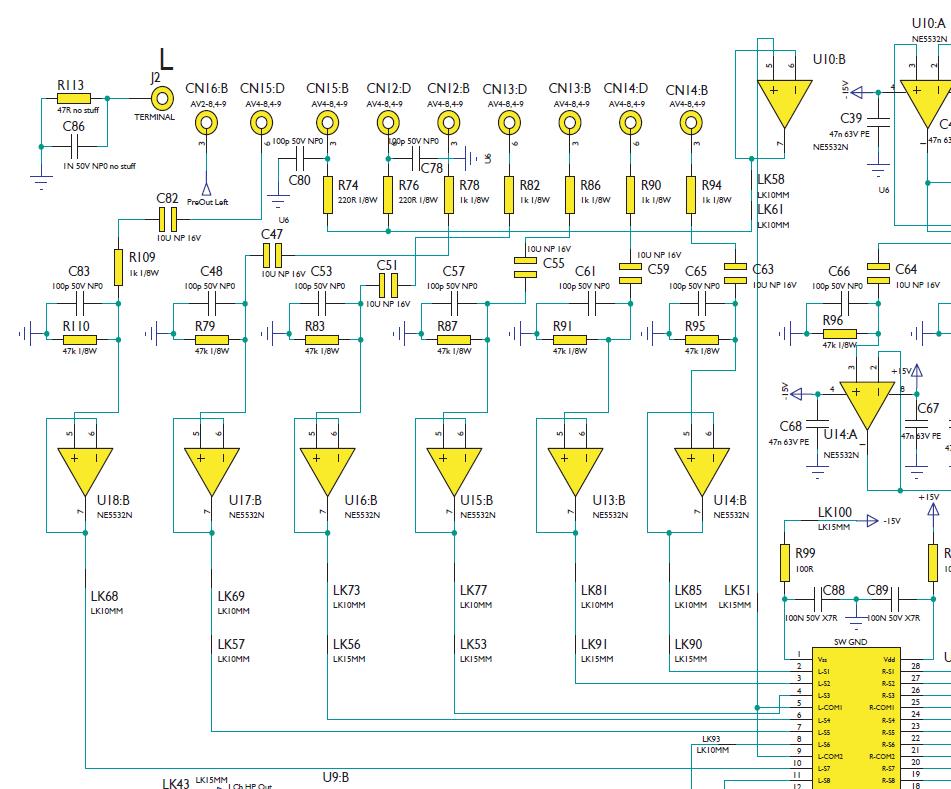

If you want to be adventurous then (on one channel as a test) you could jump the input buffer with a wima film cap:
Opamps as input buffers driving the next chip some centimeters away are just sound killers for me.
Can you describe more, or give pointers?
Solder out the input lytic capacitor and opamp straight after the RCA socket on some input channel.
Then solder a film capacitor from RCA socket center connector to the input selector switch. Ca 100k from RCA socket center connector to ground will not hurt either. 100pF from incoming signal to ground - depends on your ears, I usually solder them out.

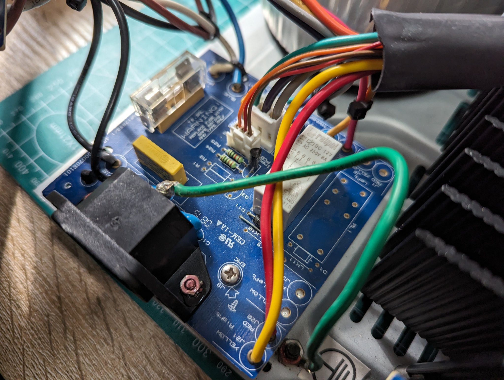

Either way, an unambiguously easy fit:
The DC protection fault hasn't kicked in so far, so I'm pretty confident. I'll give this a day or two before anything doing else.

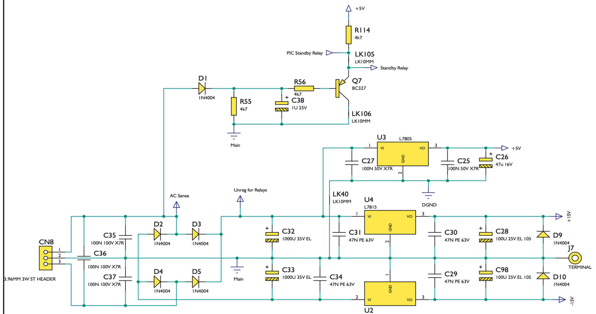

One thing that I'm wondering about: I noticed that when the unit is in standby, the heatsink attached to the three voltage regulators on the pre-amp stage is usually pretty warm. It might be that it's always been warm and I've never noticed with the case closed, but I'm curious about it.
The section in question:
CN8 comes straight from the mains board and it isn't gated by the relay I just replaced, so I figure it makes sense that these are running and generating a little heat at all times. They're not outrageously hot, but the heatsink is definitely fairly warm.
Of course the unit needs to be running +5V for the IR receiver, panel buttons, etc, to operate at all, and that comes from U3 above.
"Unreg for relays" is fed back to the mains PCB and is used on the relay I just replaced. And since that line is always active, it makes sense that there's voltage on the input into U4 in the diagram.
Given those two, I figure the input on U2 is always active, too.
So, my question is: is it typical for these voltage regulators to be generating heat while in standby? I've had this thing for a long time and I've never noticed it. This feels like a "stupid" question, I'm just genuinely curious if this is typical or if something is drawing current that should actually be off.
The 15V regs are powered the same way as the +5V, so they seem to be ON in standby.
Search the service manual for +15V and you will find plenty of opamps being powered by +/-15V rails when in standby.
Why did they do it that way - because they could?
Yeah, fair; thanks for the sanity check. Mainly I wasn't sure if I was missing something on the schematic, but it sounds like no.
I put the thing through a cheap energy meter, and it looks like it draws marginally more than 10W while on standby and ~26W while active with no actual input. The service manual says standby is "<10W" and active is "<30W", so that's about right.

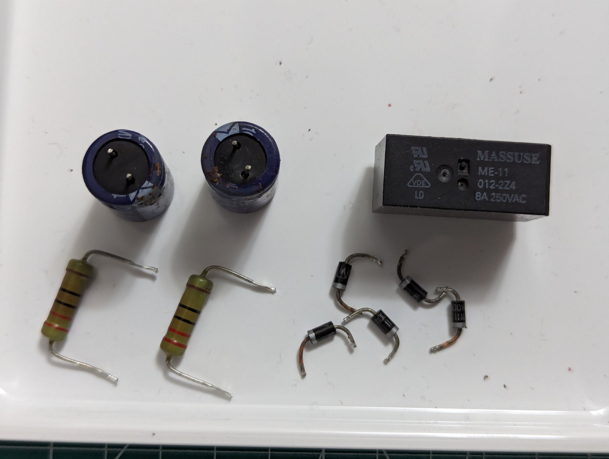

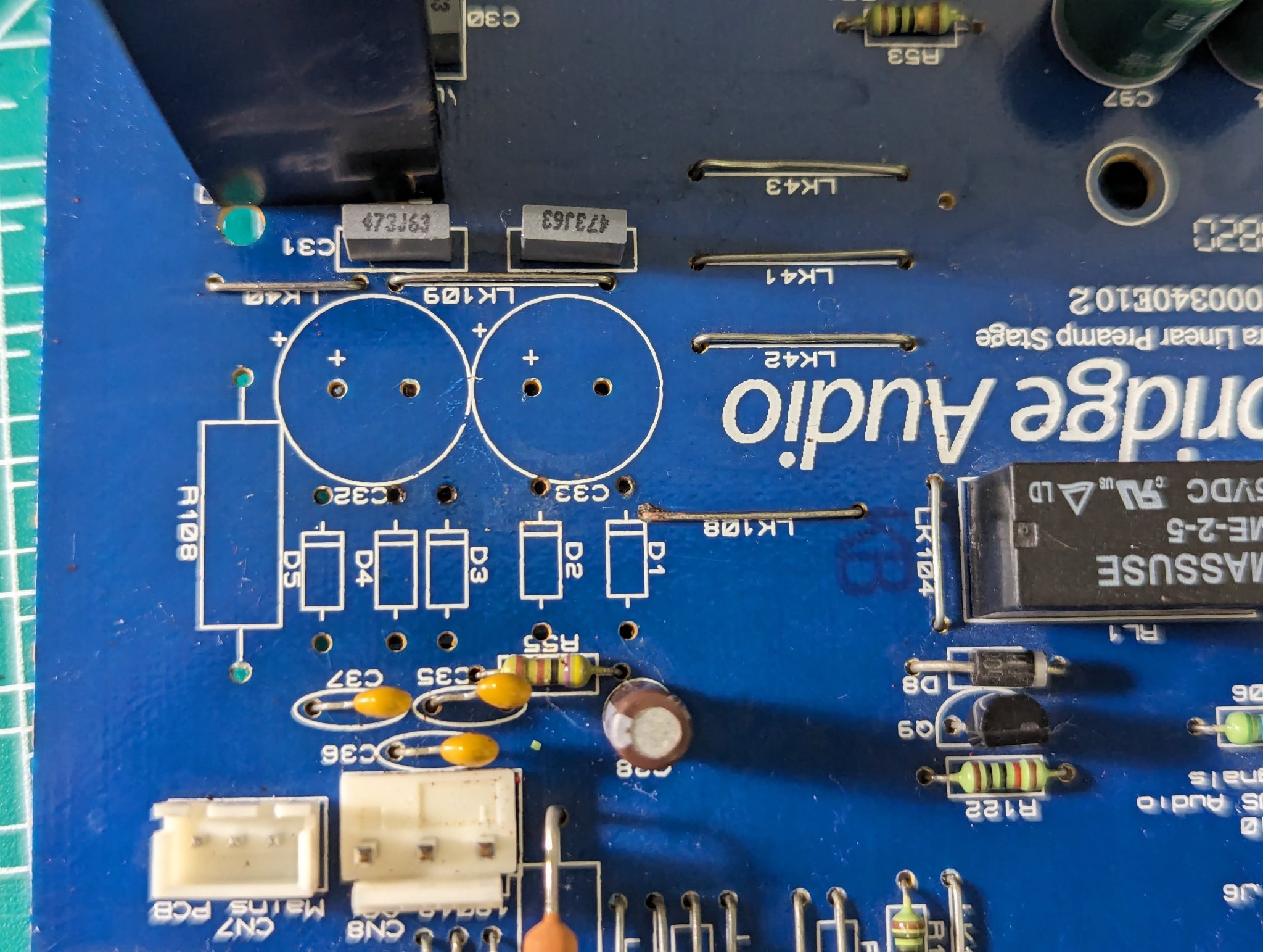

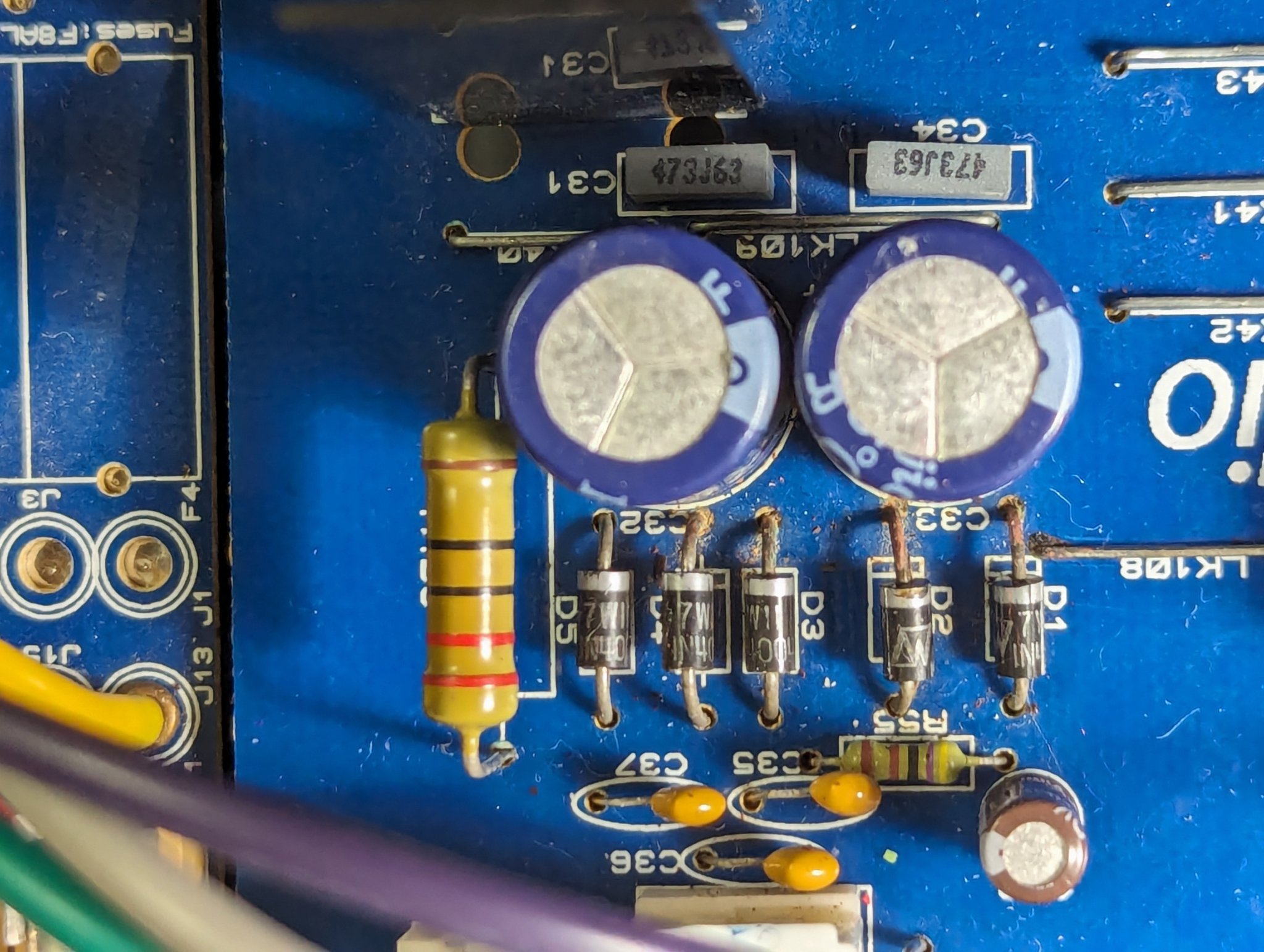

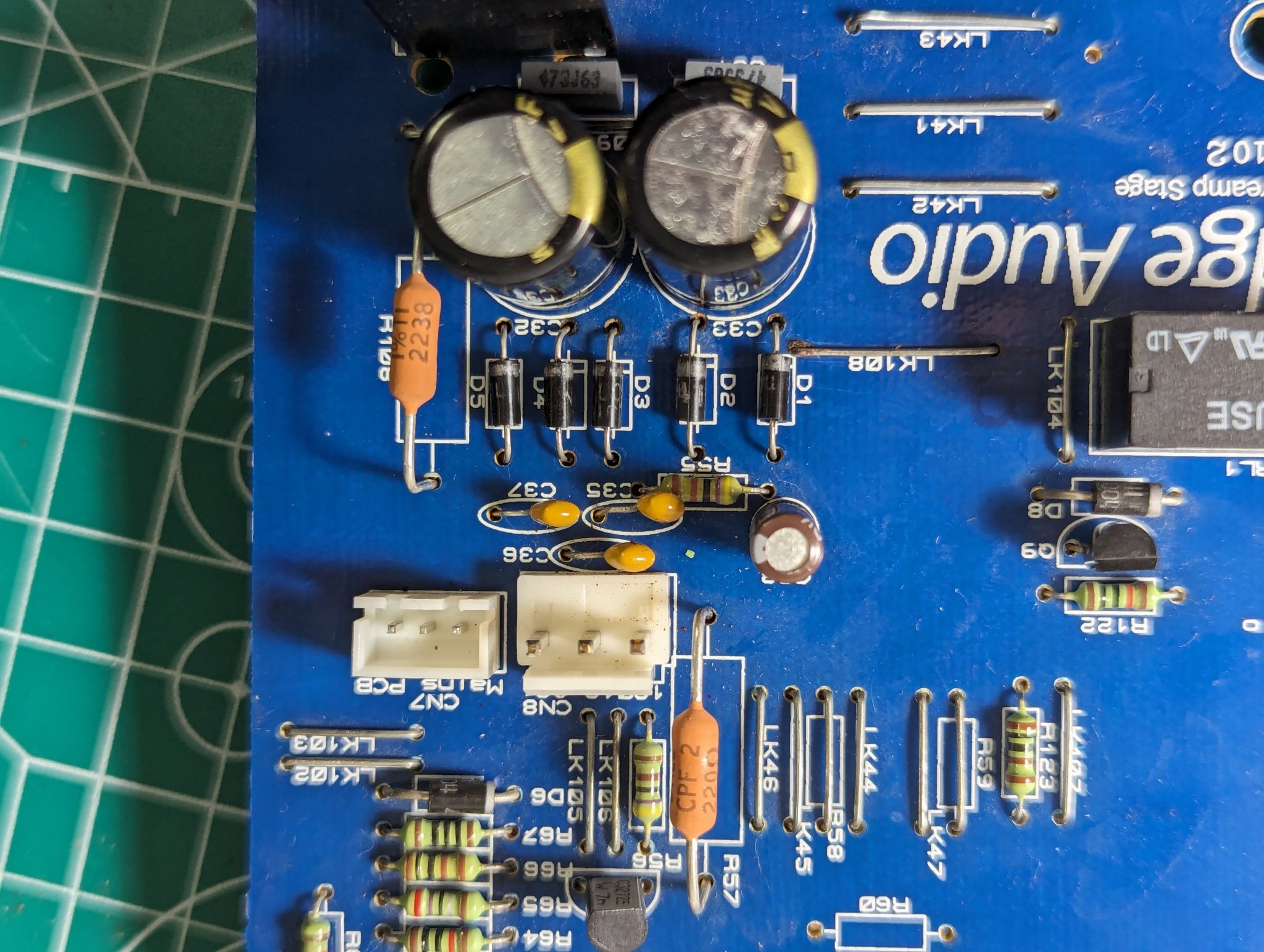

I went back to the caps/diodes with the crufty glue and switched those out.
PXL_20240211_040834150.jpg PXL_20240211_041854031.jpg PXL_20240211_043551796.jpg PXL_20240211_051418867.jpg
All parts replaced during this work:
I've buttoned the amp up and I'm declaring a victory.
Thanks for your help as I learned my way around this. Super happy with the fix!

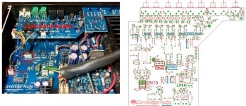

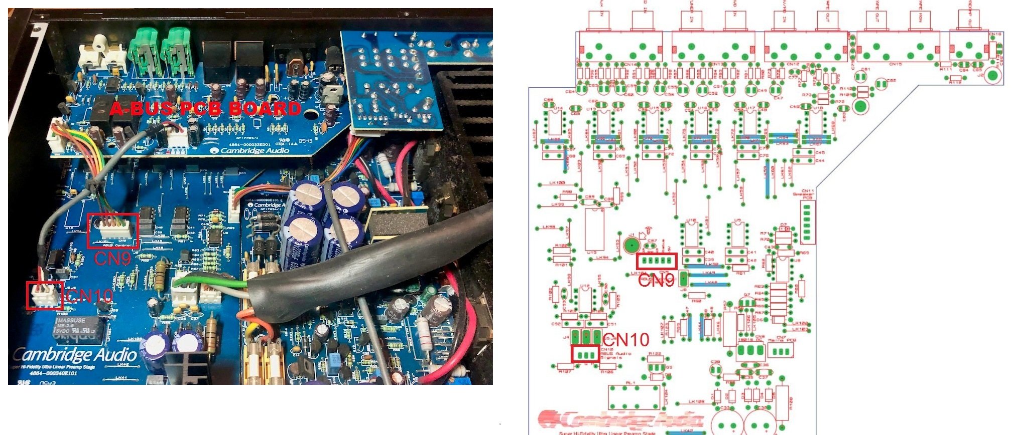

Hello
I saw that you work on amplifier cambridge 540a v2.
I need your help, I am not a specialist of electronic.
I have an amplifier cambridge 540a v2 and to upgrade this amplifier, I install inside a dac.
For that I need space and I remove and disconnect the Board Abus Module (AP17708/4).
Now the remote control don't work.
Do you have a solution , to fix this problem and keep the Board Abus Module removed.
Let me know
Best regards
Hello again,
To be clear, the Board Abus Module is necessary only for a very special use (Not necessary for my use).
I disconnect the 2 connectors CN09 and CN10 of the Input PCB Board (AP17649/4)
Il is perhaps possible to by-pass this abus Functions.
How, i don't know..................
Let me know
Best regards
