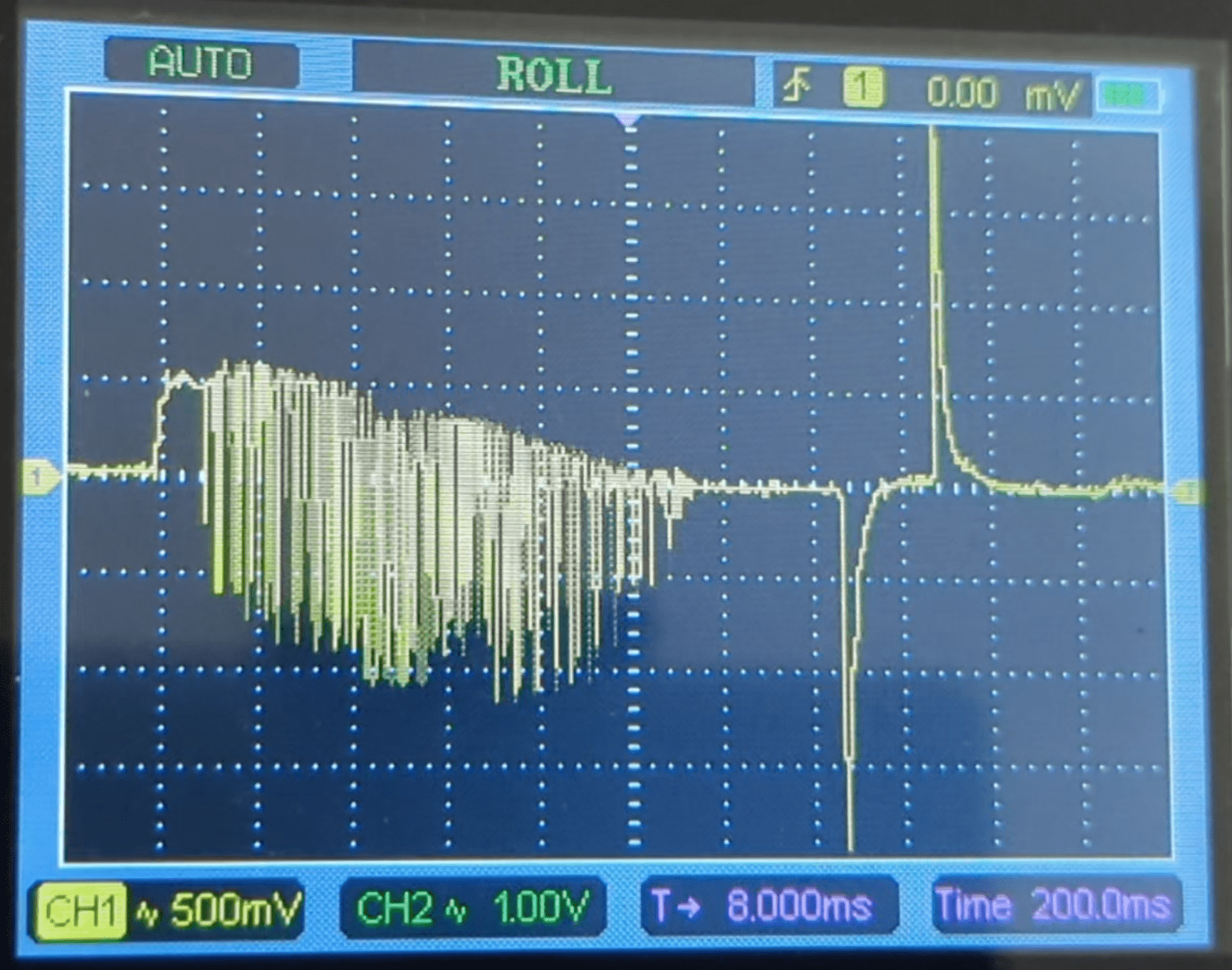

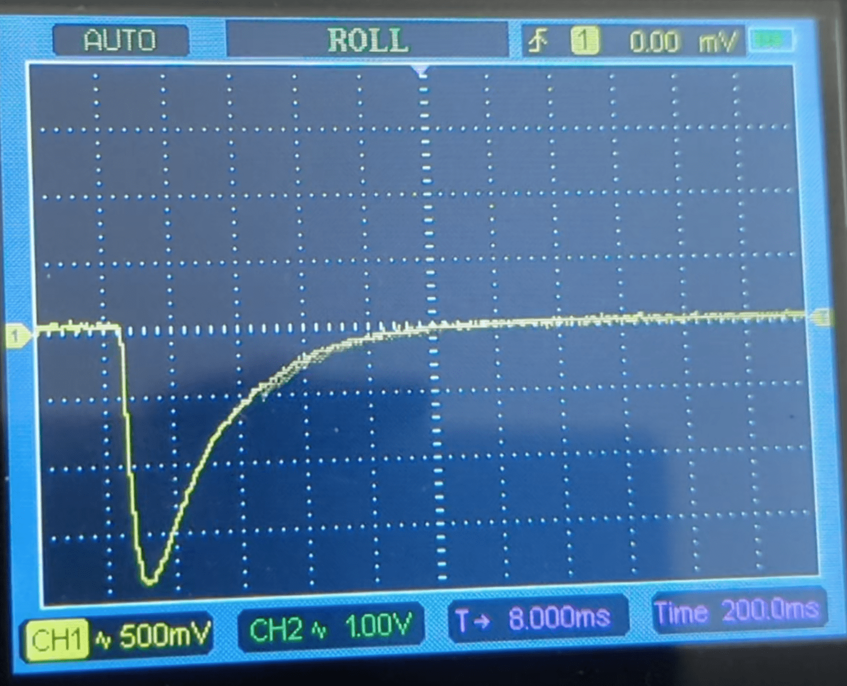

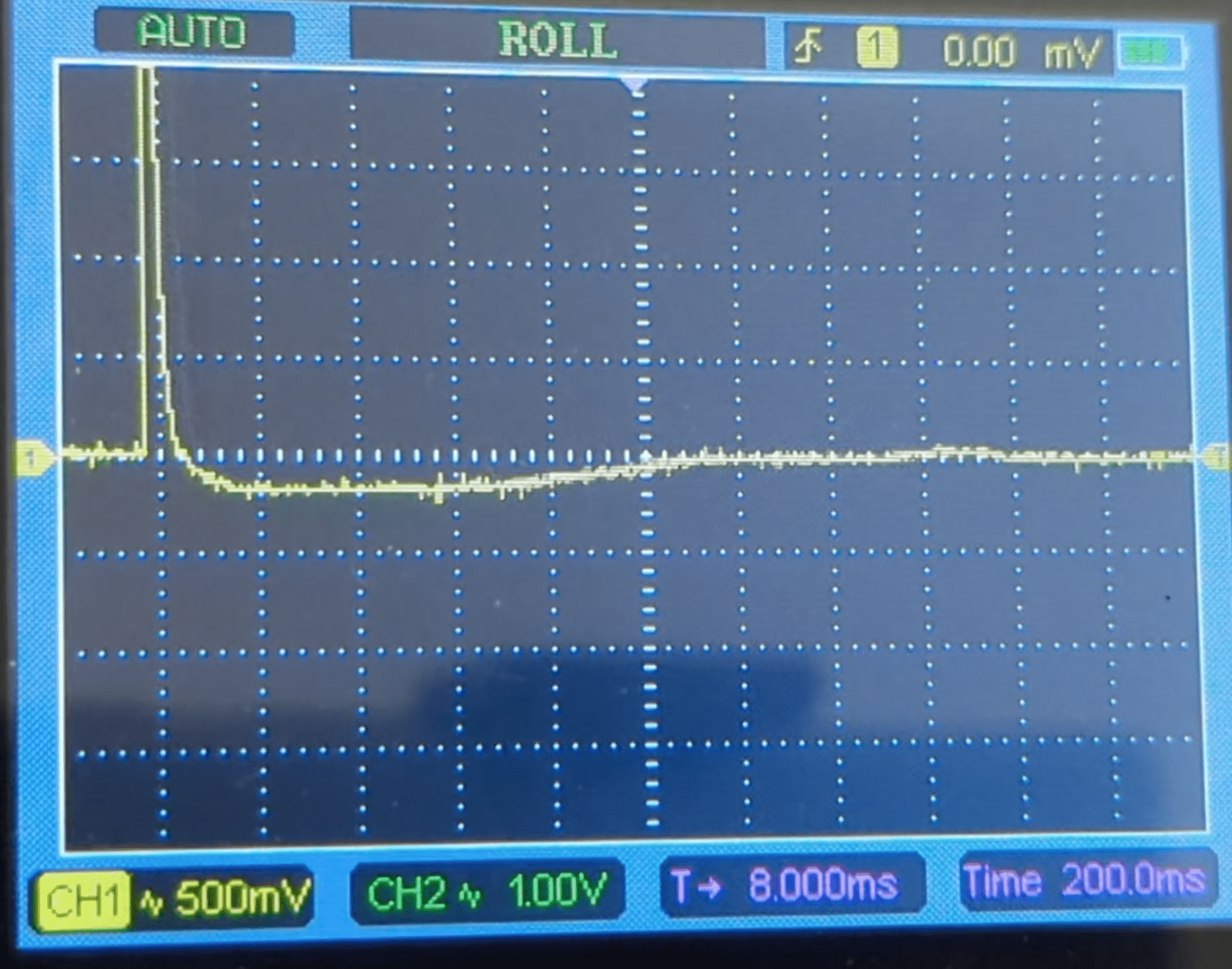

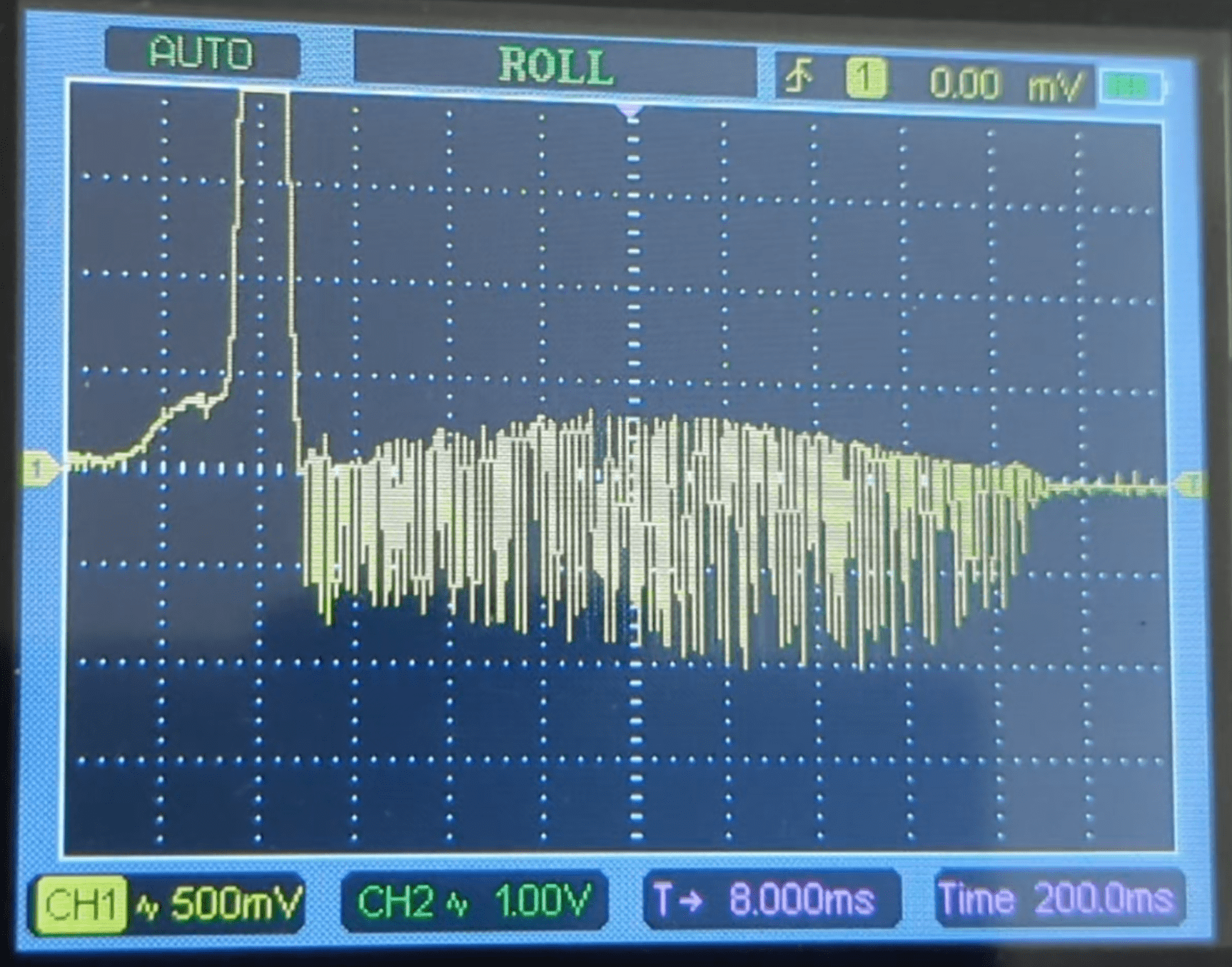

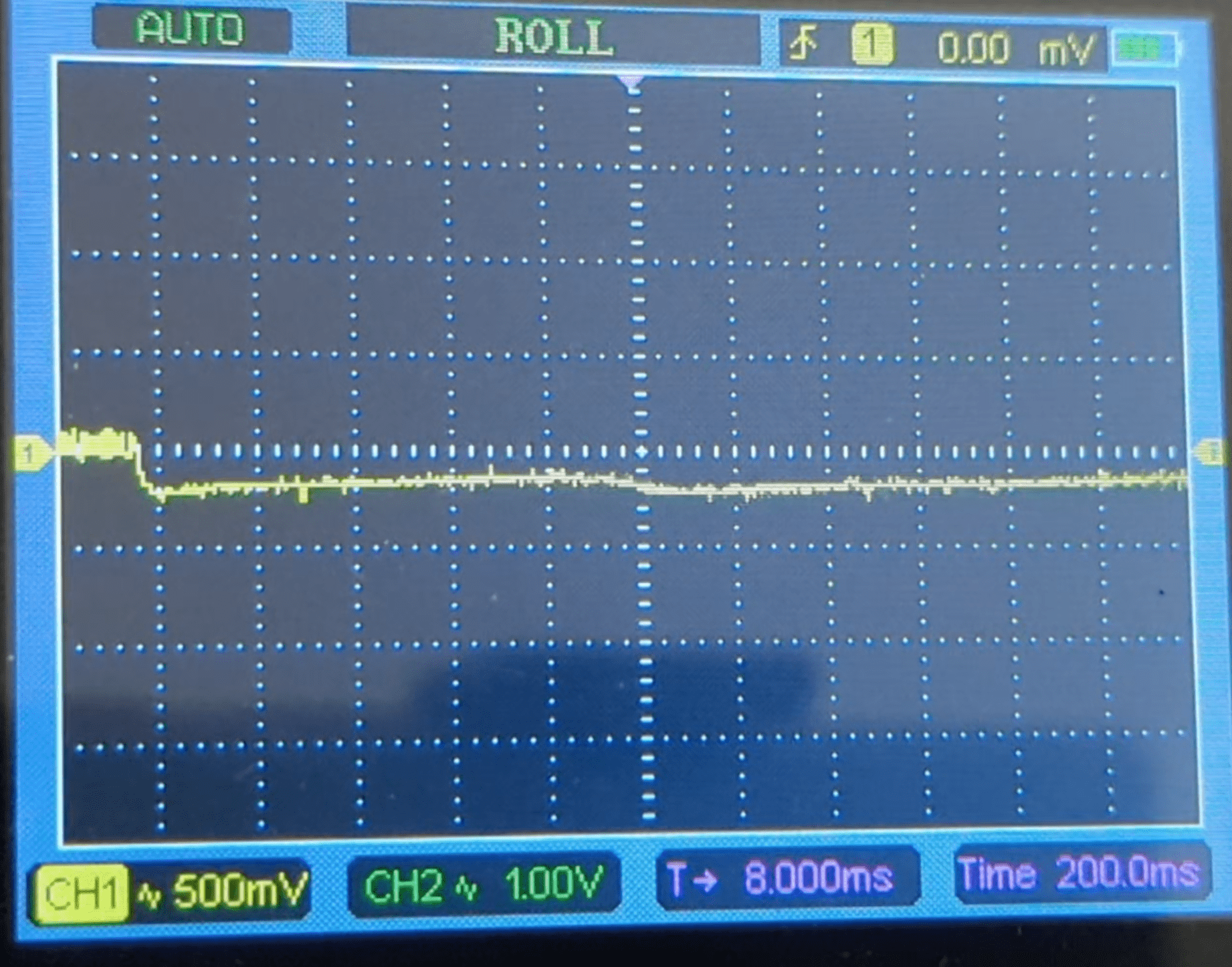

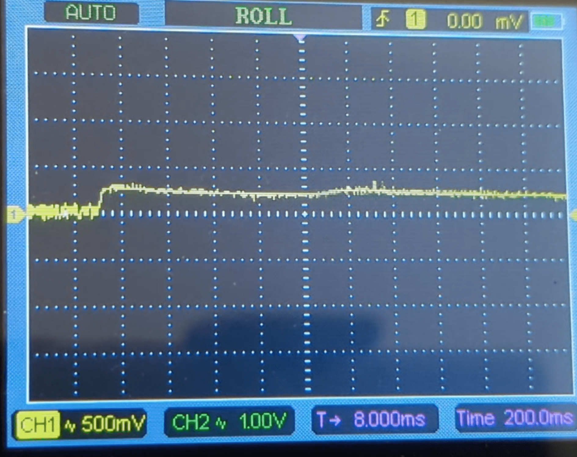

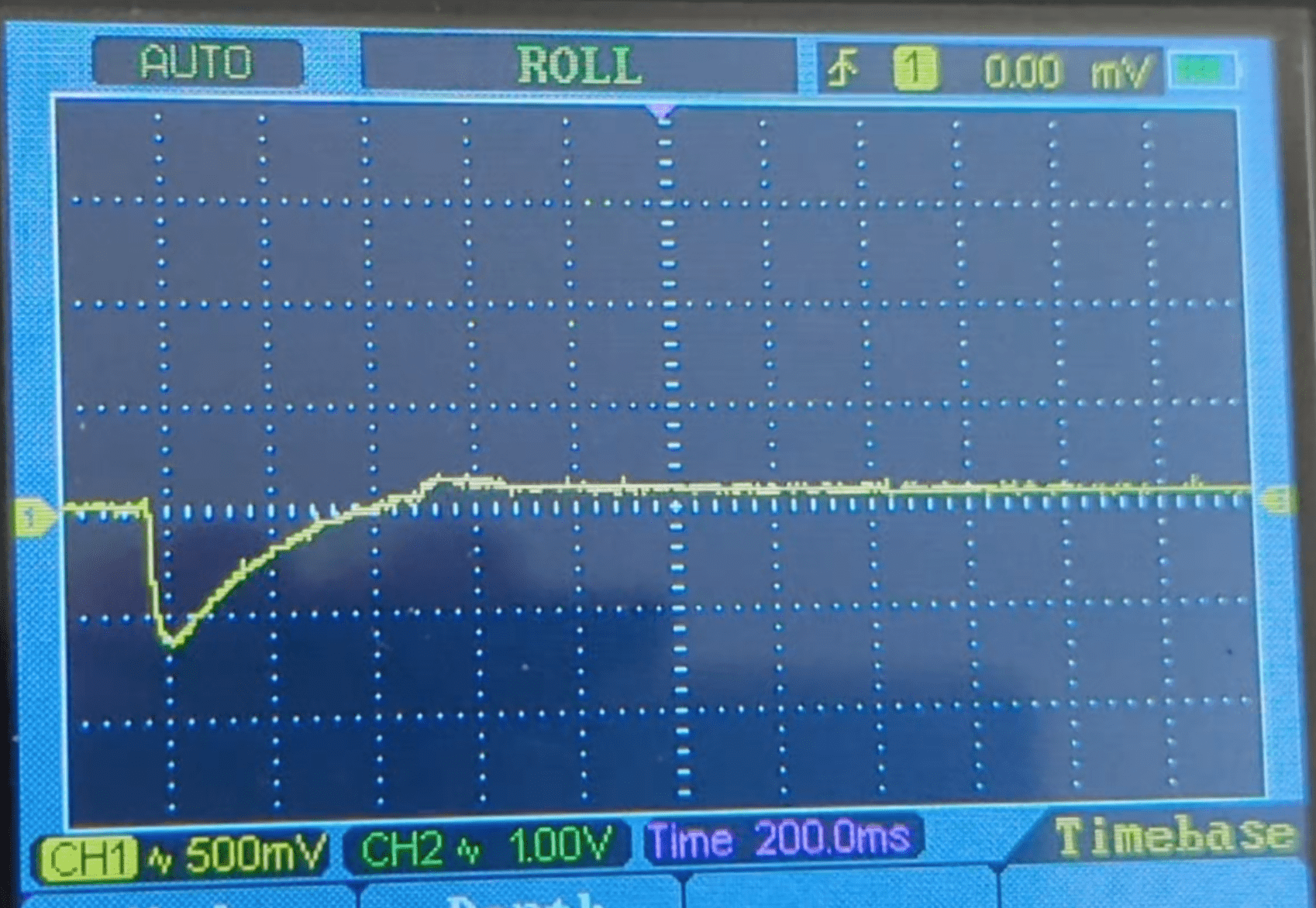

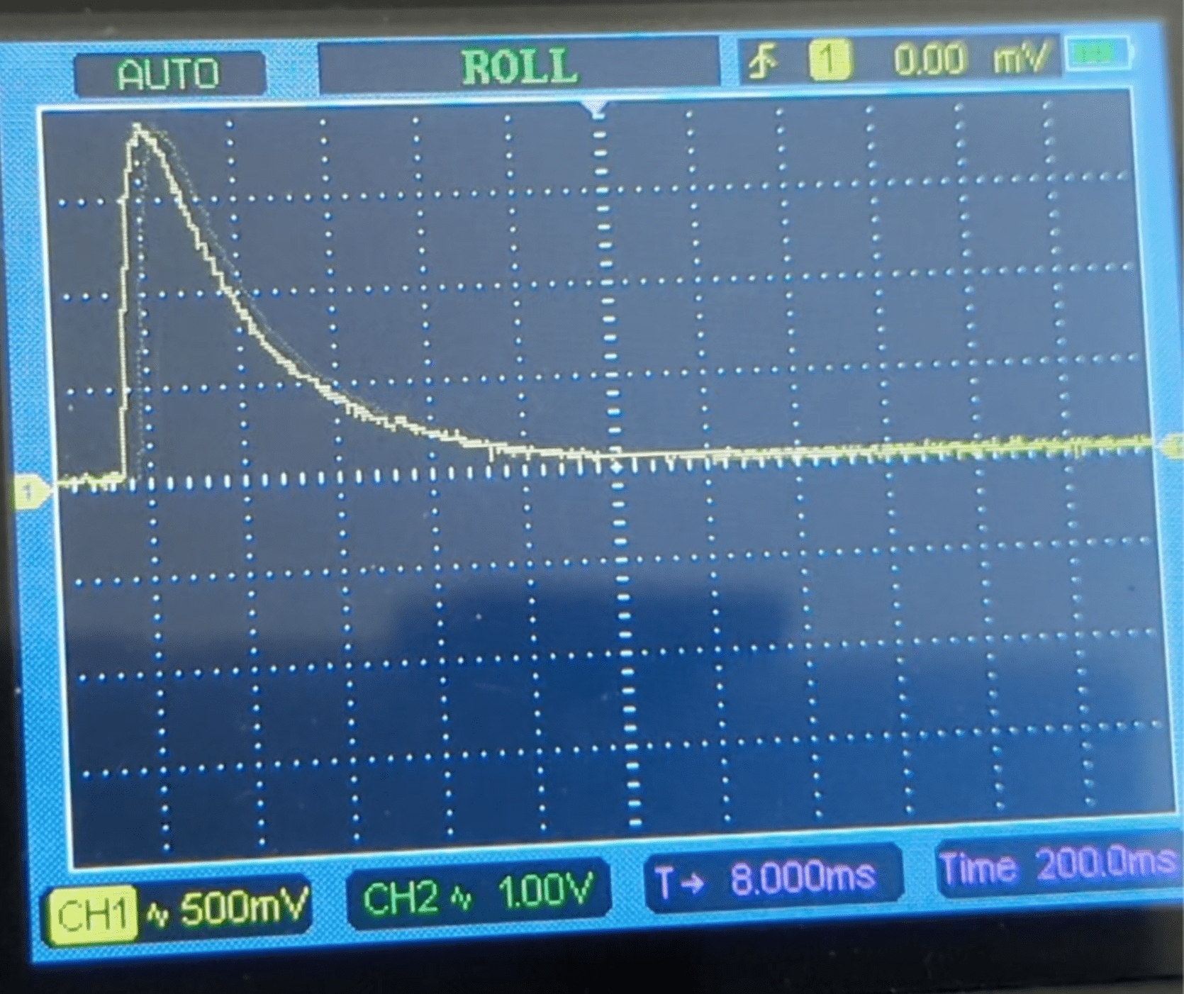

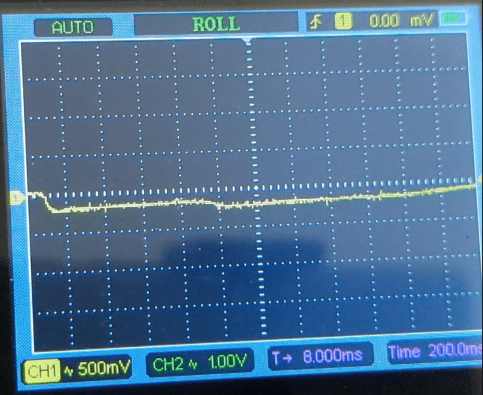

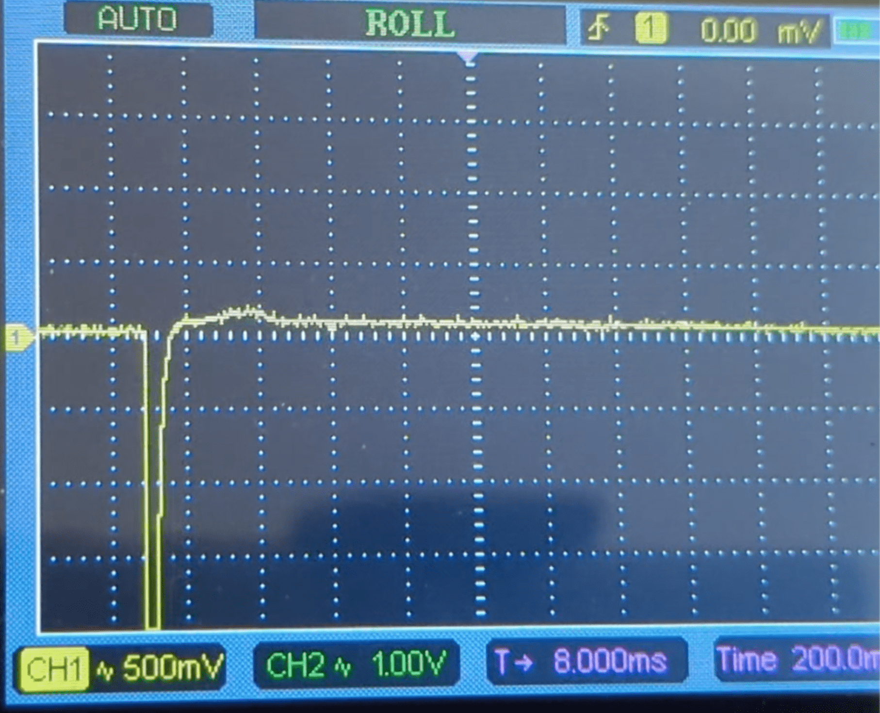

If you can get your scope to record the startup phase then there are 3 places to investigate:
a) the output voltage (terminal 16 on schematics);
b) regulated voltage rails (R76 and R37 on the posted schematics, the ends "off from the regulating transistor");
c) bias voltages on driver transistor bases.
Once you get these recorded in both success and failure scenarios then some guesses can be made for proceeding.
Okay, here goes; I think I got the correct things!
a) J16 was consistently 0V relative to ground. I measured J12 instead because it was active:
Left: good power-on from standby
Right: entering standby from that good power-on:
And J12 when protection is triggered coming out of standby. The unit always takes ~2 seconds to come out of standby, and the protection circuit usually triggers immediately when those ~2 seconds are over. The circuit triggers just after the up/down spike here:

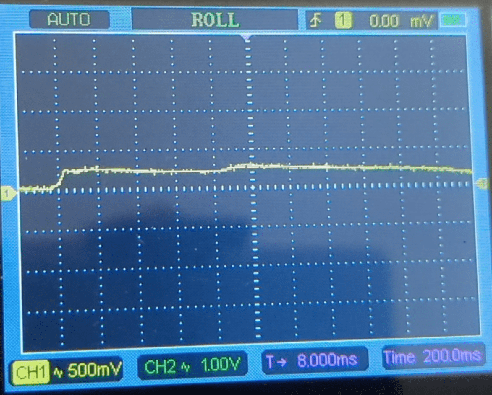

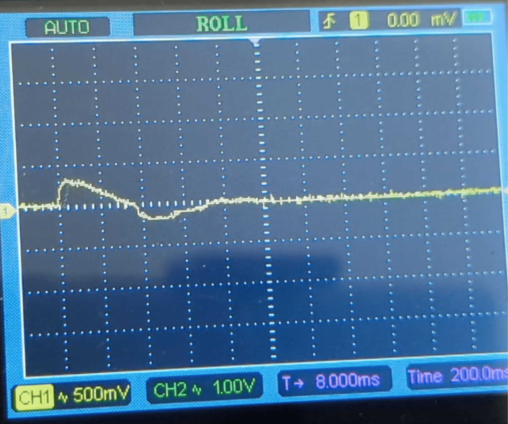

R37:
Right: entering standby from that good power-on (the long-tail on the right dips to meet 0V after another 1-2 seconds)
R37 when the protection is triggered coming out of standby:
R76 good power-on, good standby:
R76 bad:

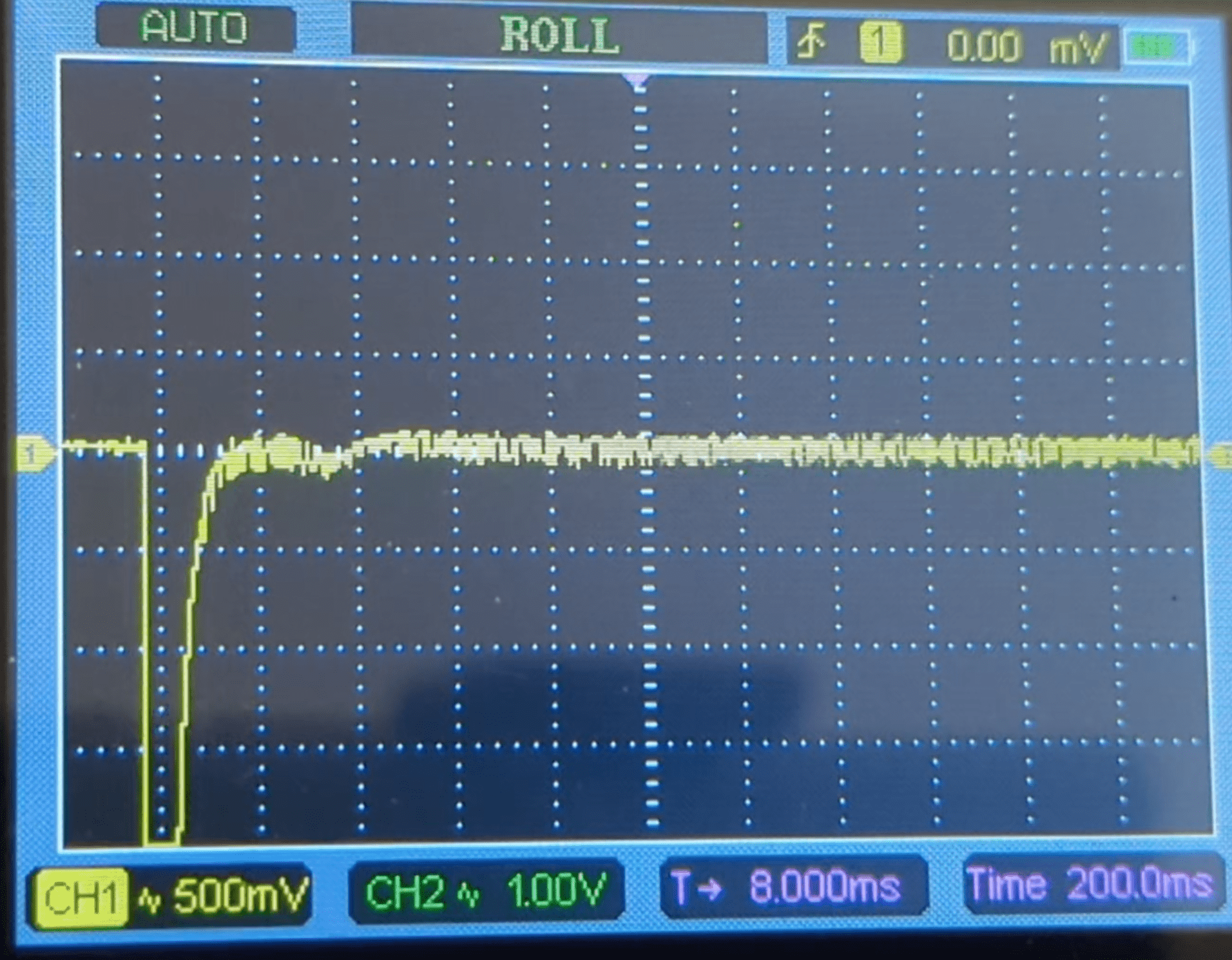

Little bit of inference here on my part, but I assume you mean the 'middle' pin on the schematic and it was easiest for me to measure from R61 and R73).
R61: Good power-on, good standby:
R61 bad:
R73, good power-on, good standby:
R73, bad:
