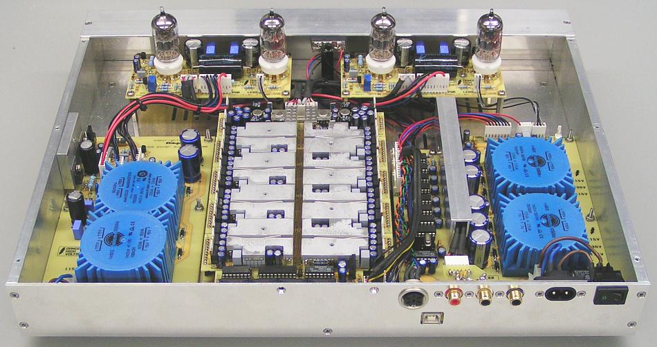

Final DI 8 PCBs tested
Hi all,
Project update,
Yesterday I finally received the DI8 power supply and DI8 timing module PCBs. So I couldn't wait and assembled them for testing. Both work fine.
This means that all 10 different DI DAC PCBs function, and all components fit. Not bad regarding that some of them were redesigned / optimized without testing a prototype PCB.
I added a photograph of the current DI 8M prototype. All prototype PCBs have been replaced with the professional ones now.
The large PCB on the right is the DI8 power supply, the timing module is located in the center at the bottom of the photograph. The large heat sink is temporarily removed.
The small PCB close to the RCA sockets is the output attenuator, I haven't made a professional PCB for this one yet, as it's a simple single-sided PCB. The yellow multilayer capacitors are used to couple ac signals to chassis. The audio signals are routed trough a aluminum cable duct to minimize interference. The third RCA plug (next to the mains connection) is used for remote power ON/OFF. The RCA sockets for L + R channles could be replaced by higher quality types, but this requires modifying the rear panel.
All voltage regulators of both DA1541A and IVDIF modules are now matched to 10mV. I used a test setup with a socket for the voltage regulator to be tested, I also connected a 1 KOhm load. Next I Tested 100pcs of each type, and wrote the measured voltage on the back. Finally I picked out those regulators that matched most closely. The DI8 main board assembly is different from the original schematics now. I changed the DEM clock circuit in order to lower phase noise. I now use a resistive divider. The ring core transformer is no longer necessary. The removed parts are replaced by wire bridges.
The I/V resistors for the OP-amp I/V stage were replaced by a resistor combined of 8 4.7 KOhm low noise / low inductance SMD resistors in parallel. I was also able to use LM4562 TO-99 for both I/V stage and diff amp, because the IVDIF modules are now modified to accept a DUAL OP-amp, as the prototype was designed for the single OPA627 in the diff amp. So I had to use a adapter socket and a LM4562 SO8 version then.
I used a low jitter custom oscillator module on the USB/DI2S module (next to the DI8 power supply). It's the small black PCB with the crystal on top. Another improvement on the USB/DI2S module was replacing the 74F163 with a 74HC(T)161, this lowers the crystal oscillator load. The binary counter is used to provide a 12MHz clock for the PCM2706, it's not critical.
I used silvered mica bypass capacitors for the Intertechnik coupling caps in the TUBEDIF modules. The ECC83S was replaced by a ECC83S balanced version (factory selected for low noise, best sound quality and matched triode specifications). This enhances the operation of the differential tube input stage. I switched back to the ECC82 for the cathode follower, because it has a lower output impedance, and the allowed voltage between filament and cathode is higher (cathode is at 90V potential).
I also made RCA interlinks, using stranded (litze) wire, similar to the sonic resonator interlinks. These have very low inductance and low capacitance (only approx. 10pF at 60cm). By significantly reducing the capacitive load, phase shifts (using a passive resistive volume control) are minimized. The audio interlinks inside the DI 8M carry high amplitude signals, driven by a low impedance, so they are less critical.
