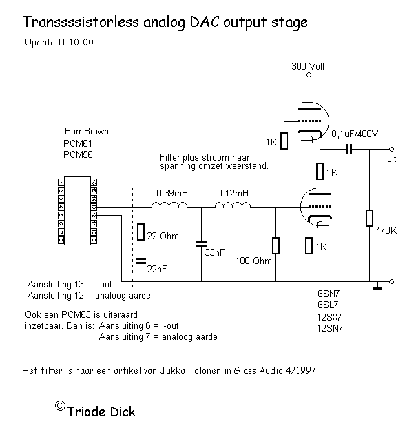

-ecdesigns- said:
Resistor ladder DAC chips like the PCM56 use a voltage reference source that feeds a resistor ladder network. The output impedance of the ladder network is not constant, and varies with the bit switch settings. When a passive I/V resistor is connected to it, this will lead to audible bit errors. The PCM56 can only function correctly if it feeds into virtual ground (OP-amp).
I can't agree with that.
With the PCM56, the passive I/V works very good up to > 500 ohms.
I guess the lower the I/V resistor, the lower the distorsion. but lower output voltages has to be amplified more, it's a matter of the right choices. Triodedick advises 100 ohm for I/V res.
(btw i don't know where the zobel is for)

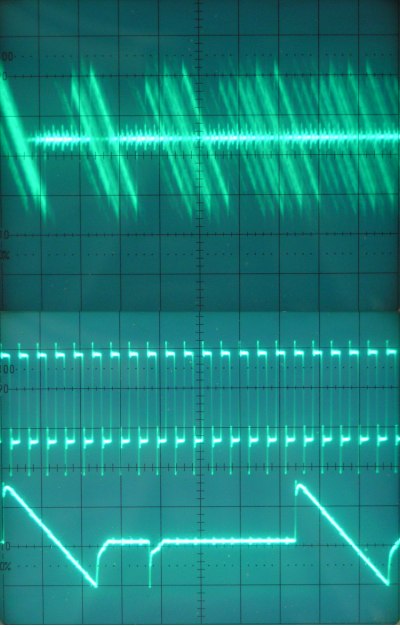

Hi oshifis,
Thanks for your reply [post 1402]
You need to use a synchronous divider like the 74HCT161, if you need a higer division factor, multiple 74HCT161 chips can be cascaded (examples can be found in the datasheet).
Now make a voltage divider by connecting 2 x 100 Ohm resistor in series between 176.4 KHz output and AGND, creating a 2.5Vpp signal. Now connect a 100pF capacitor between the 2.5Vpp tap and pin 16 of the TDA1541A. Use a high quality polypropylene (WIMA) or polystyrene capacitor (LCR components).
Connect a 100nF film bypass capacitor (WIMA or BC components) between pin 17 and AGND.
The upper oscillogram shows the typical "datasheet" DEM clock, needless to say it contains jitter.
The lower oscillogram shows the synchronized low jitter DEM clock. This is how the output signal on pin 16 should look like (you may need to experiment with both signal amplitude (2.5V) and capacitor value (100pF).

With the zobel of the Triodedick scheme i mean the 22R/22N in series after dac output. I assume it's a @44.1Khz tuned extra filter.
