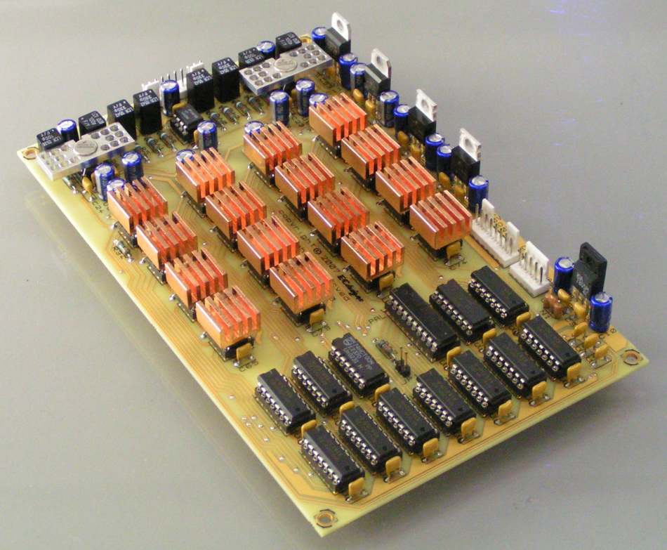

As you may have noticed, I have received the first batch of the professional DI DAC PCBs. I have been assembling and testing all PCB versions in order to make sure everything works flawlessly.
Well actually they do, I put all versions together and they worked straight-away. I haven't received the DI8 power supply and DI8 timing chain yet, so I had to use the prototype PCB's for now.
The assembly of the modules was straight forward, everything fitted flawlessly. It should be quite easy to assemble them. I enjoyed every minute of the assembly process.
I have also completed over 300 colour drawings containing detailed module assembly instructions, voltage checks and wiring diagrams. This should make assembly a piece of cake.
I will now post some photographs, showing the PCB quality. The PCbs have fully gold plated traces (not only the pads), the solder mask is transparent so the gold plating on the traces remains visible. The silkscreen print is in black.
Ok, let's start with the most interesting one for diy, the DI 16 core. The heatsinks used on the TDA1543 chips are standard copper chipset coolers from thermaltake, they are self-adhesive.

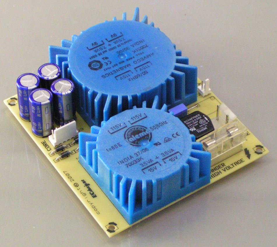

DI 16 power supply pictures
Hi all,
Next picture, the DI16 power supply. Its a single-sided PCB, it can be wired for both 115 and 230Vac. It uses 2 encapsulated ringcore transformers, they have low external magnetic field and very low mechanical hum. The small (7.5VA) powers the I/V diff circuitry, the larger (15VA) is used to drive both TDA1543 chips and logic.
The power supply has a integrated fuse and mains filter. Skottky rectifier diodes (11DQ10) are used for providing low switching noise.

What is the principal advantage over the DI 16 dac as opposed to the di8 DAC as the DI16 looks a lot simpler in terms PCBS per 1543 (3 in total?)and would do a lot more number crunching!
As opposed to the DI 8 DAC which had one DAC PCB for every tda1541(OVER 10+pcbs) and seems a lot more work in the PCB department for less DAC,... so is it a case of " less is more" or have i missed something (its 3AM here, but i am hooked!)

Why does a DI8(M) outperform a DI16(M)?
Hi Johnny555,
Thanks for your reply [post #1353]
The key issue is the difference in distortion (THD) between TDA1541A and TDA1543. TDA1543 has about 10 times higher distortion than the TDA1541A. TDA1541A THD (0dB) 0.0018...0.0032%, TDA1543 THD (0dB) 0.018...0.032%
The TDA1541A distortion noted in the Philips datasheet is with the standard on-chip DEM clock oscillator. Using a external low jitter crystal-controlled clock signal, reduces TDA1541A distortion significantly.
So despite the reduced bit errors (averaging) by placing 16 TDA1543 DAC chips in DI mode, and despite the higher resolution obtained with 16 DAC chips, the produced sound quality can't beat 8 TDA1541A DAC chips in DI mode. Especially when a low jitter DEM clock is used.
Another factor is the mixed mode output, this enhances sound quality significantly. The mixed mode output basically consists of two operational amplifiers running in parallel. One semiconductor OP-amp and one tube OP-amp, the idea is to merge the advantages of both semiconductor and tubes in a single amplifier with new sonic properties. The input signal is divided over these two Op-amps, using a specific ratio. A semiconductor-only or tube-only amplifier can't produce the sonic properties of a mixed mode stage.
I tested the DI 16M (DI 16 + mixed mode output) this weekend, it works fine, the sound is much more transparent and natural now.
The higher complexity of the DI 8(M) is certainly not "more work for less DAC" as you put it. Comparing the DI16(M) with the DI 8(M) would make this very clear.
