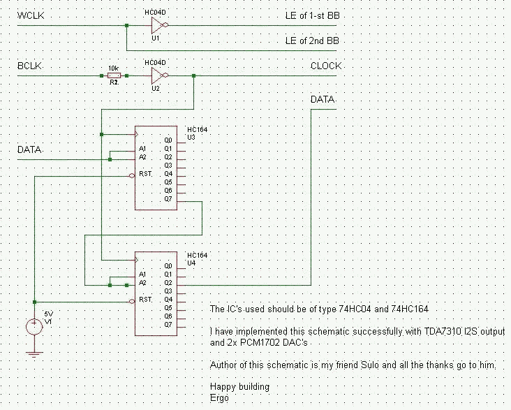

D-I 16 schematic
Hello
maybe I missed something in this long thread - but I could not find the schematic of the D-I 16 analog part. See post #1111.
How are the 16 TDA1543 used ? 2,4 or 8 times analog interpolating. 2 or more in parallel ..? Output stage with OPA627 - even differential used ?
Anyhow I build a DDDAC which uses 12 TDA1543 in parallel with a simple resistor as I/V stage. The sound is good but the high freq. are too hard for my taste - and I have the strong feeling that filtering is necessary but the approach here is more elegant.
thanks

did you use the standard output capacitors ? try chaning them, that might improve the high freq.....
DI 16
Hi gebi,
Thanks for the compliments [post #1254]
I will post the final DI 16 schematics and silkscreen plot soon.
The DI 16, provides 16X interpolation, there are 2 groups of 8 X TDA1543 DAC chips with the outputs in parallel. There are two I/V converters (LM4562)/ channel R=470 Ohm, C=100pF.
One group is inverted, the other is non-inverted. This enables the use of a differential output stage (LM4562) that's DC coupled (no coupling capacitor necessary). Each individual TDA1543 reference pin is connected to the corresponding I/V OP-amp non-inverting input trough a 4K7 resistor), the non-inverting inputs of the I/V OP-amps are decoupled to analog ground. The TDA1543 25mV ac output compliance is met, ensuring low linearity errors.
I use LM4562 exclusively now, it makes the OPA627 sound muddy in comparison. Due to the fact that the DI system already provides a wonderful warm midrange, it matches the slightly "thinner" sound of the LM4562 perfectly, resulting in a very well balanced sound.
NOS DAC's provide some problems with higher frequencies due to the low resolution among other things (you are basically listening to square wave-like signals at higher frequencies). But also the lower frequencies suffer from lack of resolution. Just an example with sine waves:
500 Hz NOS DAC: 88 samples, DI8: 706 samples, DI 16: 1411 samples

Right at this moment i am trying to connect I2S to two pcm56 dacs.
Want to try and hear this and find out if harmonic distorsion can be lowered (MSB adjust) compared to 1541.
I2S is from SAA7210, clock provided by a P2P version Kwak 7.
Found logic here on diyaudio. I/V is Pedja's AD844 stage.
The problem is i have digital noise and music, have to check glue logic.
Or clock in must be not 2.8mHz (11.28 / 4)
I don't understand why data has to be shifted 11 clockcycles.
