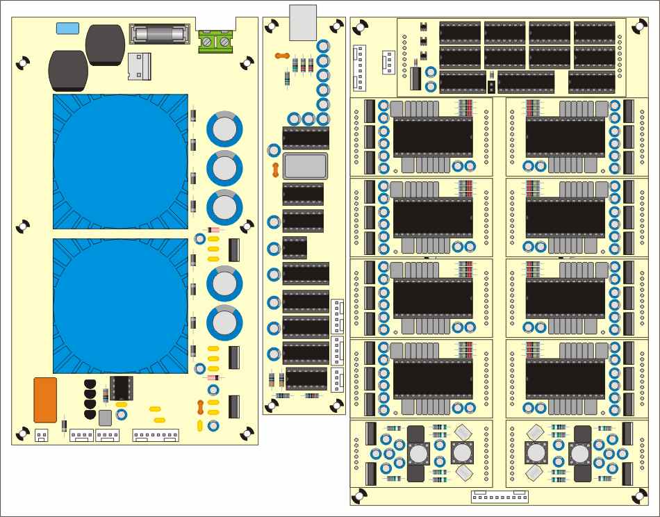

DI8 configuration
DI8
The attached drawing illustrates the DI8 configuration. On the top left is the DI8 main power supply, it can be wired for both 115 and 230V. It drives logic circuitry and the DI8 core. Remote power on/off function can be added if desired.
Next is the USB/DI2S interface, it provides both USB and differential I2S inputs. The USB circuitry includes a shiftregister reclocker, the DI2S goes straight to the DAC chips. The module automatically toggles between USB and DI2S, USB has highest priority. There are outputs provided to drive a two color indication LED.
At the top right is the DI8 core, it consists of the DI8 mainboard, and a number of modules mounted on top of it. The DI8 mainboard holds all interconnections, filters for each power supply connection, DEM clock filter / attennuator and DEM clock coupling caps. The following modules are mounted on top of the DI8 mainboard: DI8 timing module, 8 x DAC module and 2 X I/V diff amplifier module.

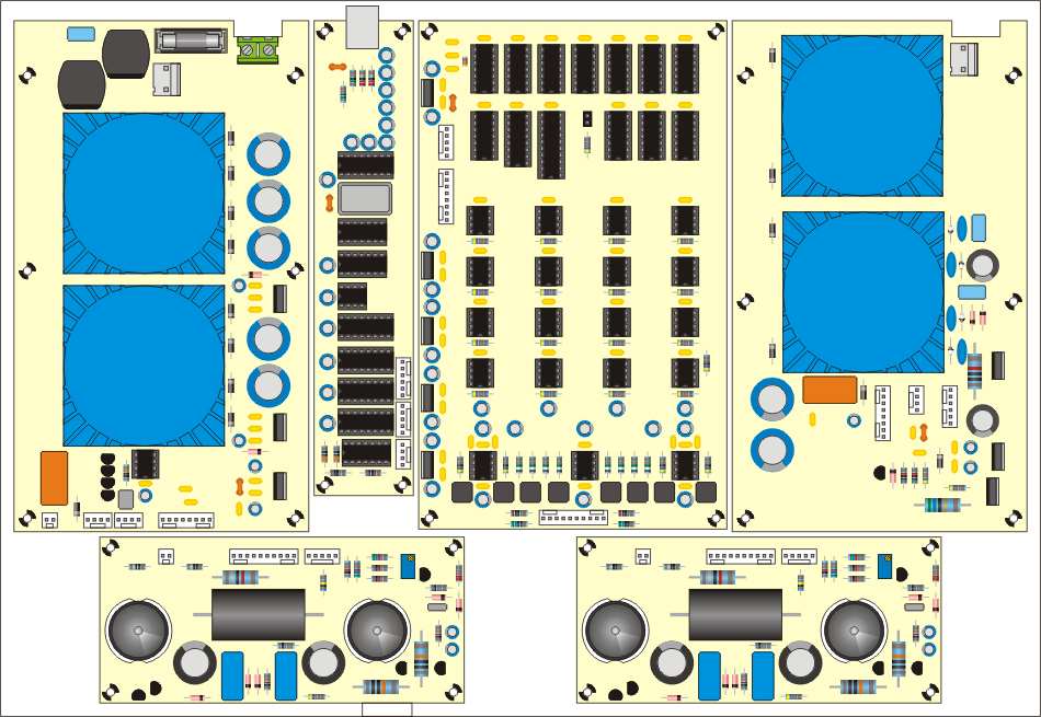

DI16 configuration
DI16
The attached drawing illustrates the DI16 configuration. At the top left is the DI16 main power supply, it can be wired for both 115 and 230V. It drives logic circuitry and the DI16 core. Remote power on/off function can be added if desired.
At the top right is the USB/DI2S interface, it provides both USB and differential I2S inputs. The USB circuitry includes a shiftregister reclocker, the DI2S goes straight to the DAC chips. The module automatically toggles between USB and DI2S, USB has highest priority. There are outputs provided to drive a two color indication LED.
At the bottom is the DI16 core, it contains 16 X TDA1543, DI16 timing and I/V diff amp.

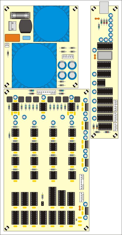

DI16M configuration
DI16M
The attached drawing illustrates the DI16M configuration. On the top left is the DI8 main power supply, it can be wired for both 115 and 230V. It drives logic circuitry and the DI16 core. Remote power on/off function can be added if desired.
In the center is the DI16 core, it contains 16 X TDA1543, DI16 timing and I/V diff amp.
On the top right is the tube power supply, it can be wired for both 115 and 230V. It drives both tube diff amp modules (filament voltage + high voltage). It has a integrated soft start circuitry for the filaments and a delayed power-on for the high voltage.
At the bottom are the two tube diff amp modules, necessary for the "mixed" mode. They consist of a differential amplifier (ECC83S balanced) and a cathode follower (ECC81).

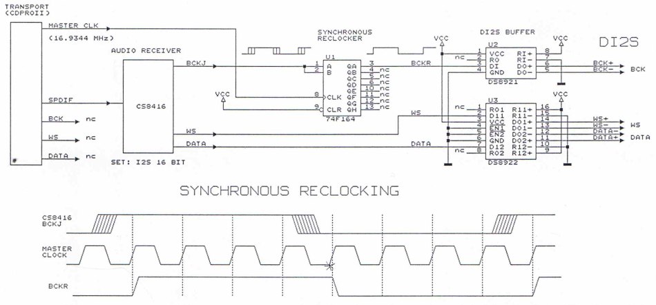

DI2S interface schematics
Hi maxlorenz,
Thanks for your reply [post #1285]
Here is a diagram of a simple interface circuit that enables connecting digital sound sources to the DI DACs. I am using the same circuit, but with a CS8412 to connect my Sony CD changer to the DI 8 and DI 16. It provides a lower jitter bit clock than the I2S bit clock derived directly from the LSI chip.
This circuit is part of the universal I2S interface, the interface also has a by-passable shiftregister reclocker. This reclocker can be used with digital sound sources that haven't got a master clock output available.

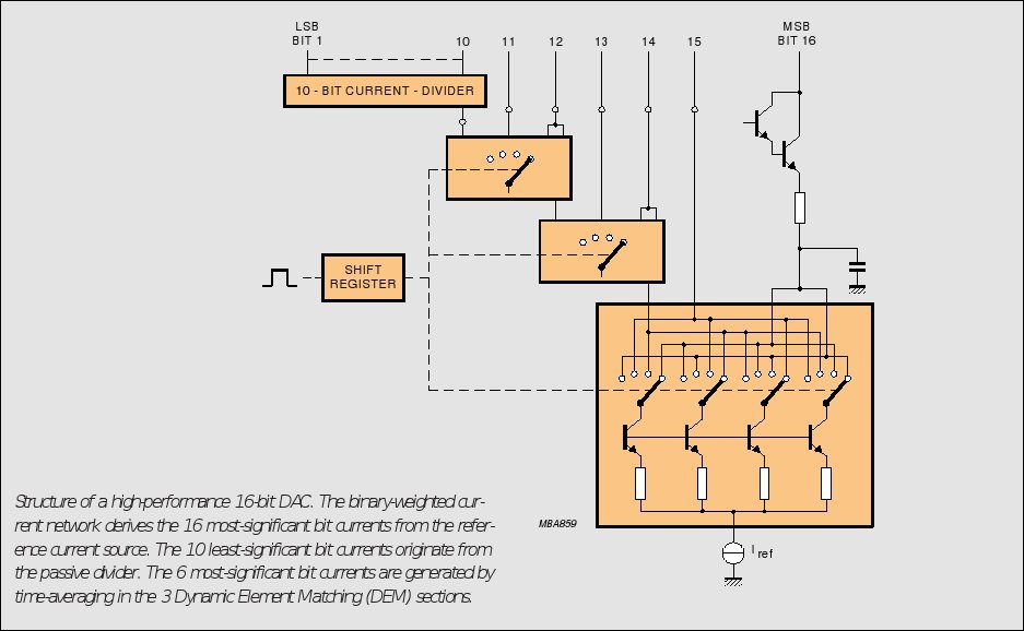

Grounding issues / TDA1541A internal circuitry
Hi Guido,
Thanks for your tip [post #1292]
I agree, it would be nice to have some more detailed information about the TDA1541A internal circuitry to optimize decoupling / grounding. It know it's common practice to connect analog and digital ground close to the DAC, but I use 8 or 16 DACs. When I connect analog and digital ground together, close at each DAC chip, it basically means the analog ground plane is also used as return path for the digital signals (I2S, clock), and it will interfere with the analog signal return path.
I do have a large ground plane on the analog mainboard (where all modules are connected to). This is my analog reference ground. It has very low resistance and a mesh pattern. Electro Magnetic interference caused by currents running trough it, is kept away from the modules by the relatively large distance between ground plane and modules. With a multilayer board for instance, the EMI is directly injected to the components located very close to it.
The DI DACs are fully symmetrical, even the PCB lay-out. so common noise, picked-up by whatever source is effectively canceled at the differential output stage. Did I mention the differential stage test where I put a 2V! pp hum on the TDA1543 power supply (DI 16), 4 V DC plus 2Vpp hum! Well the DI 16 performed like there was nothing wrong with it.
All supply voltages have filters to prevent long loops for HF signals. In critical digital circuits like the clock and driver, every single chip is separately isolated from the power supply (series resistor) to keep HF path as short as possible.
All (local) voltage regulators are placed close to the DAC / OP-amp ground reference, so the supply voltage for these components won't pick up much interference, as would be the case if the voltage regulators were placed on the power supply board.
I have studied the TDA1541A internal architecture, basically it has one reference current source (4mA), tied to -15V. All 16, binary weighted currents are derived from this single reference current source. The bit switches compose the output current from these 16 binary weighted currents. Three 2-bit active dividers (DEM circuitry) split-up the currents of the reference source into 4 equal currents by means of resistors. DEM circuitry is used to average between these four divided currents, matching them as closely as possible. Same is done in the other two active dividers, they are connected to one of the previous active divider outputs. The DEM clock drives the four averaging switches in each active divider. They basically keep swapping between 4 current outputs with a specific pattern: 2,3,1,4 > 1,2,4,3 > 4,1,3,2 > 3,4,2,1 The 2 X 7 decoupling caps are connected between ground and the active divider outputs. If drift occurs, it will affect all output currents in the same way as they are derived from the same reference current source. Due to the DI 8 balanced design, even this is being compensated. If the active divider resistors age / drift, this will be compensated by the DEM circuitry. MSB tuning makes little sense here because the DEM circuitry automatically matches / averages the divided currents with a rate of approx. 150...250 KHz.
By synchronizing the DEM clock with BCK, the exact moment of driving the DEM switches coincides with BCK, preventing inter-modulation that occurs with a free running DEM clock. The DI 8 uses exactly 4 DEM cycles within one sample time (2822400 / 16 = 176.4 KHz, 176.4 / 44100 = 4).
The 10 LSBs are derived from a passive divider (emitter scaling), connected to one output of the third active divider. The output of the TDA1541A is a current sink to -15V. Due to the lack of more detailed information, I assume that both +5V and -5V are used to feed the digital circuits and level shifters. I have added a block diagram of the TDA1541A internal circuitry for reference.
I choose the Audio grade coupling caps because they cost about the same as standard caps, but have better (audio) specifications. I didn't use tantalium caps anymore because they are quite expensive (especially the higher values). The local voltage regulators effectively prevent crosstalk between chips as their power supplies are now isolated. They also protect every single module in case of a voltage surge or power supply malfunction. Since the TDA1541A output current accuracy is determined by a constant current source, tolerances in the local voltage regulators of each DAC module should have little or no effect.
Re: Grounding issues / TDA1541A internal circuitry
The info on the internals 1541 is here on diyaudio, there's a search button.
current ref source is from -15 to -5.
i would also sync DEM with BCK, but NOT when BCK changes state (which latches the outputs)
offset current -2mA goes to -15 indeed, but analog audio current goes to +5. Now imagine how it flows through from i/v through coupling caps and series regs (if used).
+5 and -5 are indeed for digital stuff.
